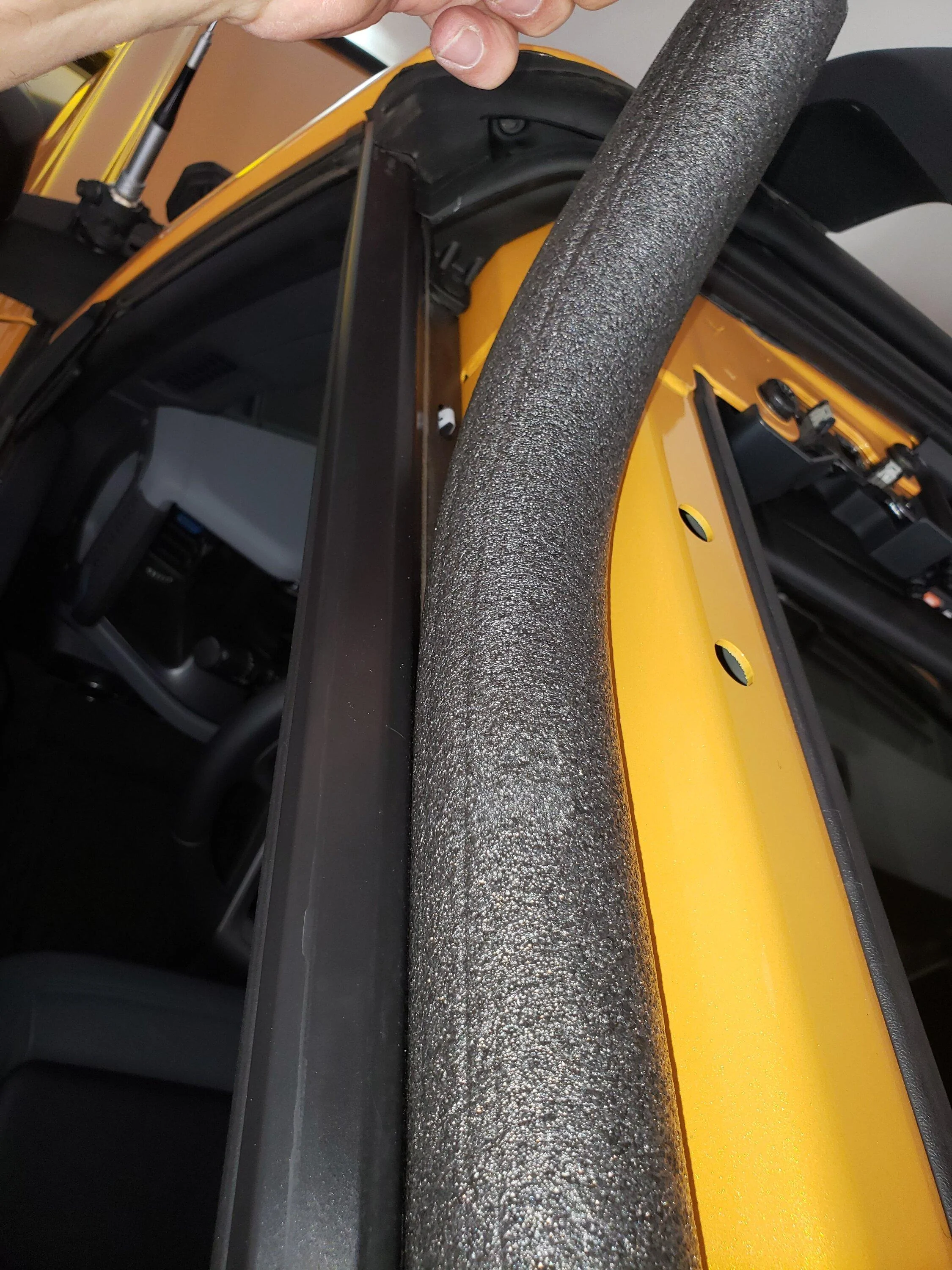

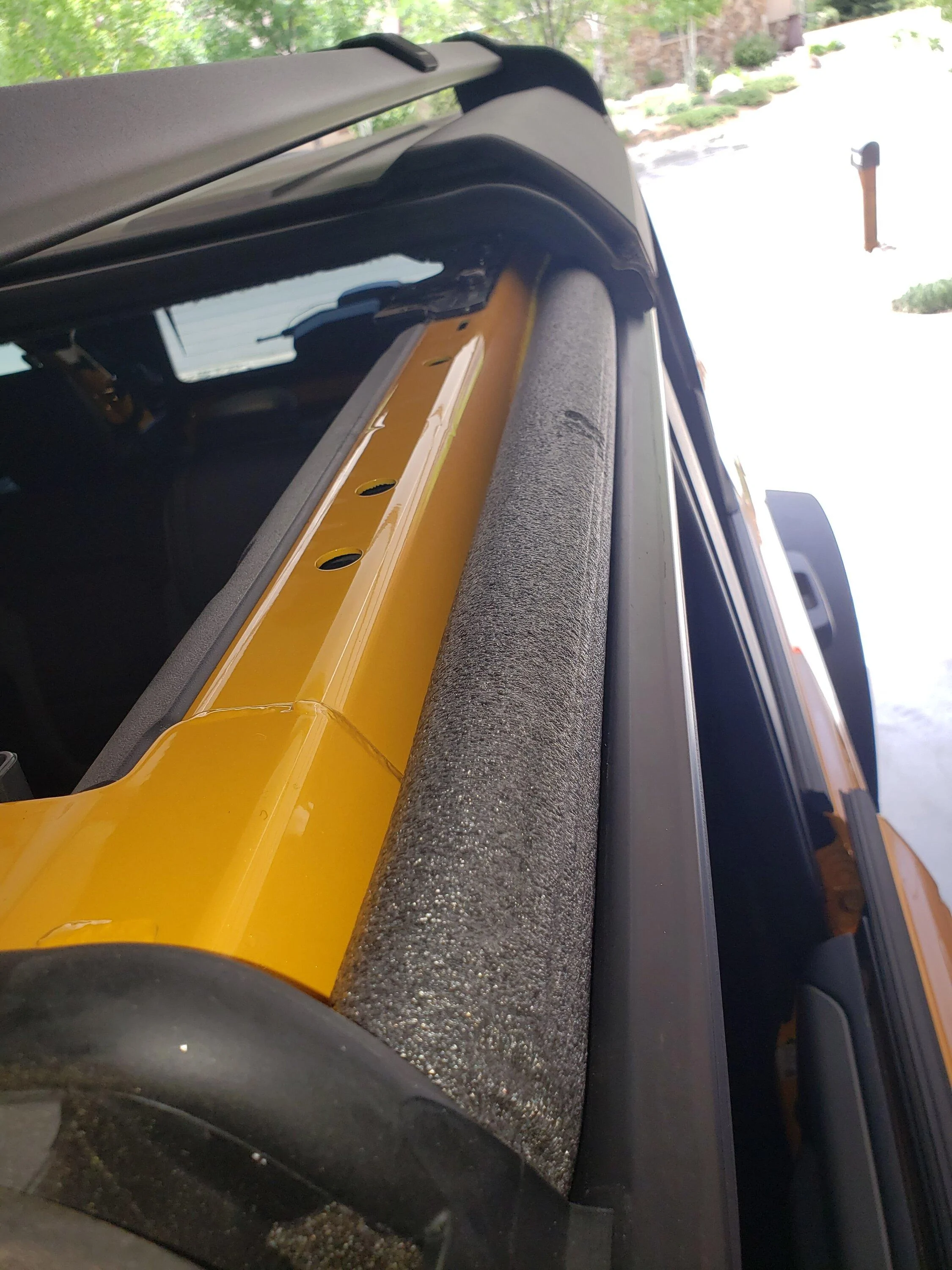

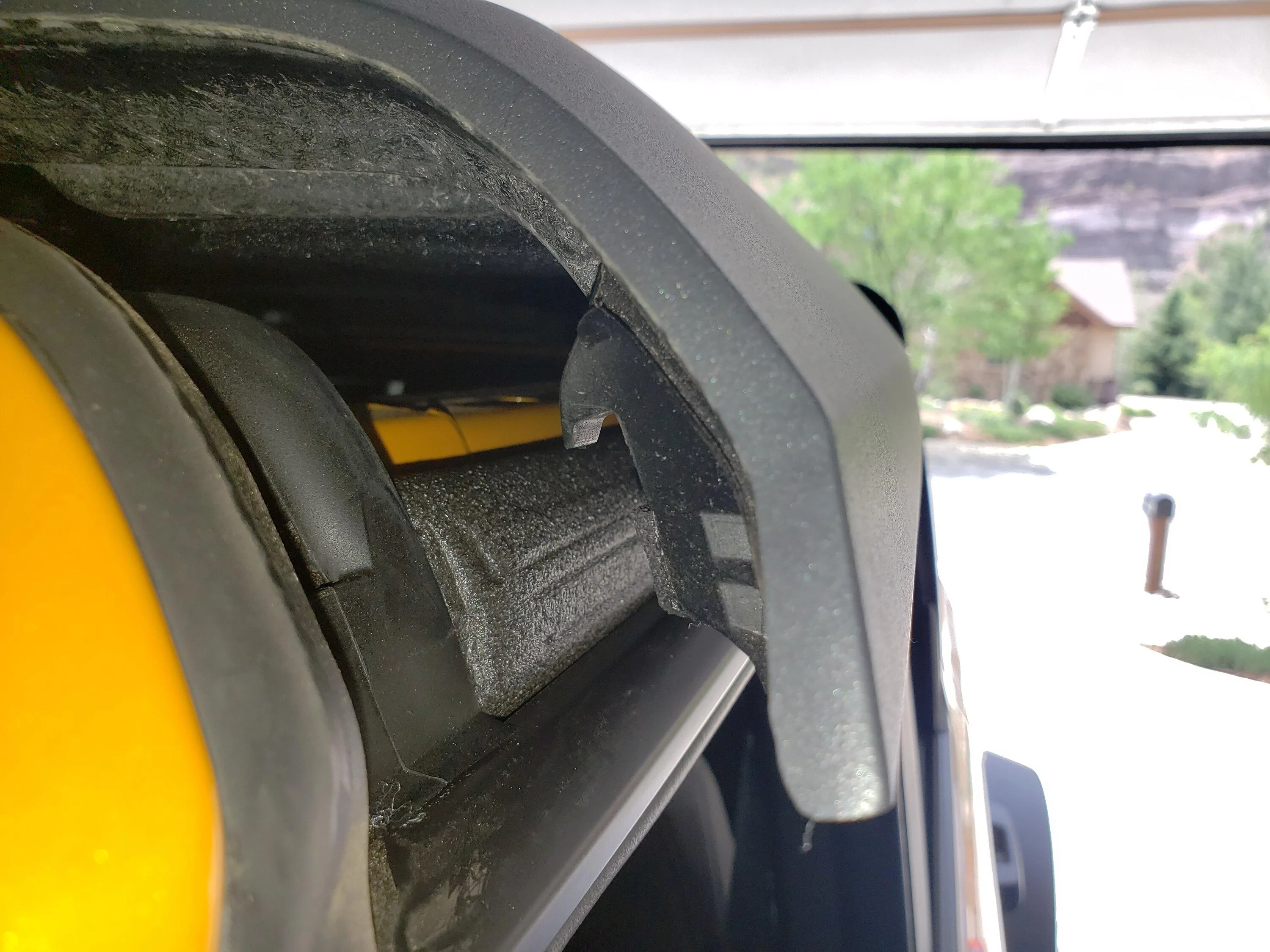

Well, they say a pic is worth a thousand words, and with all your asking, here you go. And, no zip ties or tape. 3/4 inch (inside of snake) fits like a glove and the roof panel holds it in place.
I expect a compliment for my clear pics!
Lifted with my finger so you can see how it lays...

Does this cause any issues with drainage? ie: blocking gutters
Fordā€™s fix for the water leaks along the windshield header was to silicone the crap out of it.

I dont think so, look at the roof panel profile, this is underneath the side fold. If you find any moisture in that channel, you likely have a leaking roof at the rubber seals between panels. If anything, the snake will inhibit sideways precip from entering where that corse foam vent is!

Do you also snake it around the front of the vehicle?
Like above the aux switches? Thatā€™s where I seem to get most of my wind noise.
