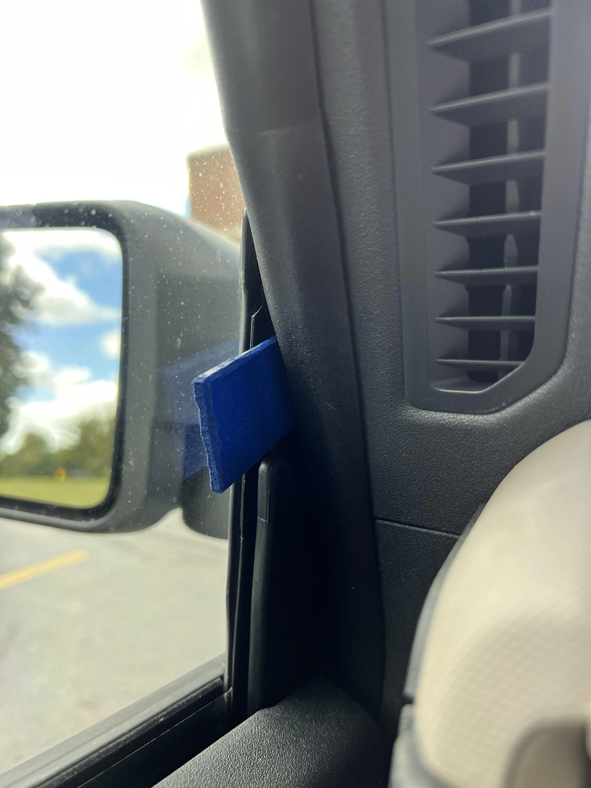

I tried the foam thing and it helped a little but not much on mine… this stupid wooden shim I shoved in the window eliminates about 75% or more of the wind noise though. 🤦🏼‍♀️🤯
Check and make sure that triangle shaped seal isn’t warped and wavy like mine. My dealer said it would be under warranty I just don’t want them to touch my windshield recall yet so I’m going to wait a little bit.

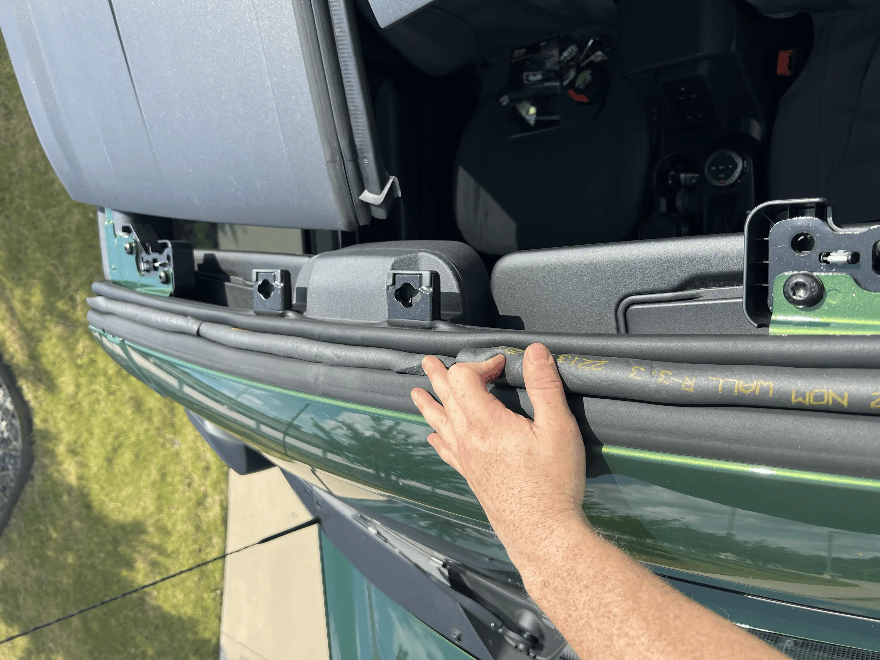

So, I took the OP's original idea, and went to Home Depot....but instead of foam, I paid $6 for 3/4" RUBBER, since rubber is better than foam as a sound barrier (6 foot)....
BUT, for ME, the main noise has always bothered me from the FRONT of the bronco...
So, after putting in the insulation on the sides just as the OP, I had about 2 pieces left-over of about 2-2.5 feet each...
now the FRONT empty channel is smaller than the sides so you need to CUT in HALF the remaining pieces, and you have enough for the front....
See the pics.
I can't say for sure how much the noise from the sides was reduced, but BY GOD the front noise is reduced by 70-75% for me....
I won't drive now without it when the top is on.
Ford Bronco Attention MIC Hard Top Owners - Wind Noise Reduction Hack C0D379E1-AA02-4C3E-A0BB-81A7DB232912
I'm going the EPDM rubber route like you. 7/8 internal diameter, which is about .10" larger OD for a little more compression to make a better seal. Great idea for the front. It just turned cold here in WI yesterday and the whistling noise on my way to and from work was horrendous. I had some 1 1/4 x 7/16 frost king self adhesive weather stripping laying around from an old project. That reduced the whistling noise by 90%. So the rubber pipe insulation along with the EPDM .5" x .5" I ordered on Amazon last night should do the trick. I'll report back on the 7/8" if it doesn't work as intended.
