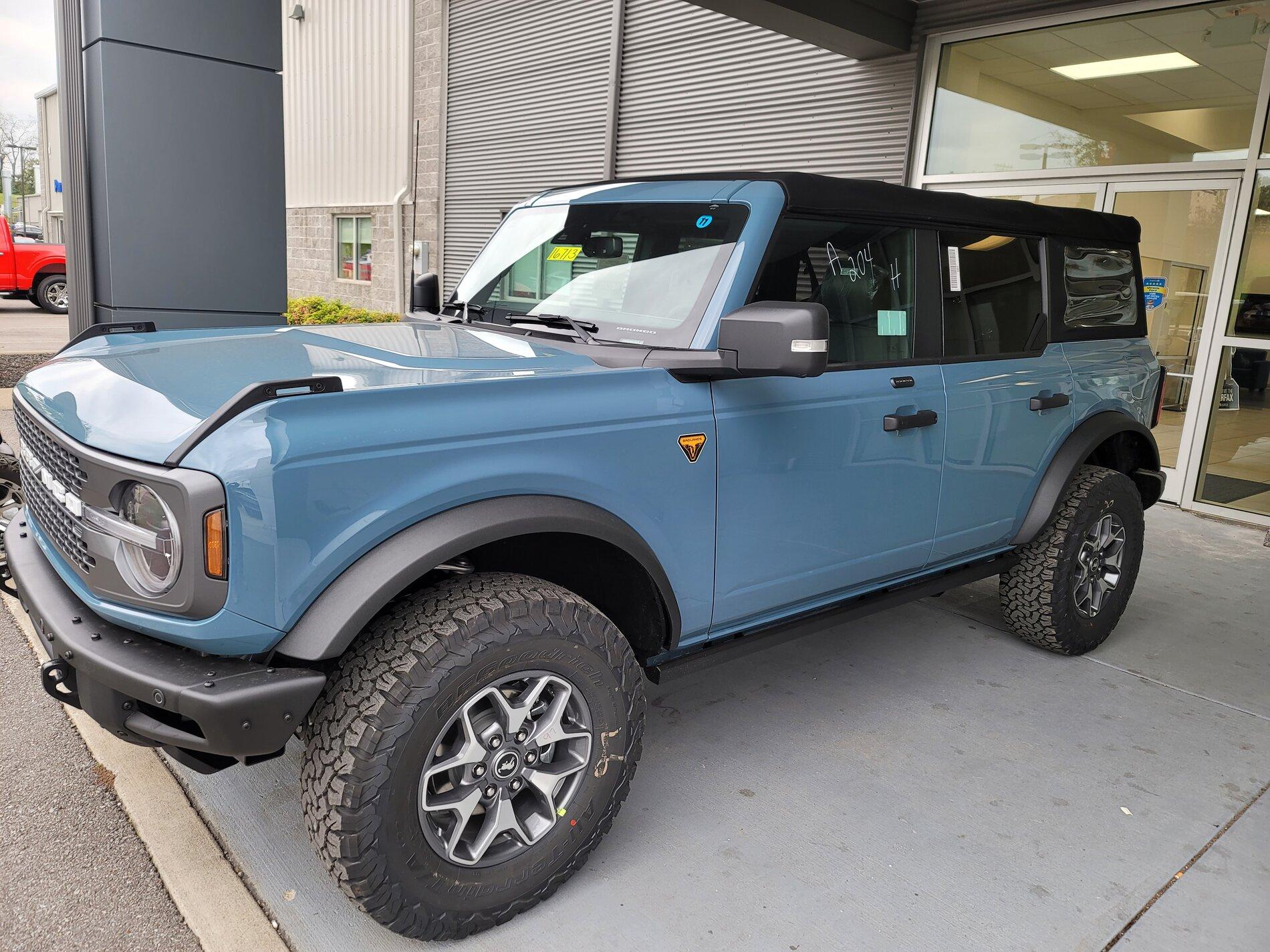

I got an automatic update from Ford last night i think. I noticed my Sirius radio looked different but also my automatic parking brake release stopped working. Surely they didn't disable this function. I have the manual transmission and that automatic brake release was a great feature. Anytime you start up, and put it in 1st or Reverse, it releases the brake without having to reach for it.
I don't know if i have changed a setting or exactly what has happened. Any ideas?

Thats certainly really odd. I really cant imagine an update doing that, but ya know. Anything possible. Was it connected to WiFi when this happened? #teamlethal

Did you try pulling ahead and seeing if it released then? This is how most work.... And maybe how it was s'pose to work initially. Just putting it in gear and having it release the brake wouldn't always be ideal.

I dont know when it grabbed the update or how it connected, but it had that icon at the top of the screen showing there had been a download. I think it was an arrow pointing down into a tray? The radio had that change too on the layout of the sirius radio screen, so something changed for sure.

I did not push it to the point that the engine stalled, but it will not move at all. I know some people might need to use a brake on a steep hill start so i was afraid Ford might have deleted it. I cant find anything in the owners manual about it.

Well i think i figured out the issue. I had to revert to reading the instructions, which was painful.
If you start to let off the clutch before you start to give it gas, the brake does not unlock.
It requires the drivers door to be closed, and the gas pedal to be pressed for auto-unlock. Great feature, just new to me.
