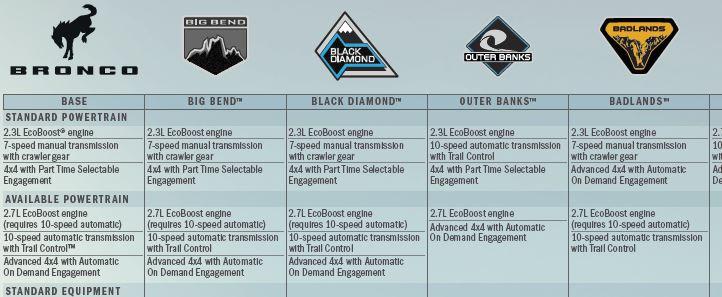

I know about it. The lower lorange is the only reason I want it. Course it's std on badlands and thats the trim I want anyhoo!
Is it standard on BL? I know it is for the WT.
That’s also the main reason I want it.
I believe so. It was one of the items needed to get the 95/1 crawl ratio.

Looks to be included in BL to me.
Just by the way, that original flyer had mistakes in it. You have to check out the website to be more accurate. the website contradicts itself in a few different places though.
That's to be expected this far out. Most folks don't really appeciate how much work Ford has left to get ready for launch at this point in time, and how much can change. So there are typo mistakes, but also changes because things changed...
