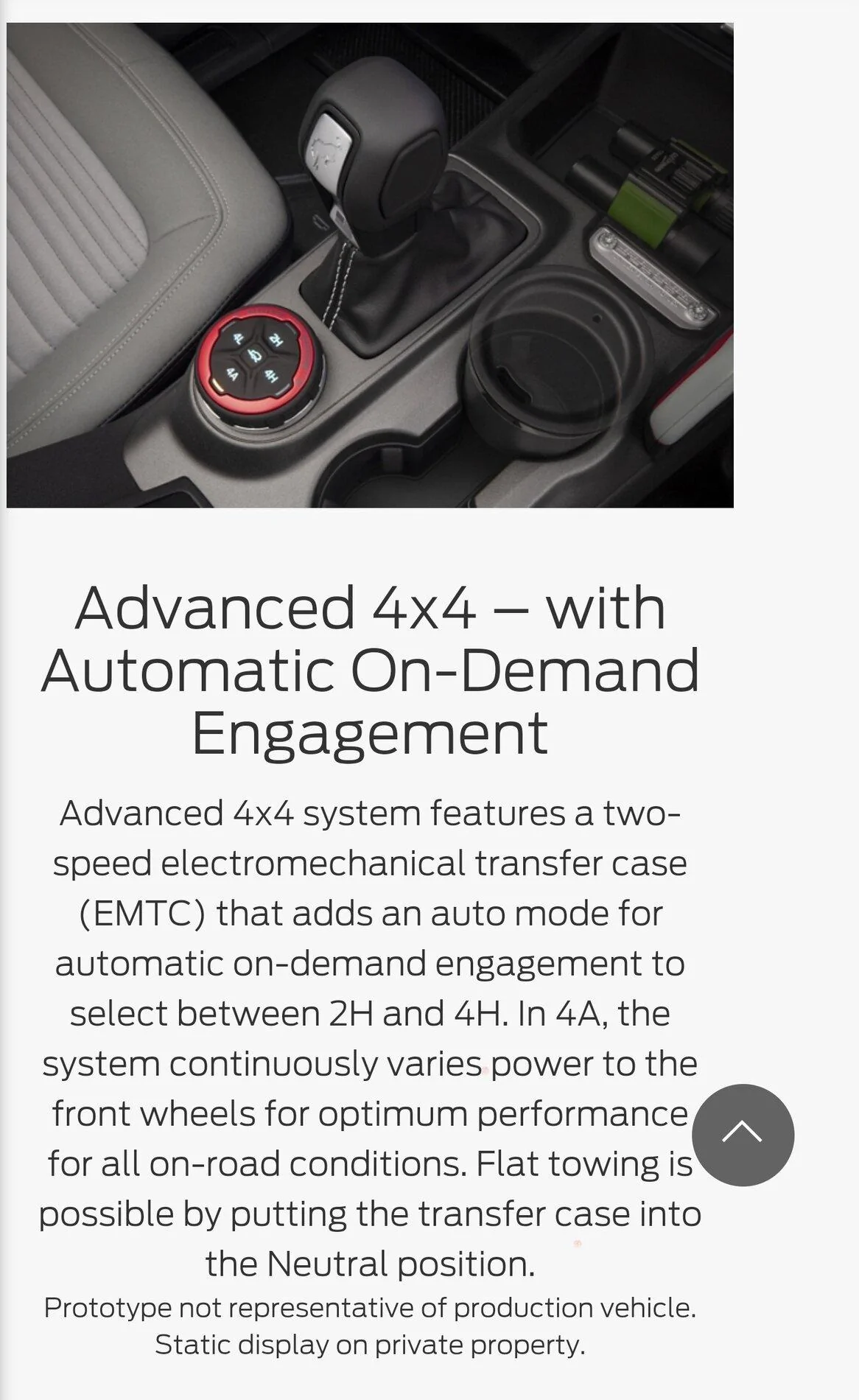

For what its worth, here's Ford's description:
Ford Bronco Automatic Transfer Case Operation Screenshot_20200801-111643_Chrome
It does mention that it "continuously varies" power to the front wheels, which doesn't sound like a locked center to me.
Good info. In 4A sounds similar to my Torsen diff where it provides power front/back axles w/o binding the drivetrain on dry asphalt. Click it into 4H (or 4L) and then you have the traditional 4x4 (same as my current 4runner).
Ah, that's much more hopeful that it's similar to the Raptor transfer case. Good find
