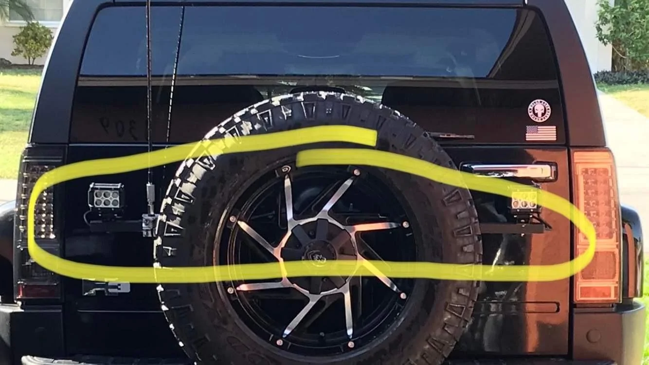

Waiting for a set up like this…
Hopefully a light bar with GMRS/CB mount.
Had a custom set up on my Jeep and H3, hopefully someone would do one for Broncos. As far as wiring I’m just going to run it to the Aux wire on the rear passenger panel.

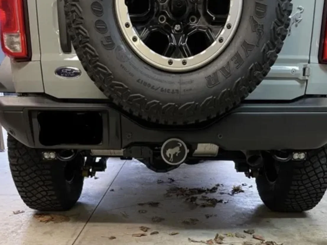

I picked up the 4x4TrucksLED kit with 2 Baja Designs S2s. I haven't installed yet, but this thread will be helpful. Not my truck, but saw this on 4X4 customer gallery. This is what I'm looking to do.
