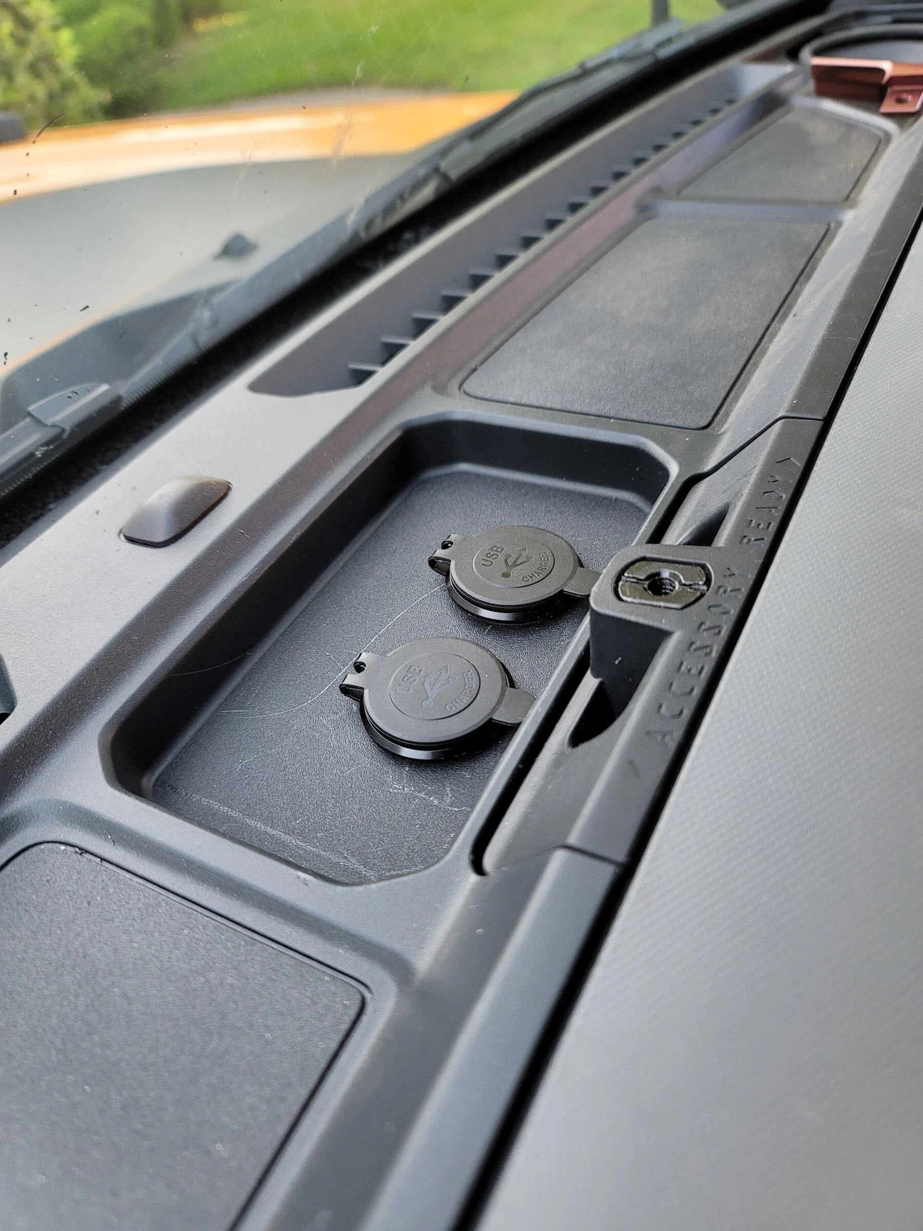

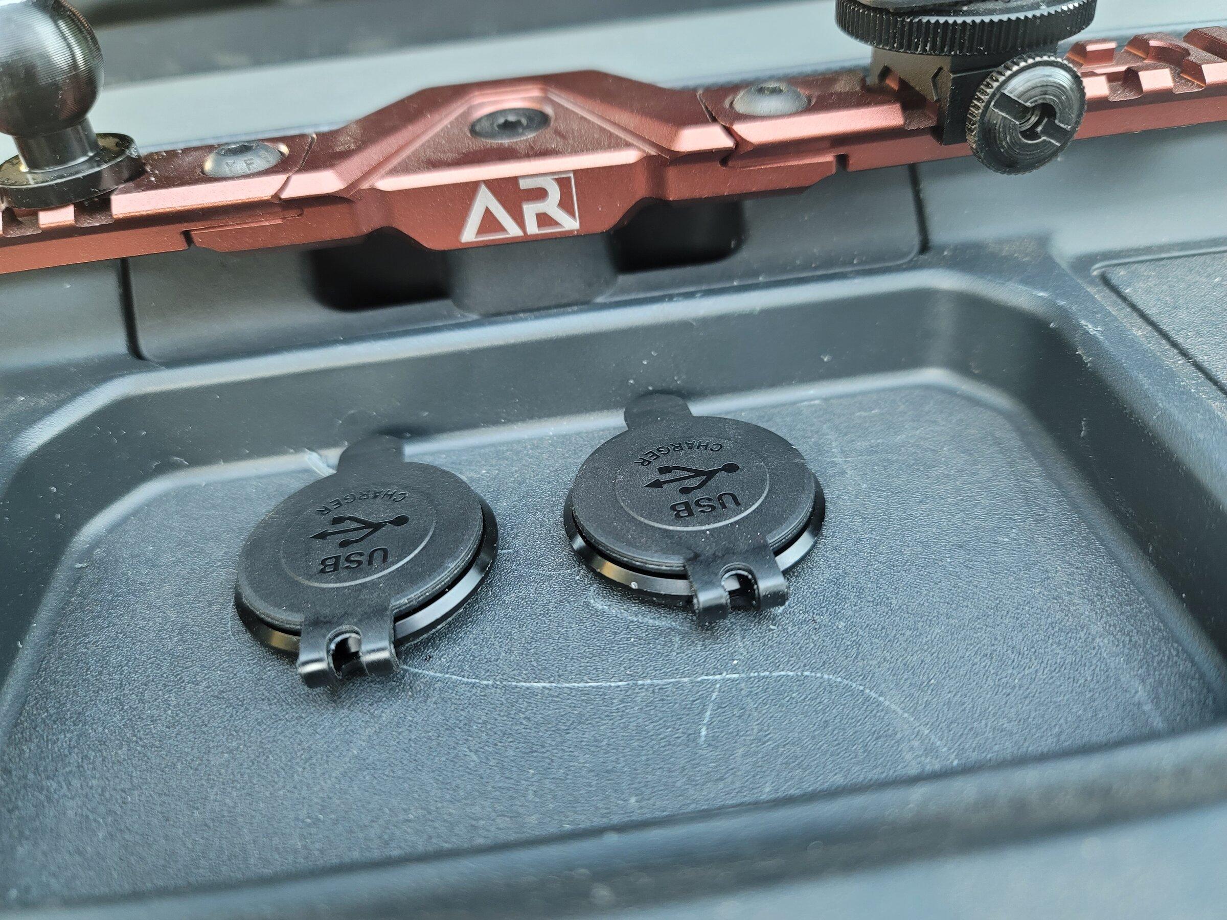

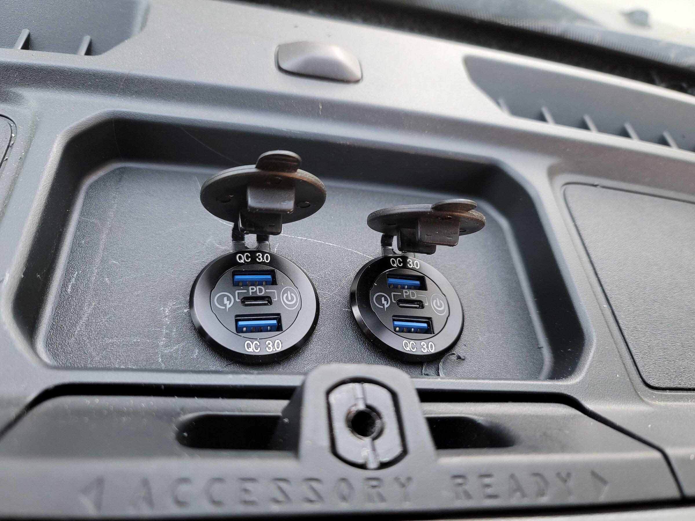

Sorry I didn't take In progress pics to show what I did.. but I will describe it best I can... bought two of these on Amazon (came in a pair) because I wanted at least one usb3 port..
And on inspection I realized I had room for both so I figured while I'm in there...
Grabbed my step bit and cut two holes to fit. Snaked the wiring up from underneath (fishtape works great for this) and paired both outlets together with enough room to work, so there's only one set of wires coming down behind the glove box. Haven't connected them yet.. considering if I want to Go ahead and just run a dedicated wire to the fusebox or tap into the aux circuit that powers my gmrs radio...
Thought I'd share.. and give someone some ideas...

1... there is an access area thats under the recessed area.. The rest was relatively solid... but that area was the only one that had enough space under the dash to allow the remainder of the port (about 1 1/4" or so) to poke through.
2. All molded in.
3. There's a lot of 'stuff' over there.. there's a reason ford put their accessory port in the center.. :)
4. For now (semi temporary, may end up perm who knows)... I'm using one of my switches to power my 50watt GMRS radio, so I tapped into that power for the accessories on the dash.
as I said, i didnt take pictures of the installation process.. and TBH.. I really dont want to break open the dash just to take some pics... that was a task... LOL.. and as much as I tried not to.. I still ended up with a couple extra screws i have no clue where they go.. LOL...
