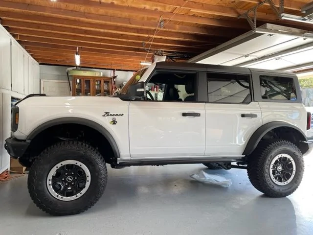

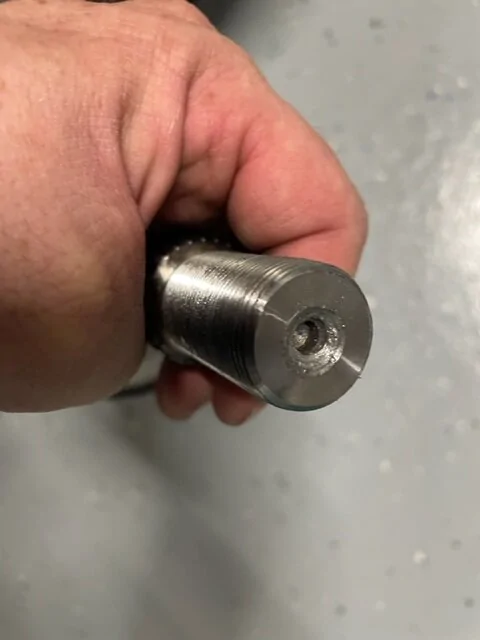

Well I finished upgrading my axles, steering & installed SVC perch collars and learned a few things while doing so.
First the front axles are stubborn to get out. Never had a problem pounding axles out with a hand sledge & punch before but after a good 30 minutes of that I called up the local AutoZone & got a hub puller & 3-jaw puller. Hub puller didn't fit, but needed it anyway as it had the driver for the 3-jaw puller in that kit. Next I found that the axles are really soft. While the 3-jaw puller made short work of pulling the axles, the driver chewed into the axle centers pretty good. from the pictures below. Not a big issue but you can see why you do not want to use an impact wrench when removing or installing the hub nuts. Really should not shock hub bearing like that anyway ;).
Passenger side nut was messed up a little when removing and took extra effort to remove (Don't reuse axle nuts). If you carry spare axles on the trail, make sure to have a good 3-jaw puller with a hardened steel driver, not Harbor Freight pot metal jaw puller in your tool kit, it will strip out in no time. Those axles are stubborn.

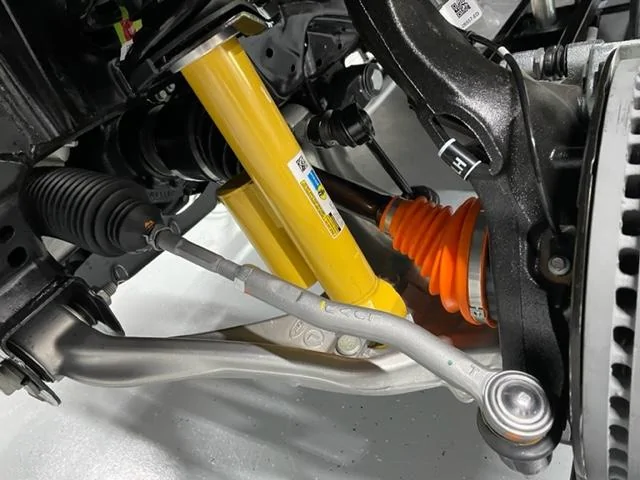

Second, I installed the Bronco Buster Bushing & Stage 3 housing. Bushing went in easily enough. The stage 3 housing a bit more effort was needed. While the passenger side came off easy, the driver side did not seem like it was budging. Man getting that driver side bolt lose was nuts. It had me doubting my Dewalt DCF891B that is rated at 800 lbs. removal strength 😲. Out came the 24" breaker bar with a fat guy on the end of it. Well the Dewalt must have weakened it (Dewalt proved itself on the rear shock bolts) as I was able to break it fairly quickly & finish it with the impact gun. Next challenge was fighting with the just big enough" hose clamp that was in the kit. I must have spent 40 minutes fighting trying to get that to connect when it dawned on me I have a drawer full of those things :sneaky:. I was a little gassed & jug-headed at that time of the install so, if I tried again today it might have gone on there.

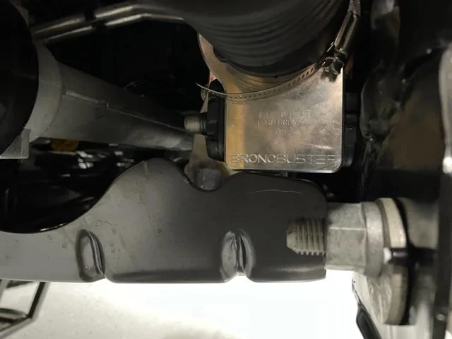

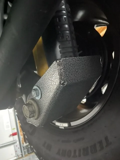

I also added the Bronc Buster shock mount skids. The Dewalt pulled the bolts with out breaking a sweat & redeemed itself from the driver side steering rack bolt 🙏

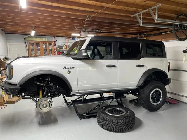

The perch collars were a straight forward install with little drama other than the last one in the rear was so fun I did it twice :sneaky: . Jug-headedness strikes again & I realized that I forgot to put the boot back on once it was installed in the truck

Still waiting for the suspension to settle & my tires to come in, then it will be off to the alignment shop. Once home I will install the BroncBuster Tie rod braces.

No lock or crush channel in the axles. They used the impact gun on yours. My passenger side nut was boogered from the factory, but the axle was ok. If I used an impact wrench it would have turned out like yours as well as it had a lot of friction during removal.

I have been looking for a Floor Jack like yours. Which one did you go with?

It's an old Quick Jack BL-5000SLX . it's a great lift & stores out of the way on the wall. They are bit more money now but they lift 3" higher now as well.

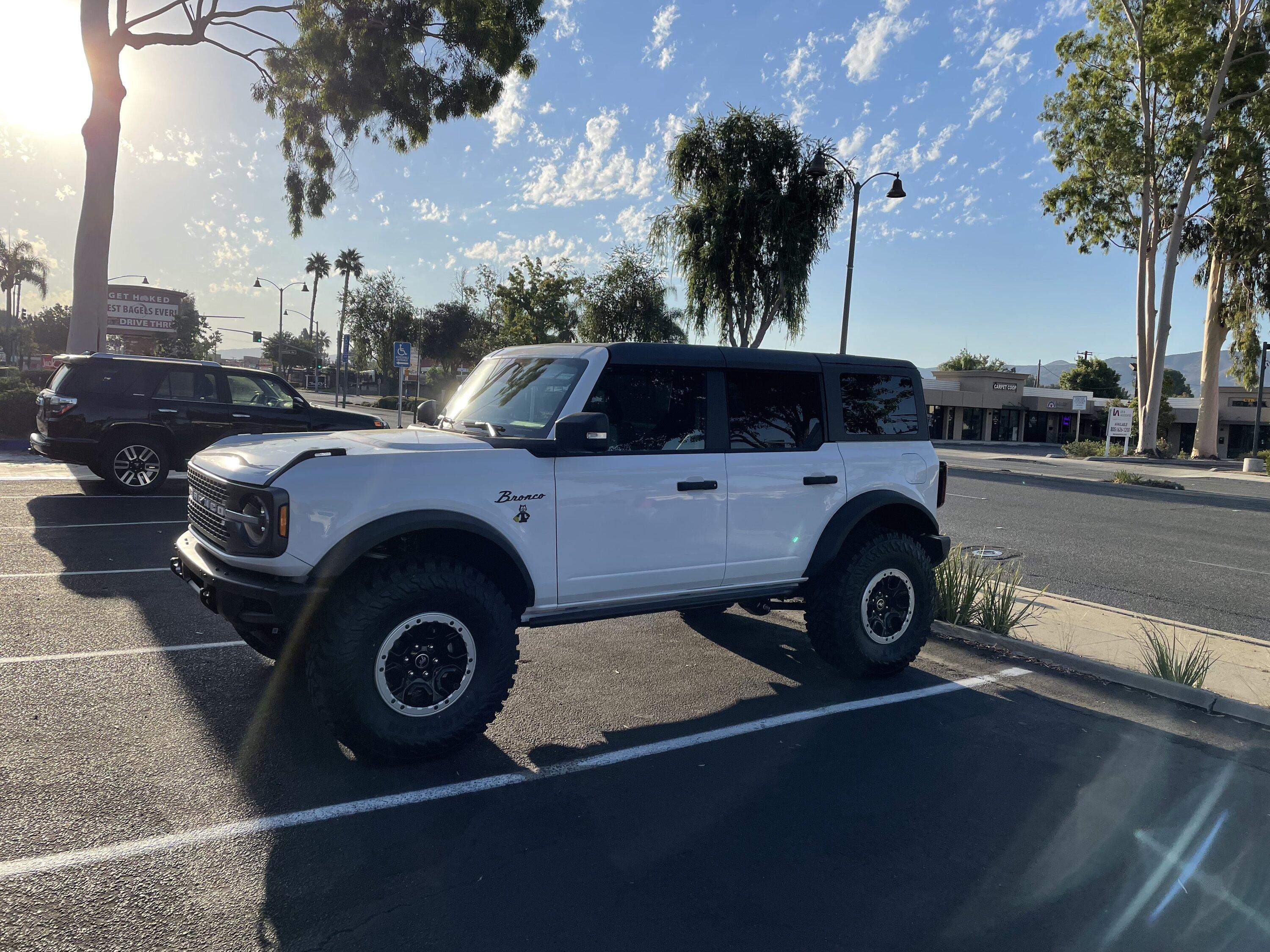

@Felix808 Amazing build. I’m getting the SVC perch collars put on in the coming weeks and I’m keeping the stock Sasquatch tires and rims. Any idea how much lift you got after the install? Also, no need for wheel spacers with the 37’s and the JKS kit?
Thanks.
I had a little rubbing the other night under full compression & full lock, but not enough to worry about or consider running spacers. I think it was on the skid plate. I really like the SAS wheels myself. I doubt you would have any issues sticking with the SAS tires & wheels.
It looks like it was at the trans brace 11.5" stock 13.5" after perch collars & 14.875" after tires.
Rear lower control arm was 11.125" stock 13.75" after perch collars & 14.5" after tires.
