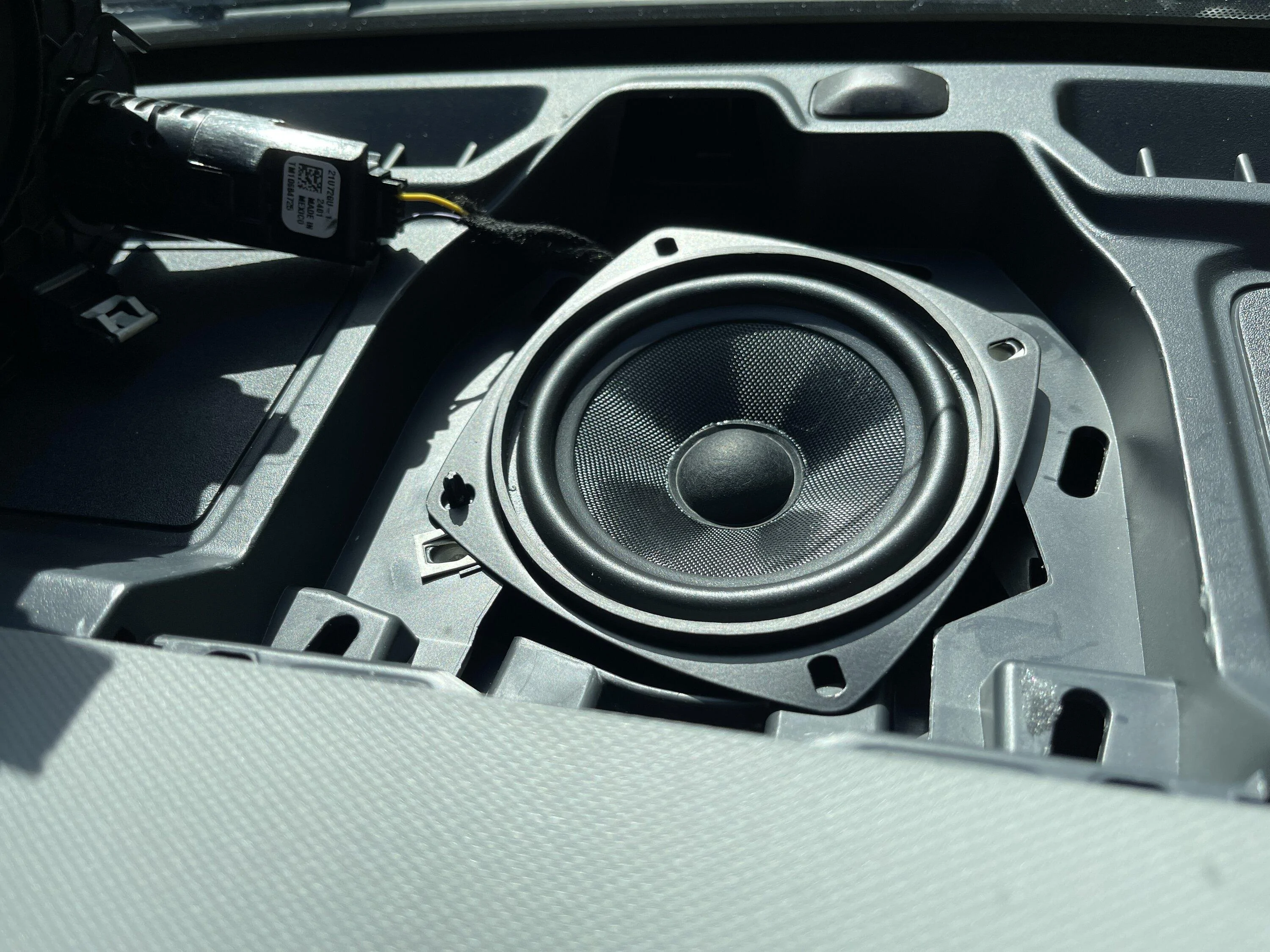

I just got the PRV 4” for the Center like you but I’m not sure how to mount it. Any suggestions? How did you do it?
Did you just screw in one side and cut the post on that and just attached to the post on the other? I see no harnesses you can buy to make this work. Maybe find a metal bracket and drill holes?
Remove the small plastic alignment pins. (Post as you called them)
Then install with the 2 factory screws.

Take off the small plastic alignment pins. Then screw down with 2 screws.
They just pop off? The speaker holes are still too short.
Ok cheap plastic just come off.

A tad short. But maybe it will work, did you install bass blockers?

Ok works, thanks đź‘Ť
