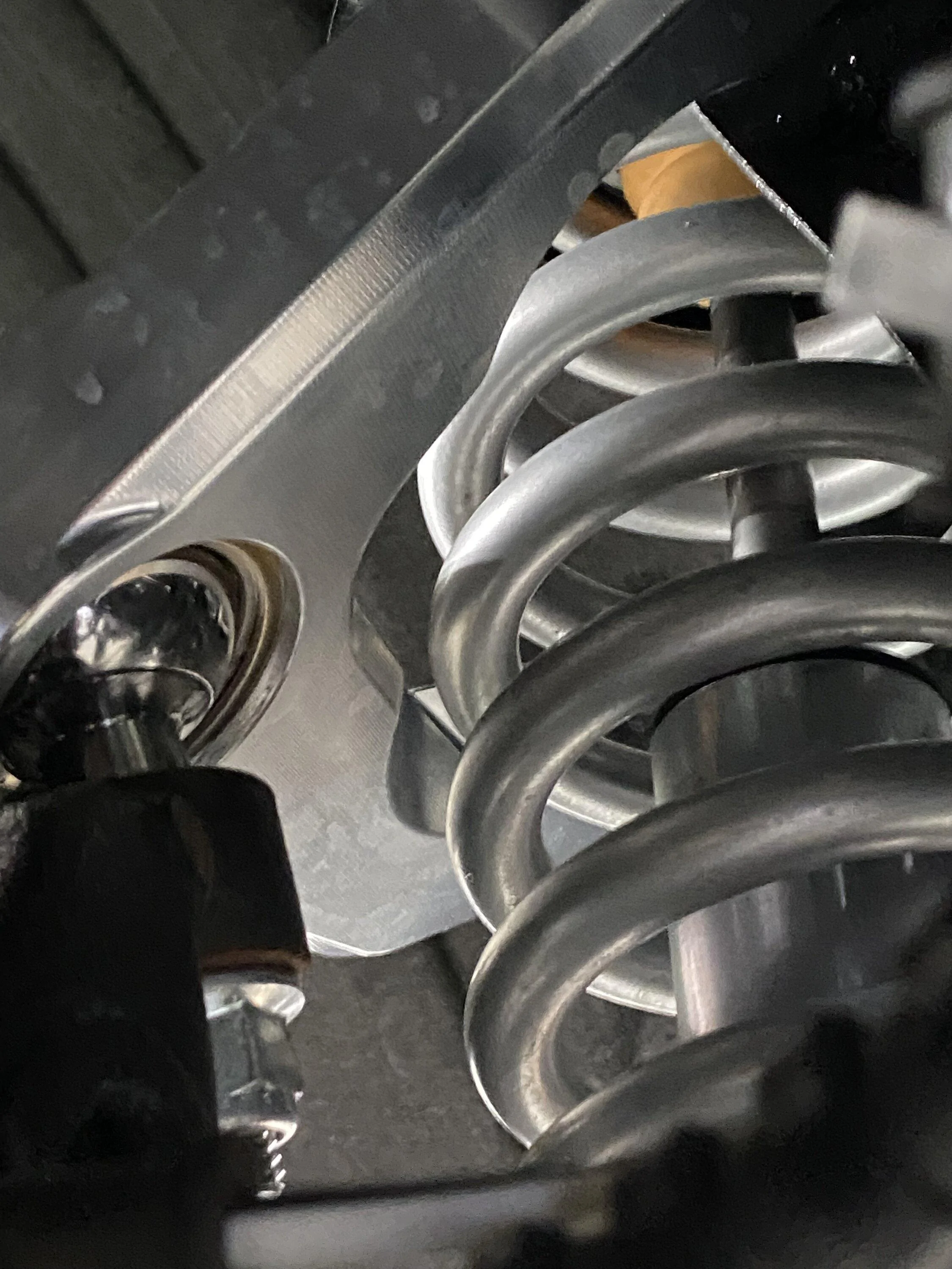

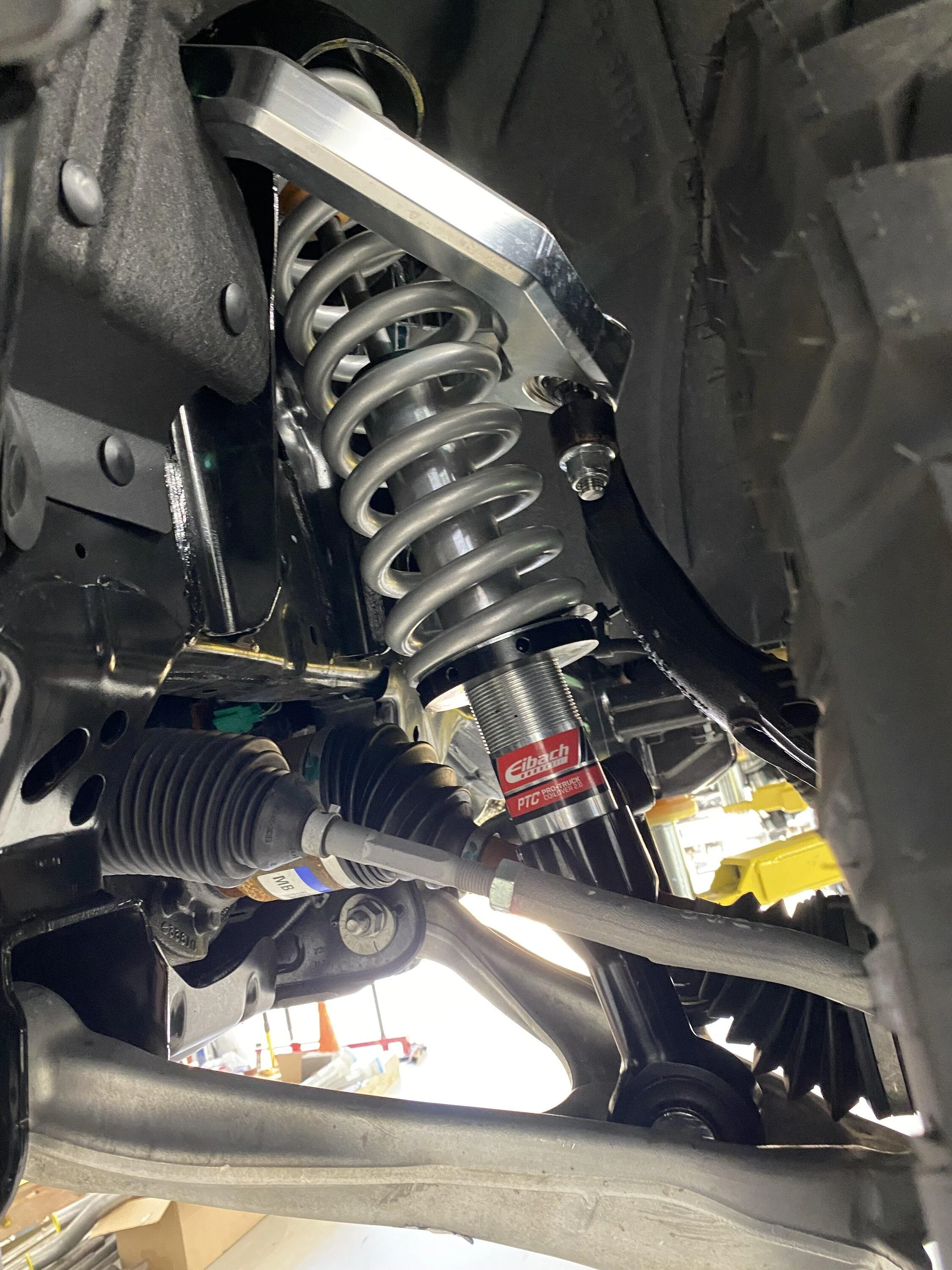

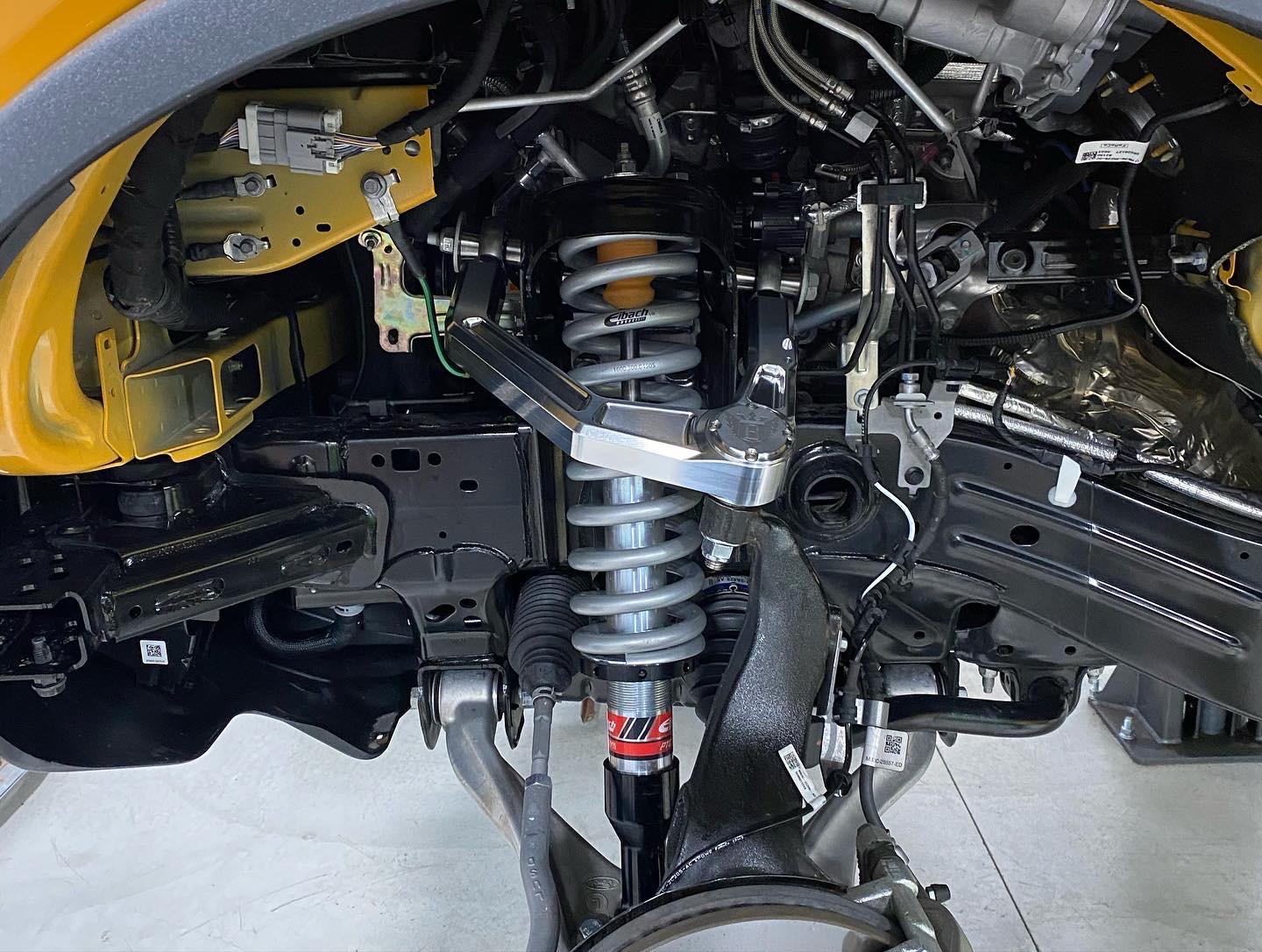

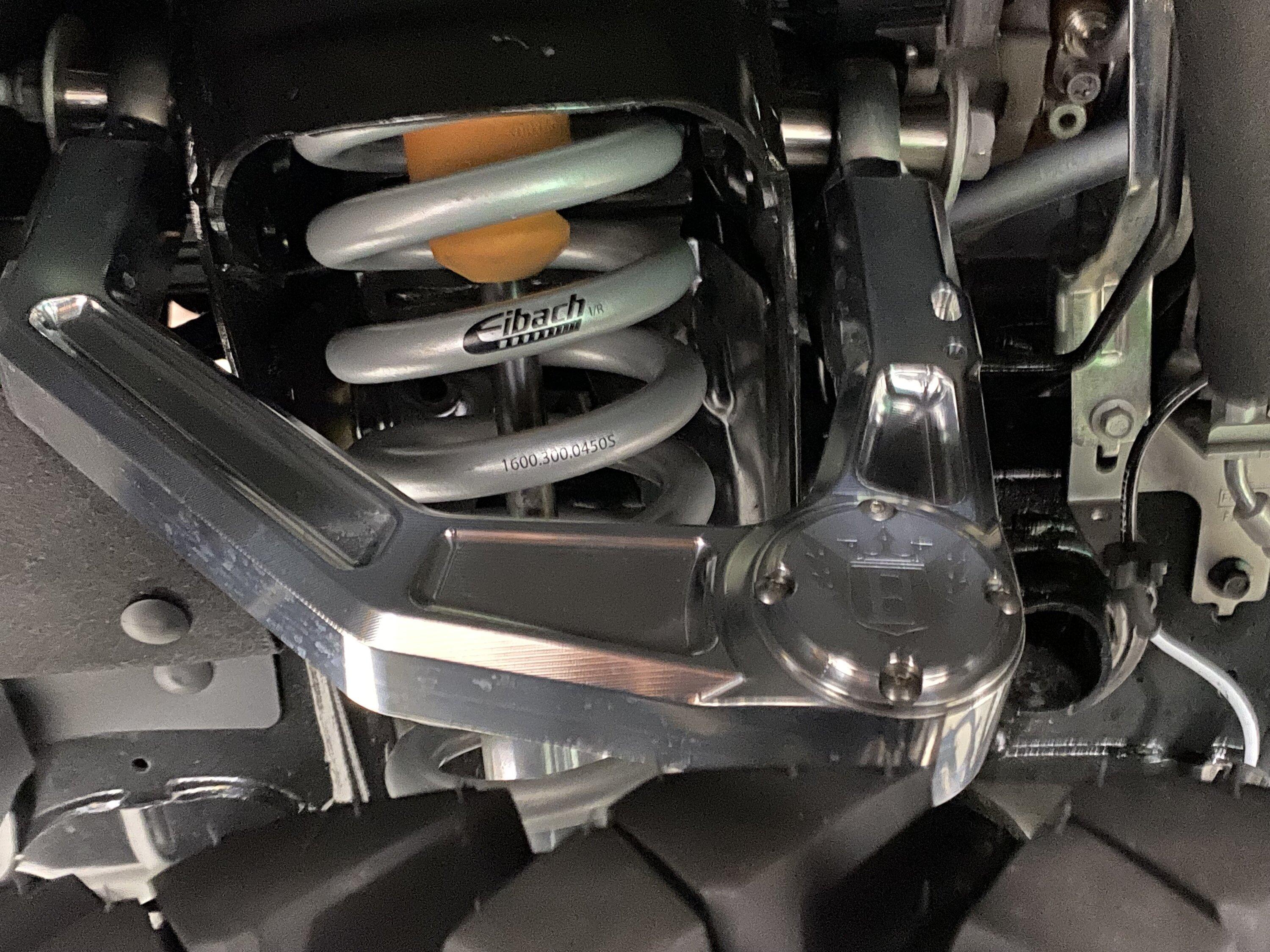

Been busy working and forgot to show photos of our lift kit install. We used the Eibach Pro Truck Coilovers with our billet control arms and rear links.
After installing, I am very impressed with the ride quality of these shocks and at an incredible price point!
We do offer Fox, King and Radflo options combined with our kits but for now we installed these to test them out and since they are readily available. The shocks are very easy to install and comes with all hardware needed.

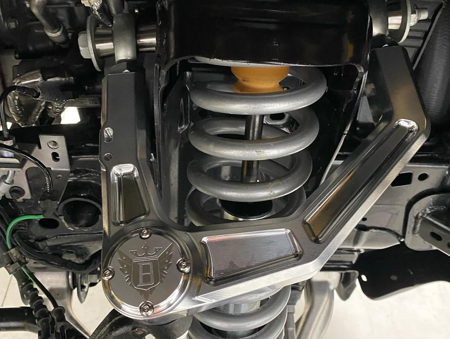

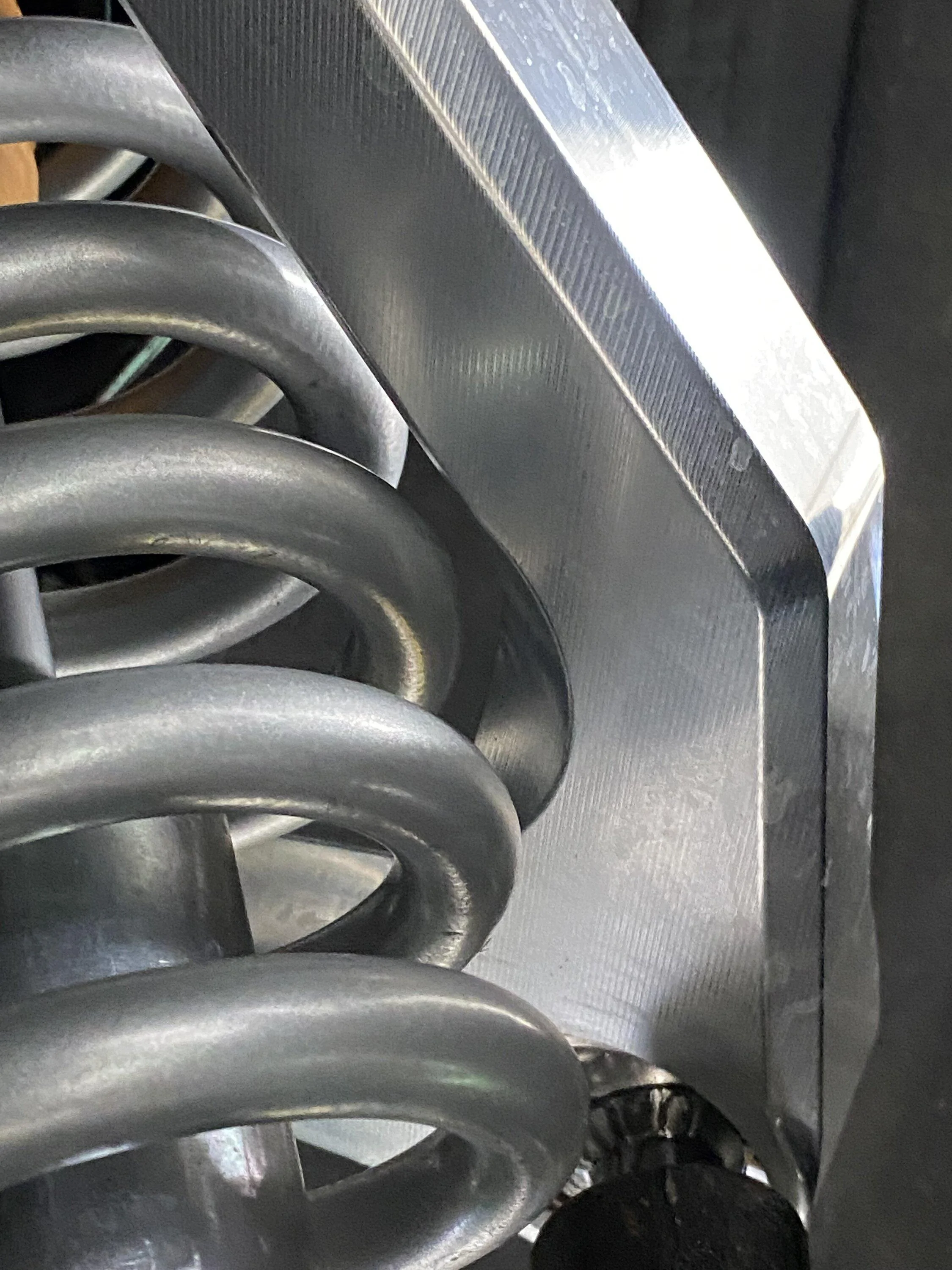

We installed our upper control arms while we were doing the shocks and as you can see in the photos, even at full extension, there is plenty of clearance between the shock spring and UCA. Compared to the stock bushings that are integrated in the factory UCA, our misalignment bushings fit much tighter for a precision fit.
(Quick Note: Just want to say that even though Eibach doesn't require one to change their UCA to run this Coilover kit, after removing and replacing with ours, the aftermarket one makes it bulletproof! The factory one is light as a feather and has a balljoint, where ours use a hardened pin along with FK spherical bearings and the billet is way stronger than that cast piece.)

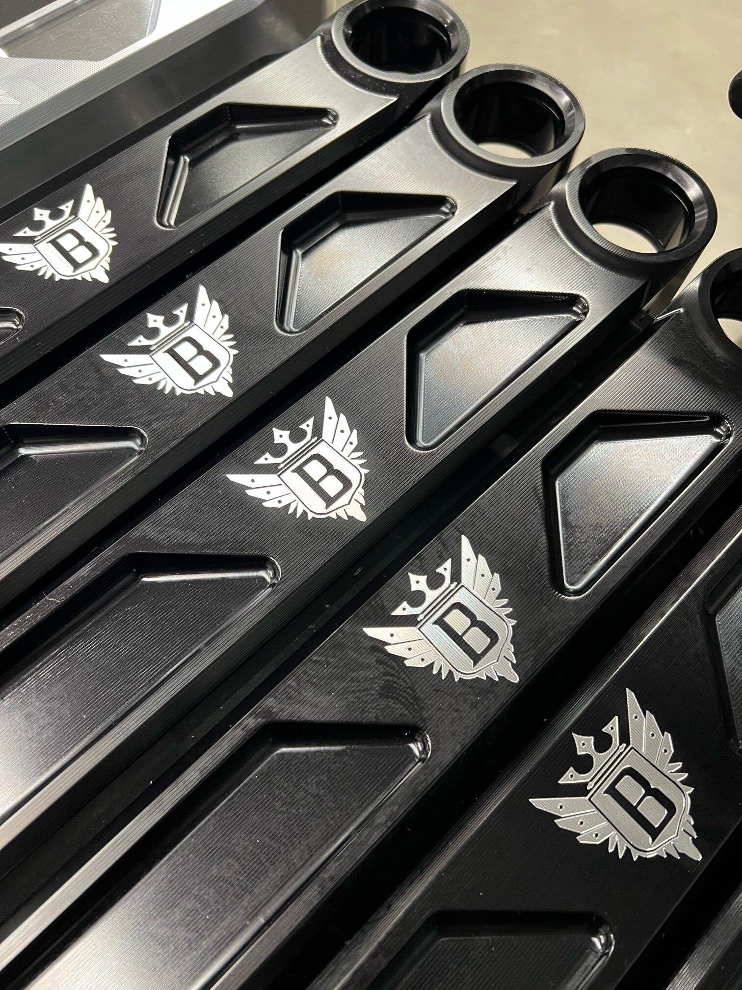

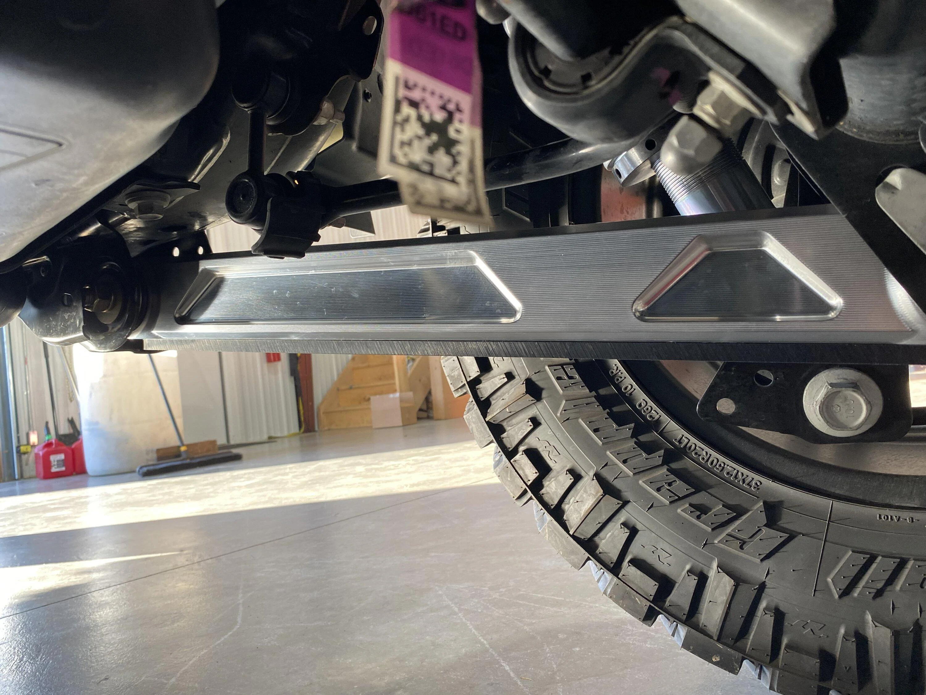

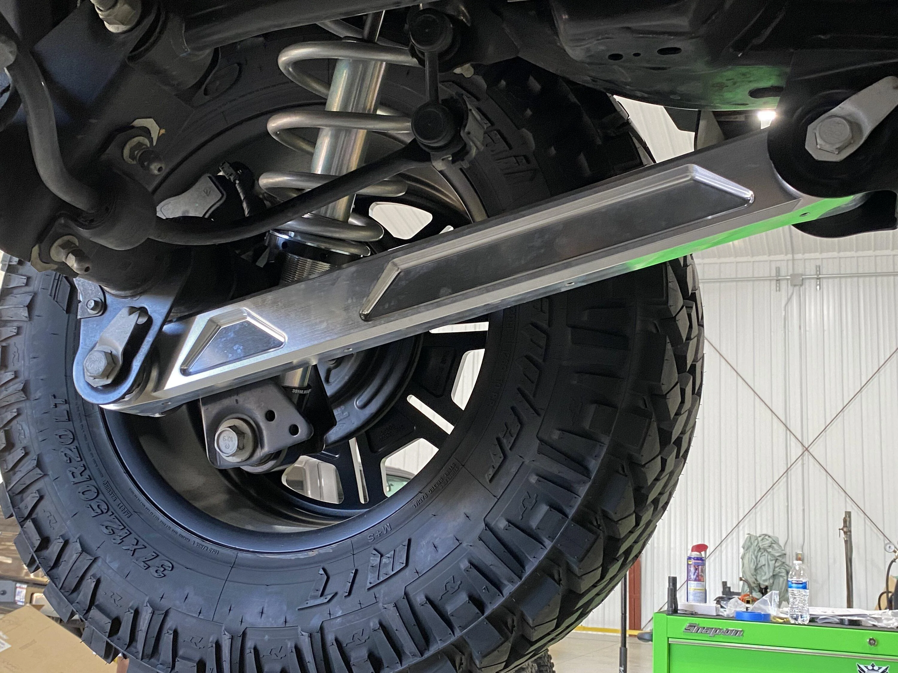

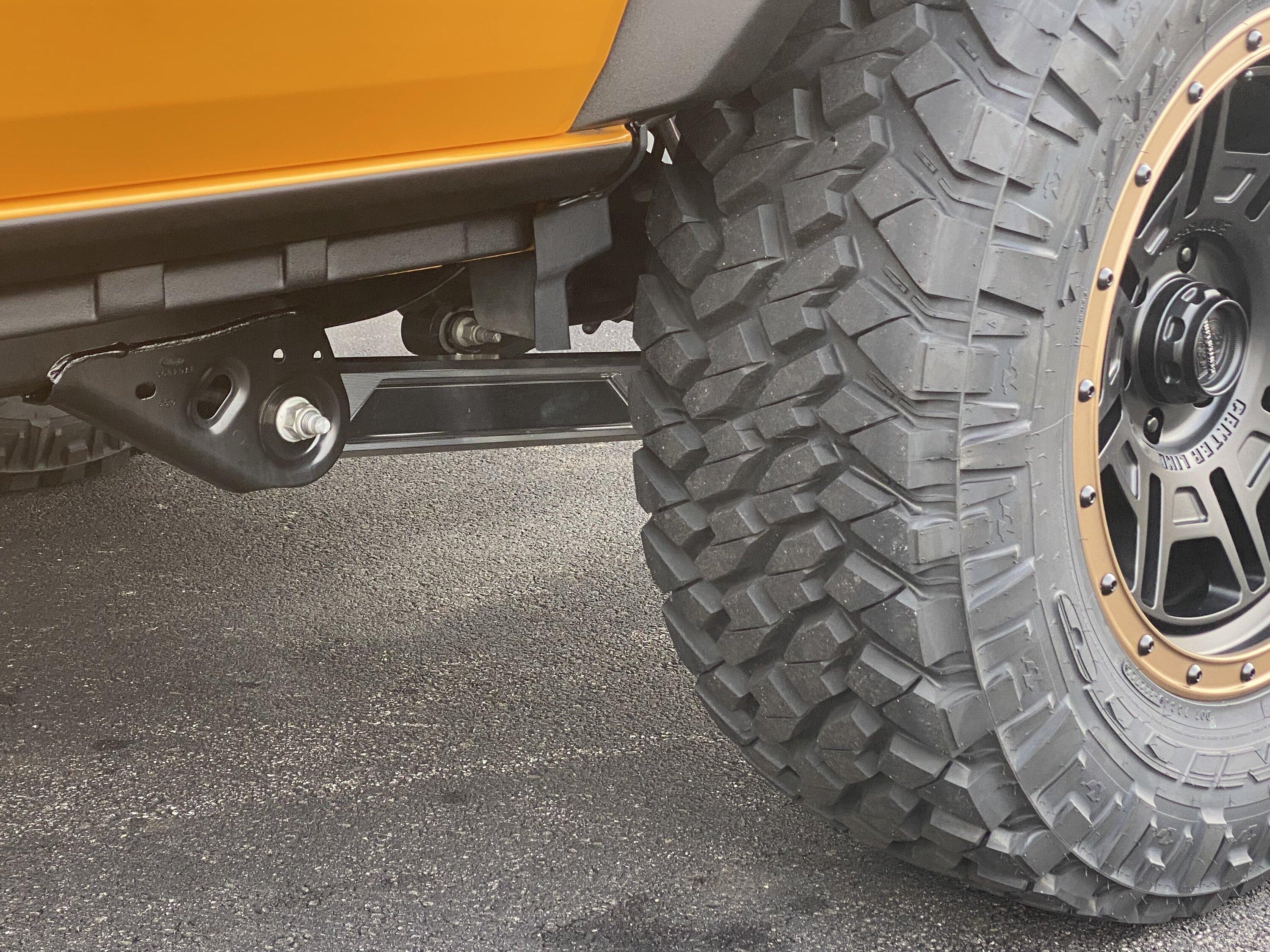

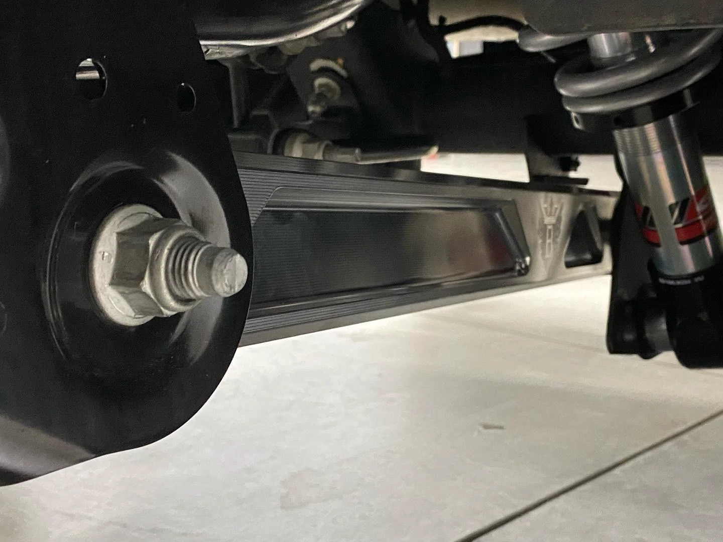

Next, we removed the factory rear links and installed our billet links that feature UHMW to protect the bottom from rock damage. Plus UHMW is self lubricating so it helps slide easier over obstacles.

How much lift did the Eibach coilovers provide? Did you adjust them any beyond how they were shipped? Love the UCAs and rear links! Thanks.
BachBuiltOffRoad
BachBuiltOffRoad
Base Sponsor (Level 1)
Dustin
Jul 20, 2022
172
203
Boardman, OH
www.BachBuiltOffRoad.com
2022 Bronco Outer Banks/ Badlands on order 7/9/21
Thanks for the compliment!
I should have measured the before and after to be exact but I am sitting approx 5-6 taller with the Coilovers and 37” tires. I did adjust the front Coilovers a little to try and level out the front. The rear, I left as they came out of the box.
-Dustin
