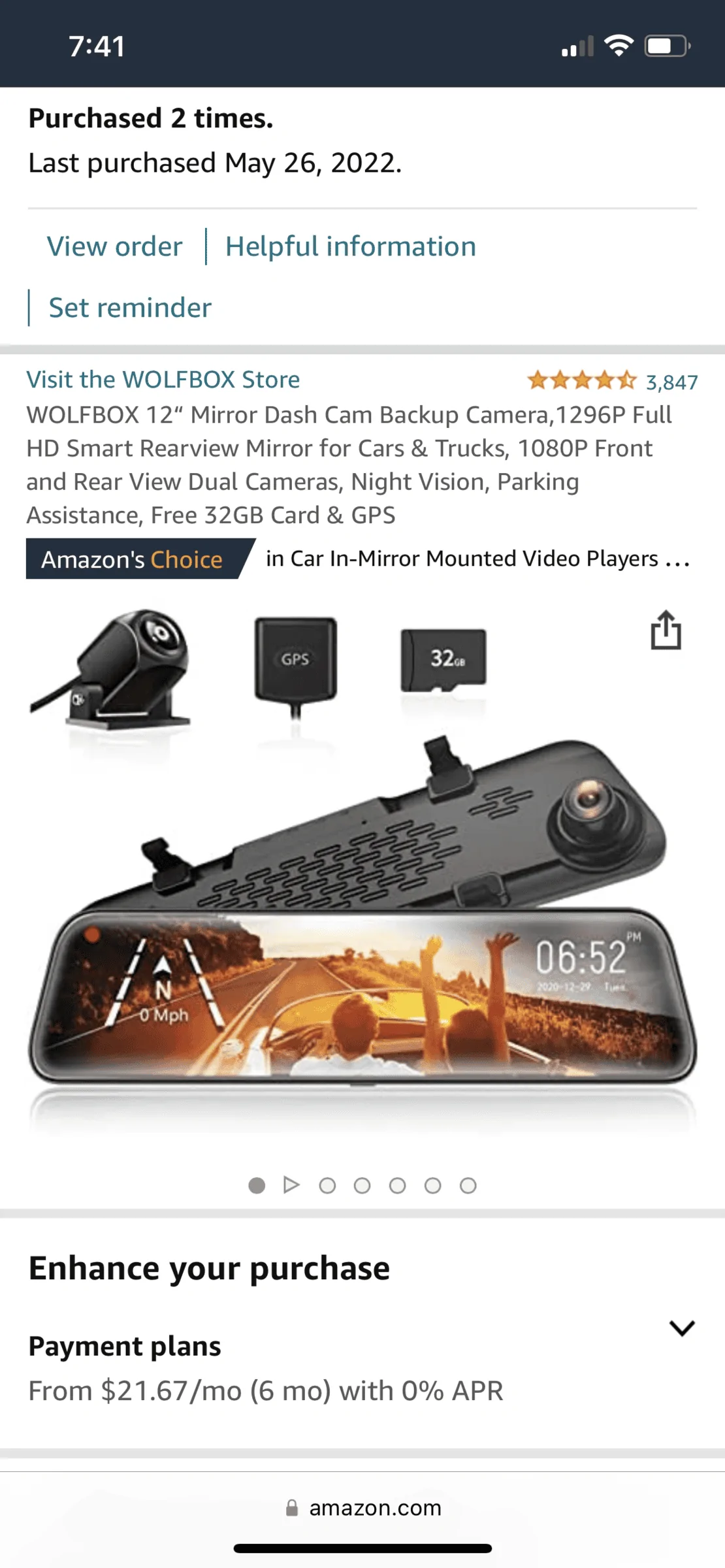

I added a back up cam mirror to mine yesterday. Got use to the new video mirrors. Pretty easy install. Rubber band over the factory mirror. Added bonus it has a front facing camera. Had the same one in my x3. Good quality mirror. Have to tilt her down with the top off to cut the glare. It records in loops for a dash cam. Can scroll the mirror itself to see more up and down with it. I cut the red trigger wire off and don’t use the gps. Way better unit then what came in my suburban.
https://www.amazon.com/gp/aw/d/B0811Q28N6?psc=1&ref=ppx_pop_mob_b_asin_title

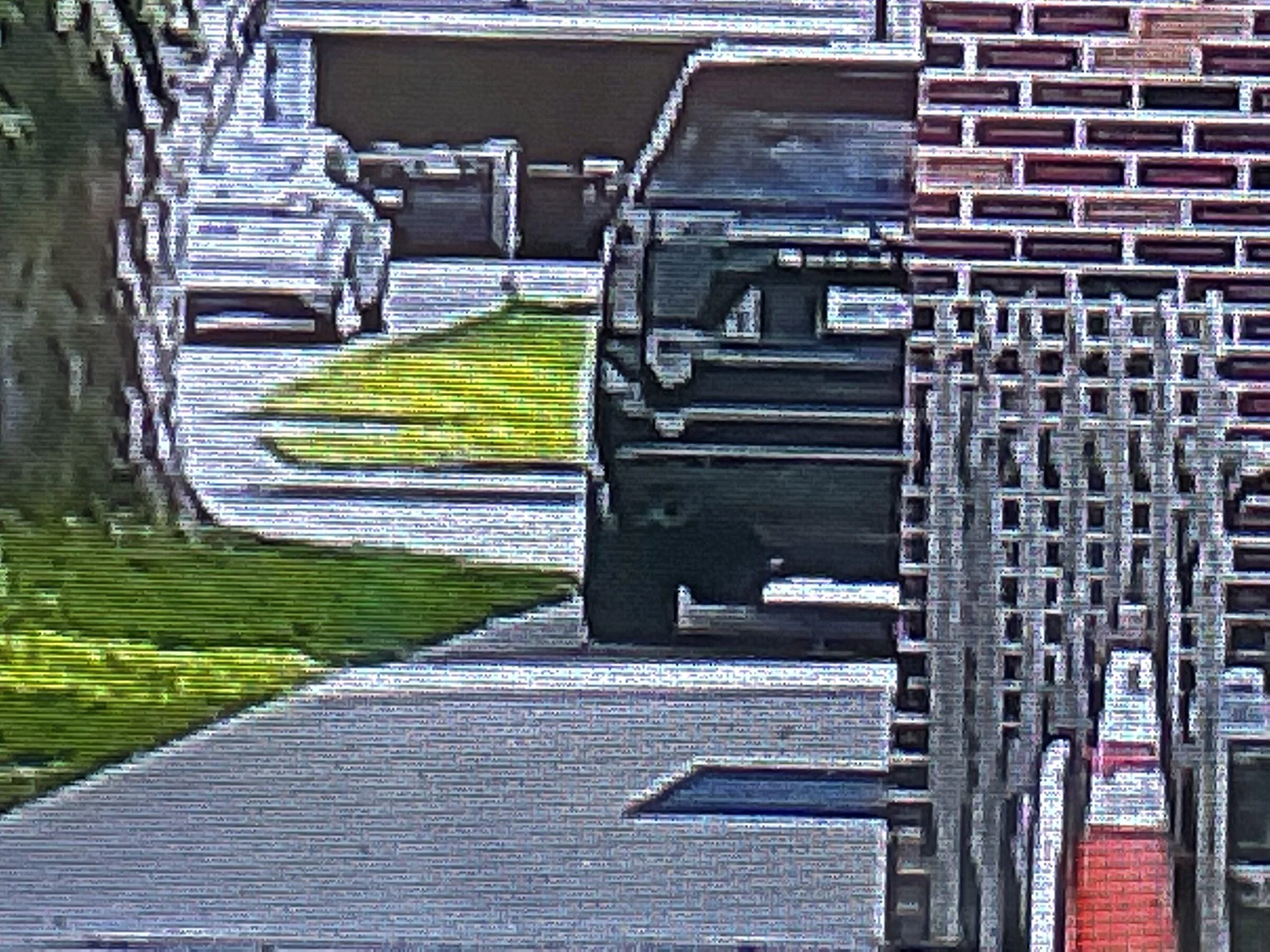

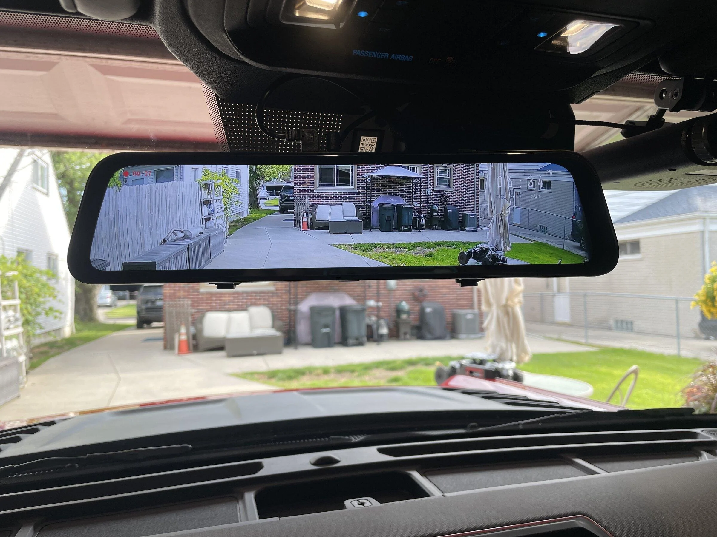

None on the road. Just went out and took pics of the video from the mirror. Just put it in front mode. It does front, front/back, and back. Pictures looked a little washed out. Looks better in person. Will take some rolling vids when I get it back out next weekend. Second pic is the phone zoomed in on the mirror.

nice! appreciate it. looks quite nice. considering doing this as well.

Power is supplied thru mini usb (the old fat camera one) and runs off of 5 volts. I wired a usb plug behind the passenger kick panel for it and plugged it in to that. Mirror itself is wide enough the front camera to slide next to it. Rear camera I put under the factory rear camera and ran return wire down the passenger side. It comes with a cigarette/mini usb in the box. You could also wire in a cig plug adapter to. If you can get the usb mirror dongle which is suppose to be back in stock this month I believe, you can pull power from the rear view mirror.
It can do back up lines and has adjustments for them.
Quality wise (picture)! it’s better than my suburban and our Escalades video mirror. Fov is huge on it.
