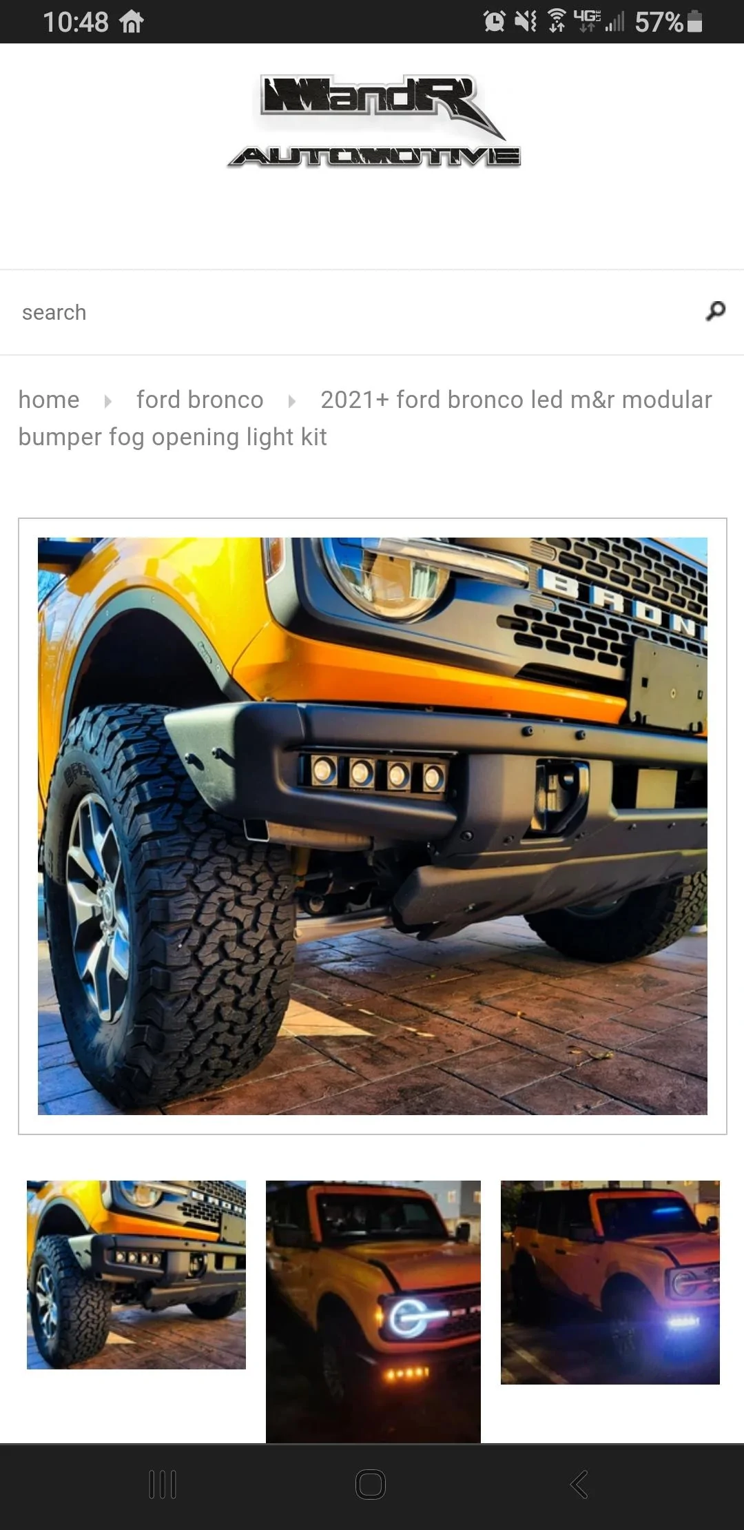

So I am thinking about ordering these for my WT, would it be a bad idea to just wire them to the low beams? I don't want to use the uplifters or buy a whole new headlight switch with fog button. What do you all think?
https://mandronline.com/products/2021-ford-bronco-led-m-r-modular-bumper-light-kit
Ford Bronco Bad idea? Screenshot_20220120-224831_Chrome
