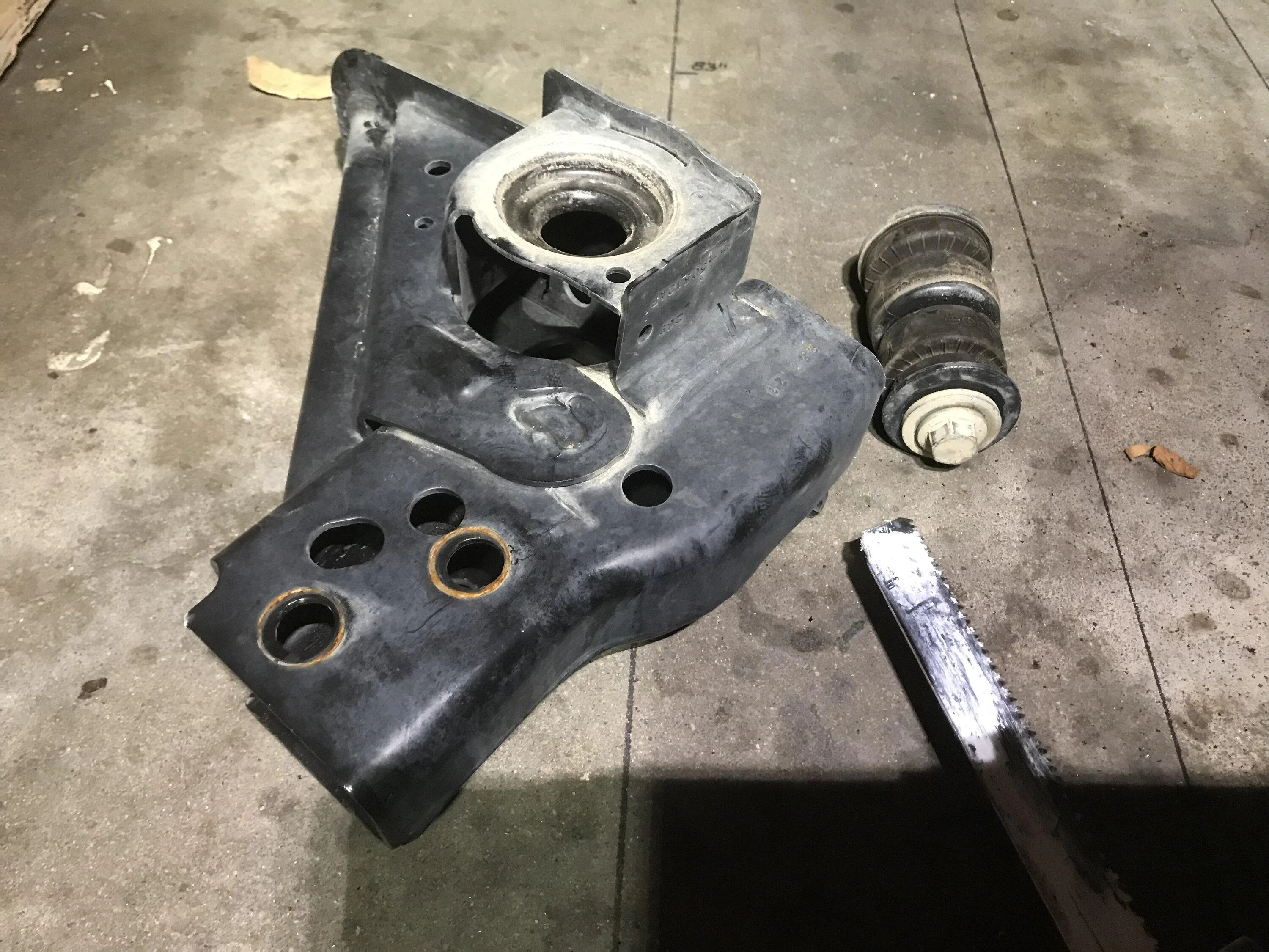

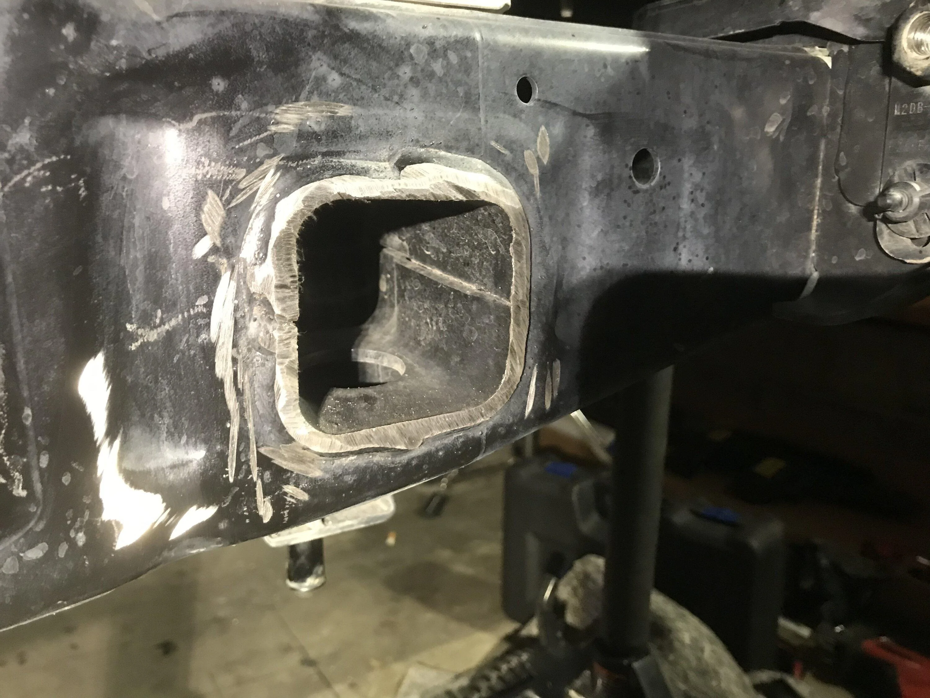

I was wondering why yours looked so different. I didn’t know you cut those ends off. I hate those ends, but I really don't want to try and cut them off.
They’re absolutely obnoxious looking. It’s just an oversized body mount. I’ve had my eye on cutting them off for the past year but wanted to wait until I could do all the work at once.

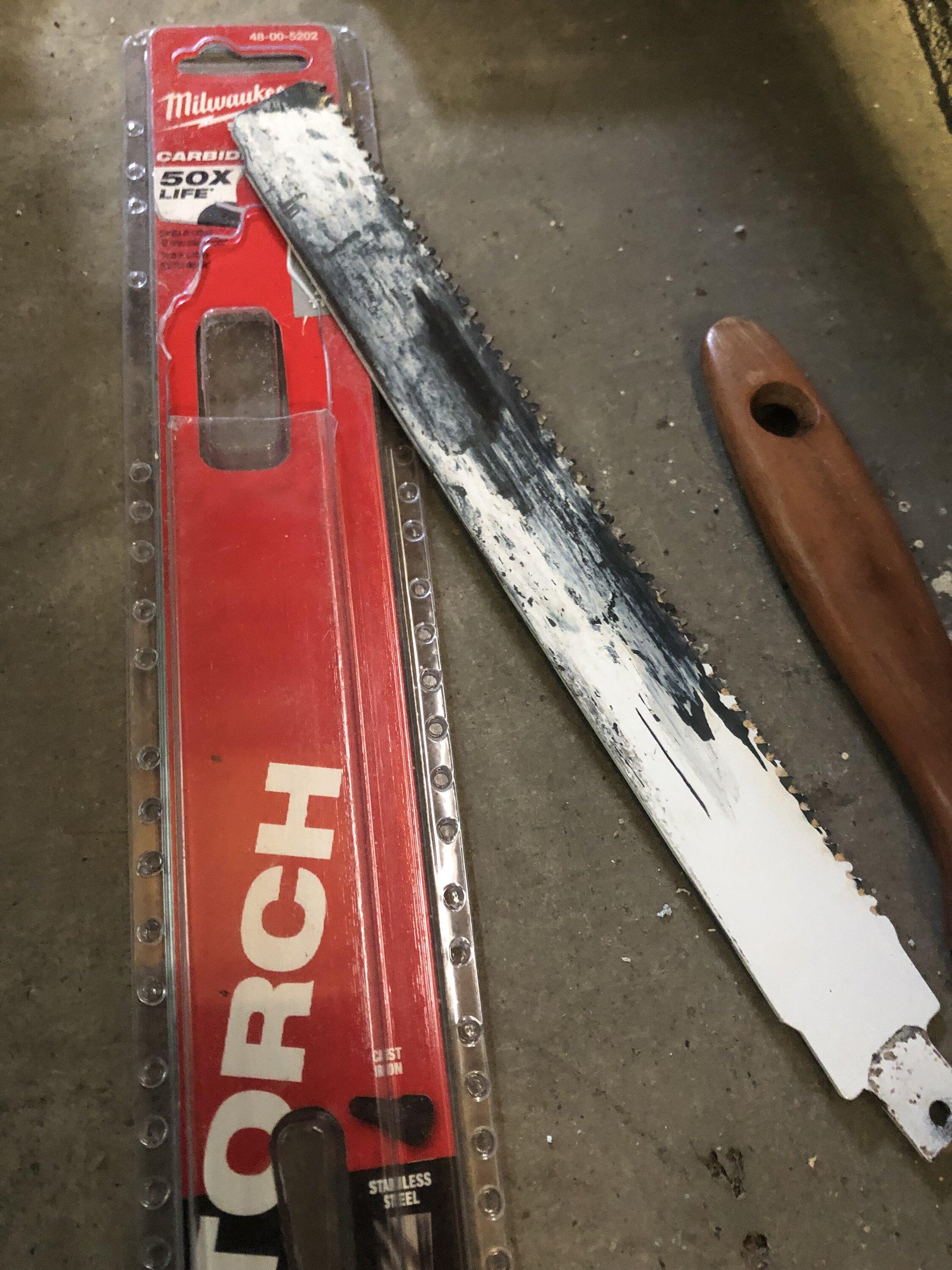

With the right tools, specifically choice in blade. One per side. It really wasn’t a hard job. It was one of the more satisfying task to hear them hit the ground.

So you used a recirculating saw? IDK, it scares me to think what it looks like if I screwed up the cut, LOL. I wish you were close, I'd pay you to cut it. So that's all those tabs are for, some type of body mount?
Yep, it’s just a body mount. It’s large to incorporate the crash bars.
I’m sure to navigate whatever fed regulations for safety or safety rating they needed.
I guess it’s a matter of perspective. I’ve worked w/ tools for 35+ yrs in a heavy equipment industry, so I was comfortable with it. Even so, after doing it, I don’t think it was a hard task. Just take your time and follow the steps.

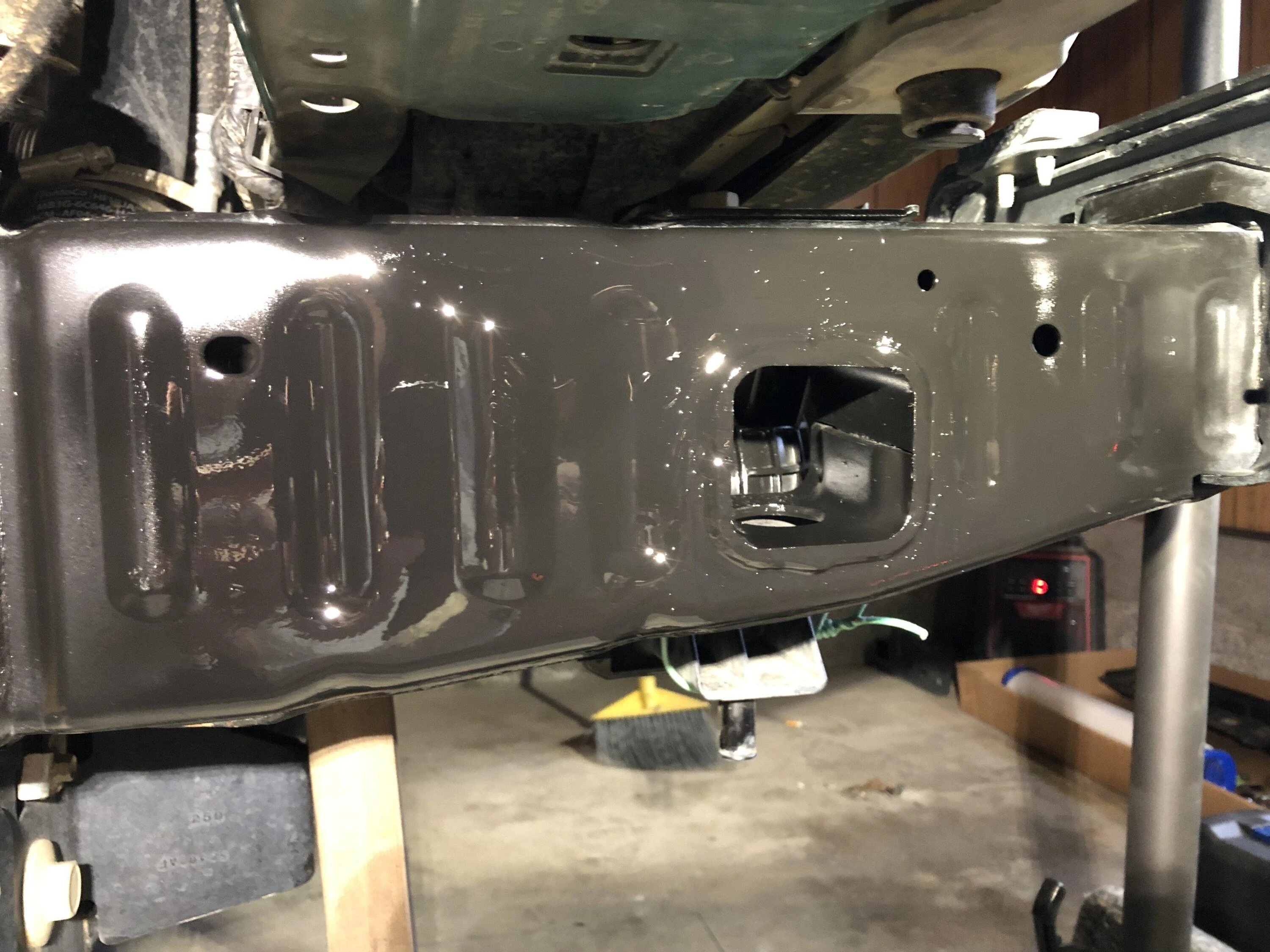

Reciprocating Saw is the right tool for the job here. Cut wheels to clean it up if needed. Grind off the burrs. Prime. 3 rattle-can coats of paint. Install new brackets.
