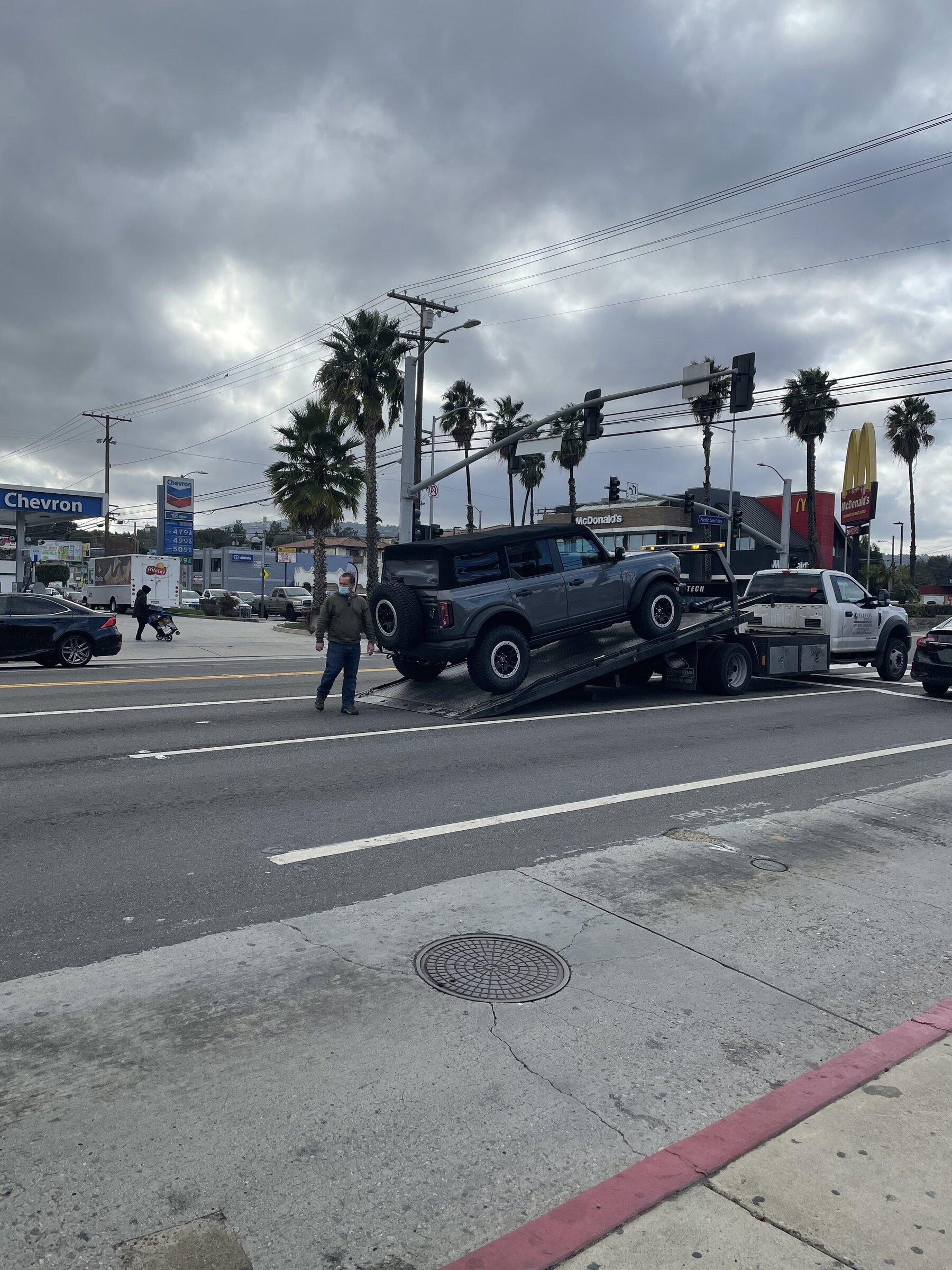

I need some help. My bronco shut off abruptly when coming to a stop and it wasn’t the auto stop. Anyone have an abs fault or something like that? Is there a reset? I tried disconnecting the battery to reset but no luck. At the dealer now, they are scratching their heads.

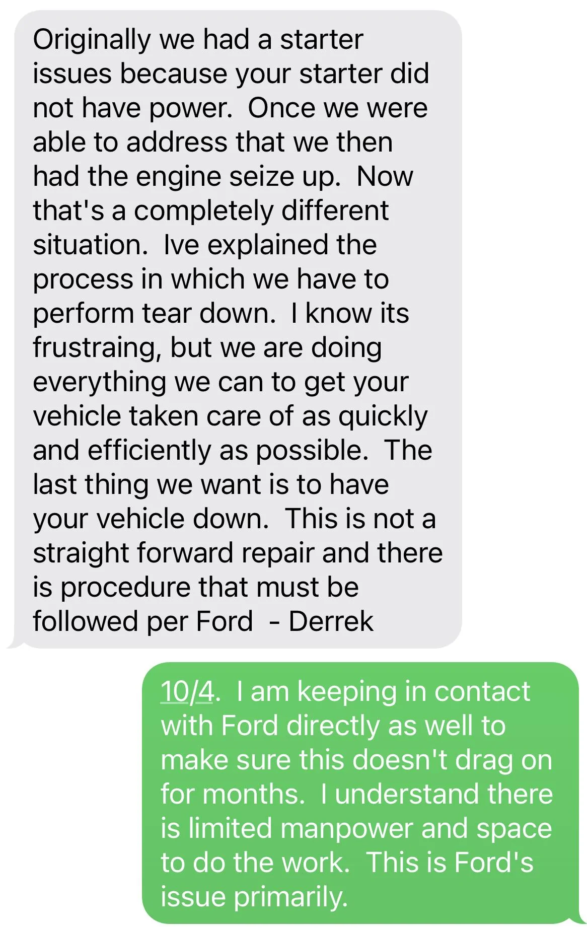

Update 02/20/2022: Turns out there wasn’t an issue with the trans as they originally thought. Engine is froze up and they are now finally going to make the order.
I called Ford customer service and I found out they closed my claim the same day I opened it at the end of January 🤬. Had to open a new claim. No ETA yet on new motor.
