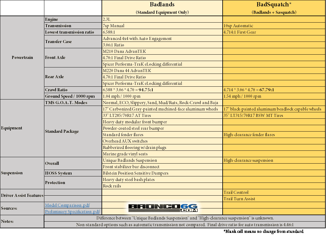

It bugs me when I see the same old "what does Sasquatch get me that Badlands doesn't already have" question followed by lazy, partial, or just plain wrong answers. Here is the answer as simple as I can make it.

Hopefully this helps facilitate a very specific discussion for those of us that are reserving the Badlands model with the knowledge that we will have to choose between manual and Sasquatch (I hope this changes and becomes a non-issue!).
My take on the subject overall is that Badlands gets you one hell of an off road deal without spending another dime. It is actually SO GOOD that I am seriously getting comfortable with the idea that I really don't need to add Sasquatch onto my Badlands - if I decide the manual is my preferred transmission. If the automatic is my preferred transmission - then no brainer, BadSquatch it is. I would be fine rollin' on 33s til they wear out and evaluate going to 35's at that time.
Remaining questions that I have not seen a good answer for:
  • What is the difference between "Unique Badlands Suspension" and Sasquatch "High Clearance Suspension"?
I'm not sure what's going on with the moderators lately but a similar thread just got combined with another thread that was already 24+ pages long, which makes it hard to focus on a simple topic like this. It'd be great if we can just keep this one short and sweet without contaminating it with a bunch of repeat questions. So please don't delete this / move it if at all possible - and if you have questions or comments, make them educated ones!

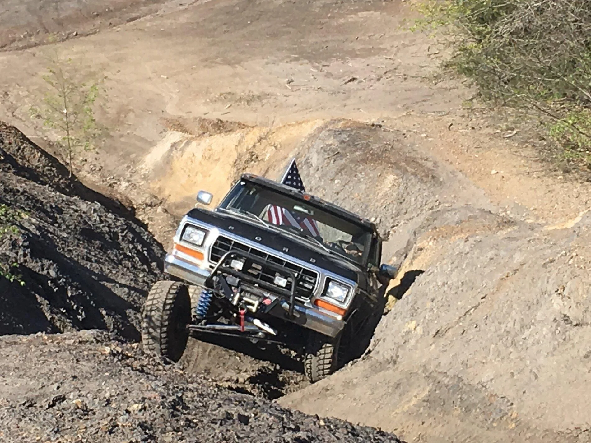

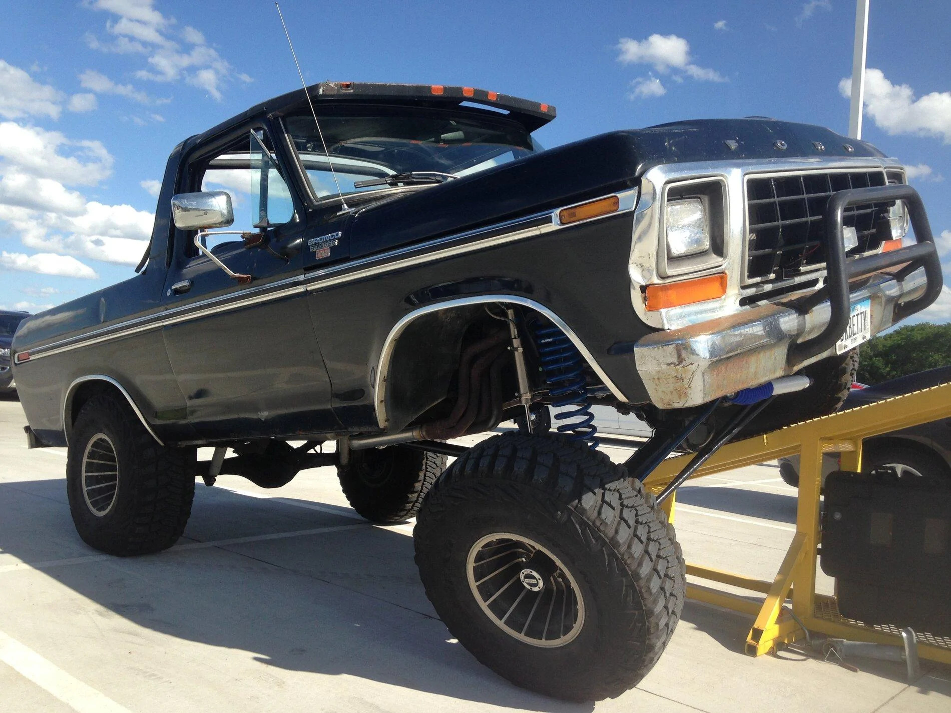

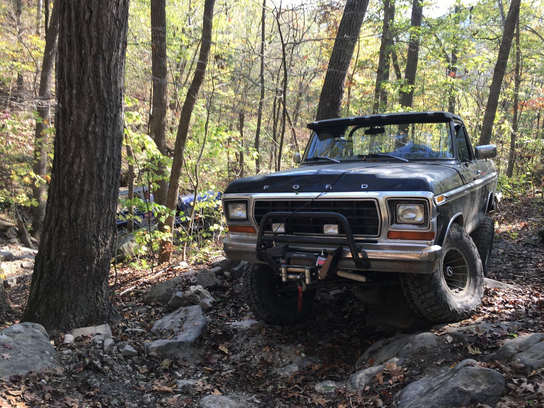

Oh by the way, here's my "real" off road rig so I'm not just blowin' smoke:

As far as the "unique" Badlands vs Sasquatch suspension goes I have to believe it's the availability of the sway bar disconnects in the Badlands that's the determining factor there. Across all the other trims it's base or Sasquatch. The First Edition pretty clearly is based on a Squatched Badlands with some elements of the Wildtrack elsewhere. Having any other hard parts (control arms, etc.) between the base and Squatch used elsewhere to swap out for just the Badlands would kind of odd from a manufacturing perspective. Across all the trims it's pretty clear that the trim above builds on the trim below. There's only a handful of really unique things at each level. The sway bar disconnects being one of those rare things. The slight difference in height between a non-Squatched Badlands and say a Wildtrack or FE is almost entirely explained by the difference in tire height (35 inch tires would cause a roughly 1" difference in height, all other things being equal, than 33's).
That being said, I can't see the Sasquatch being that expensive of a package for the Badlands as it's basically just wheels (tho if they're really forged as I've seen deserve some serious consideration over aftermarket options) tires and flares if you're already planning on stepping up to the 2.7L and auto.
I think you're assessment is right on. For me, it comes down to the 1) final add-on price of the Squatch package and 2) how much my wife feels comfortable driving a manual offroad (she already is an awesome manual driver)
Badlands MSRP = $44,590
Wildtrack MSRP = $48,875
If I assume that Squatch for Badlands <= 1/2 difference from Wildtrack to Badlands that is still $2,142 (don't forget that 10sp tranny cost!!!). I can probably get more accessories, with more overall value to my driving experience for that cash than what Sasquatch can provide.
For example, wife wants hard top - mandatory. There's probably $1,000. Then maybe things like sound deadener, "Mid" package, etc.
A WHOLE lot of fun can be had on 33s with lockers... For a 40k+ vehicle that most people will not use the equipment to their fullest extent, a standard Badlands with 7sp manual makes a lot of sense.

Is it really high clearance suspension? High clearance when compared to the base, however it’s the same coilovers/spring heights when compared to the stock badlands.
I do not have the knowledge to answer that question with certainty but I would not make your assumption.
My assumption would be that a "High Clearance Suspension" is required to adequately clear 35" tires, and therefore, it would be DIFFERENT hardware from the stock Badlands.
Good question. I had thought high clearance meant "small lift" to clear the 35s....and "Special suspension" was the disconnecting sway bars.
So, are we certain the Badlands has the entire Squatch suspension????
If the oem badlands had suspension to clear the 35's but were given the 33 to separate it from the sasquatch pack. After all the 33's match the oem Rubicon tires.
Ford has said nothing the dissuade the notion the Badlands suspension is any different from the sasquatch. In fact it has done the very opposite: Same coilovers, same lockers and differentials.
They are going to want to save money any place possible, using the same suspension on the sasquatch/wildtrak/FE/badlands makes sense and makes the cpa's happy. change out the cheap flares and your done.
If I am wrong, the only difference would be a 1/2inch spacer.
Mike Levin said it was the same coilovers. We also know its the same lockers and differentials. Why would Ford build there supposed Rubicon competitor to be less than the wild tracks?

When I asked our head of Marketing about the 2.3L/ Manual and the larger tires he replied....
"Phil,
You cannot get 35’s with a manual - period.
My comment was that you can get a Badlands with 33” tires.
Badlands has stabilizer bar disconnect that is not available on any other series. And also comes standard with front and rear locking differentials.
The closest you will get to a manual with 35’s is a Badlands, good news is you can get Badlands in base equipment group with vinyl seats and wash out floor."
So I am thinking the ride height is simply the difference of the tire as mentioned above. What I do know is the Badlands is where it is at!
"Phil,
But they do realize people will add 35's and even 37's to the 2.3 manual setup, right? People also expect the engine tune for the 2.3 to be available in 2021 (or it better be available).
