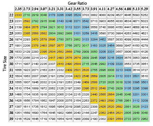

Can we talk a little about the difference between 4.46 gears and 4.7 (i.e. pros and cons).
I am still confused about the main differences. (talking automatic here btw)
Is it mainly that on the lower end, the 4.7 will be able to roll at lower speeds?
The larger the tires, the lower gearing that is required in the axle. They have axle ratio charts to help understand what gears are needed for certain tires. Now each vehicle can be slightly different depending on what transmission and engine they have. The new Jeep JL's have a lower first gear than previous Jeeps so they get by with slightly higher gears with larger tires. Check out this article and maybe it will help you understand.
Ford Bronco Badlands vs. BadSquatch (Badlands + Sasquatch) Comparison Chart FF6A7607-943D-4C30-B13E-ACA1B88A2ECA
https://www.quadratec.com/c/reference/gear-ratio-guide-for-larger-tires

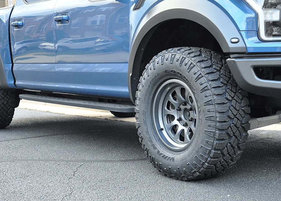

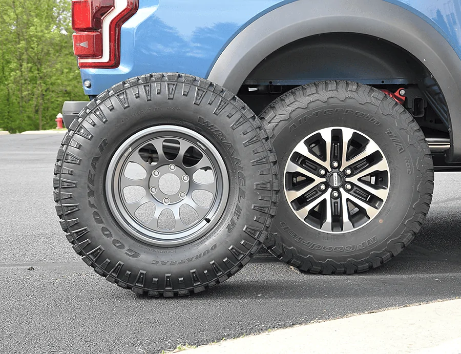

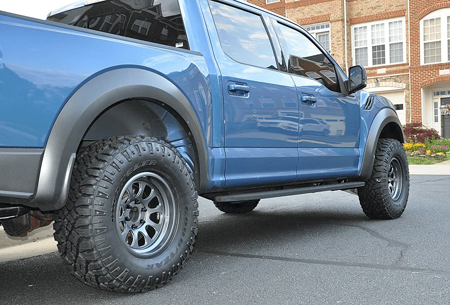

Do you know how many tires Goodyear has the "Wrangler" name attached to? 13 tires >> https://www.tirerack.com/tires/goodyear-tires.jsp
Wrangler is a branding/marketing term which means it has no bearing on the tire itself
For example, most people do not say "wrangler Duratrac" .. they just say GY Duratrac or Duratrac
BTW .. the Duratrac is a great all-around tire. I ran them on my 2013 and my 2019 Raptor
