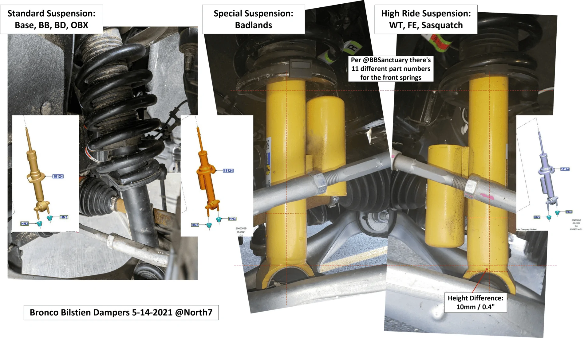

Great videos @MitchellSWatts thank you and welcome to the largest B6G forum on the web. To clarify all the lift difference numbers being thrown around by BN, it is not a 1 1/2" lift between the Wildtrak/Sasquatch and Badlands.
The Wildtrak/Sasquatch "lift" is only .4" taller than the Badlands, entirely due to the shocks. The additional height difference, not lift, comes from the 33" vs the 35" tires, or 1" increase in radius, not accounting for the actual true diameter measurements of the different tires. Other than that the shocks are virtually the same, here is my cheat sheet to explain.
