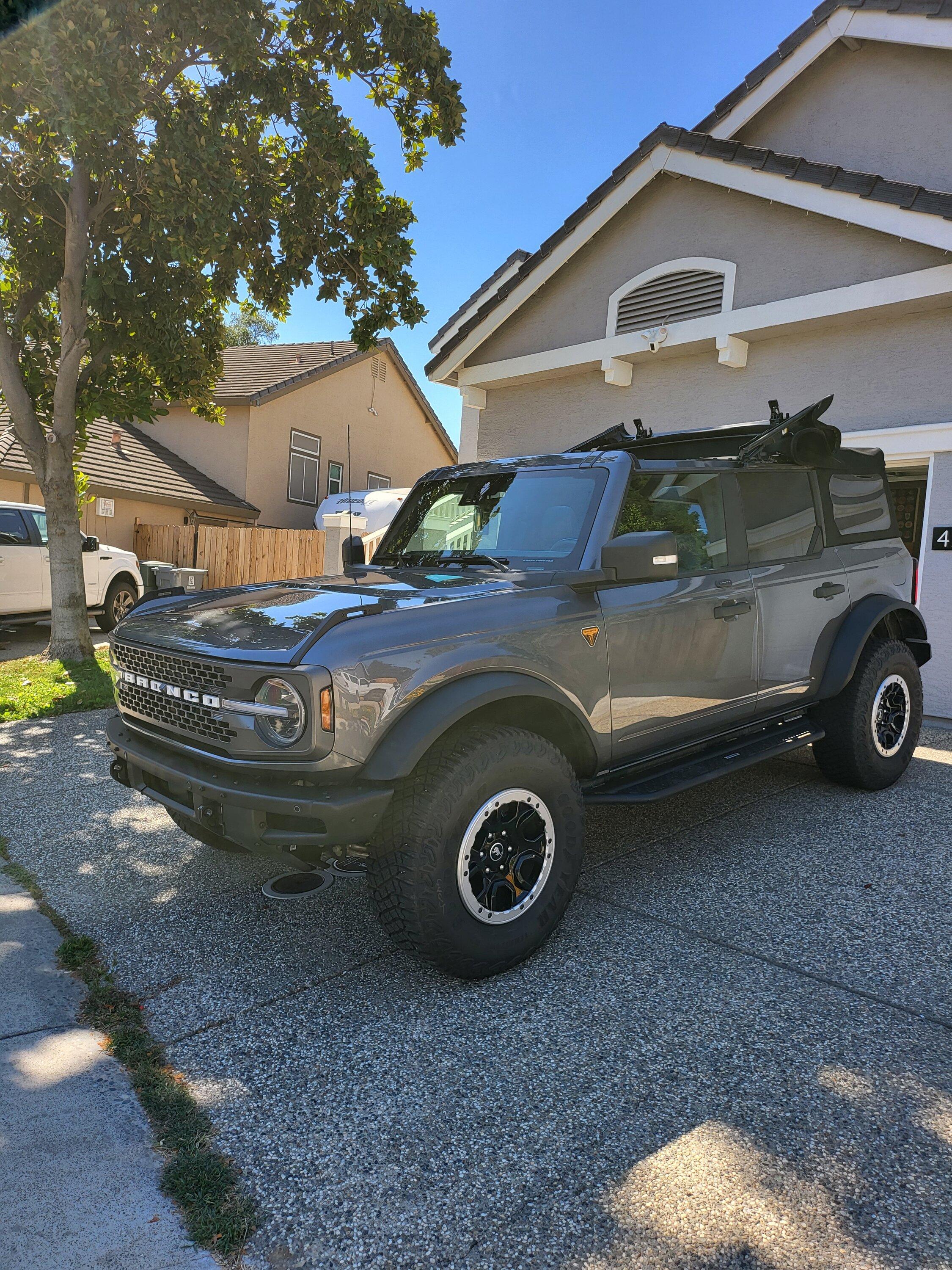

I have a 2021 badlands with sasquach package.
I'd like to level it. I can't find anything in the 2 inch range.
https://fabtechmotorsports.com/product/1-5-leveling-kit-ftl5212/
This is a 1.5 inch leveling kit for this trim.
Has anyone used this kit or do you have any recommendations?
Attached is a pic of my bronco.
Cheers

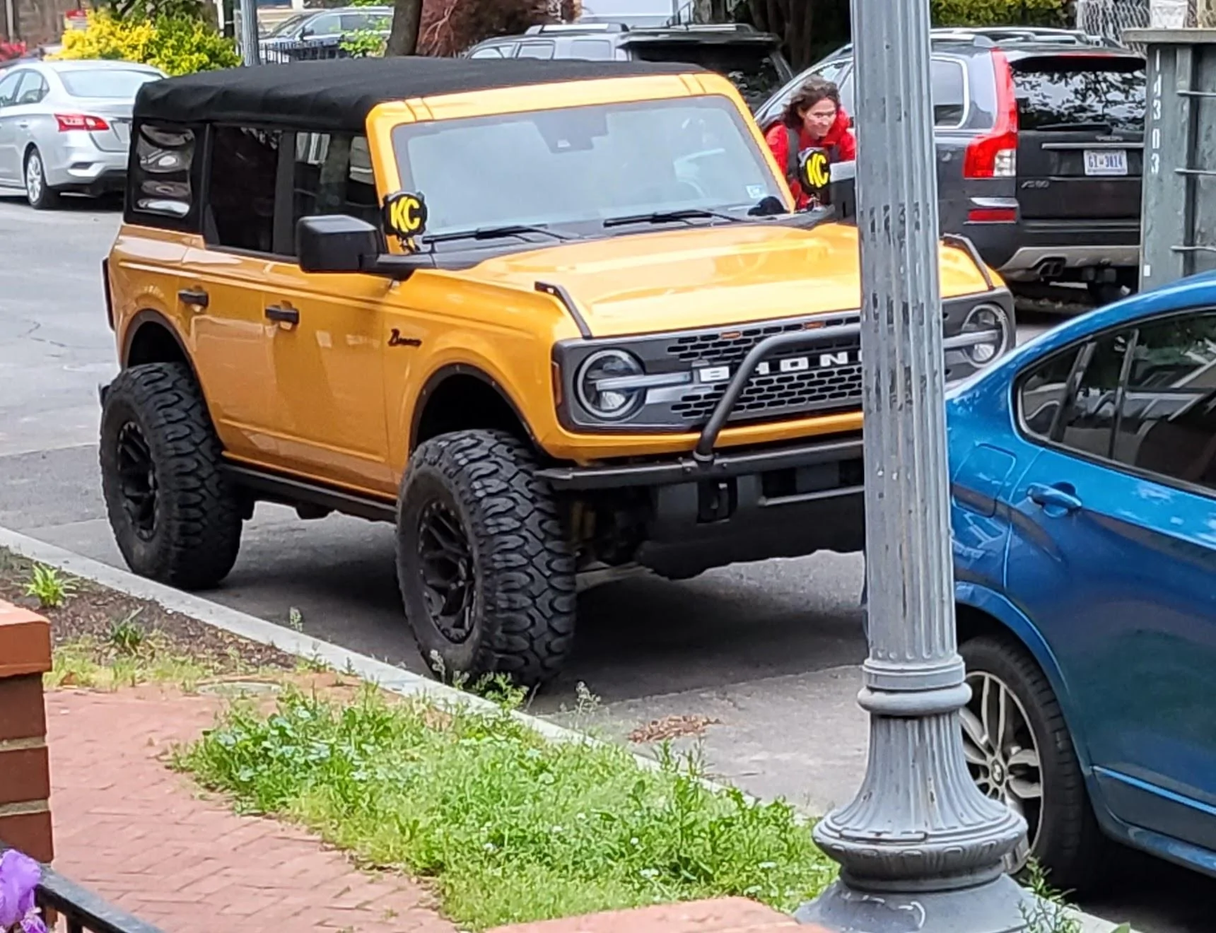

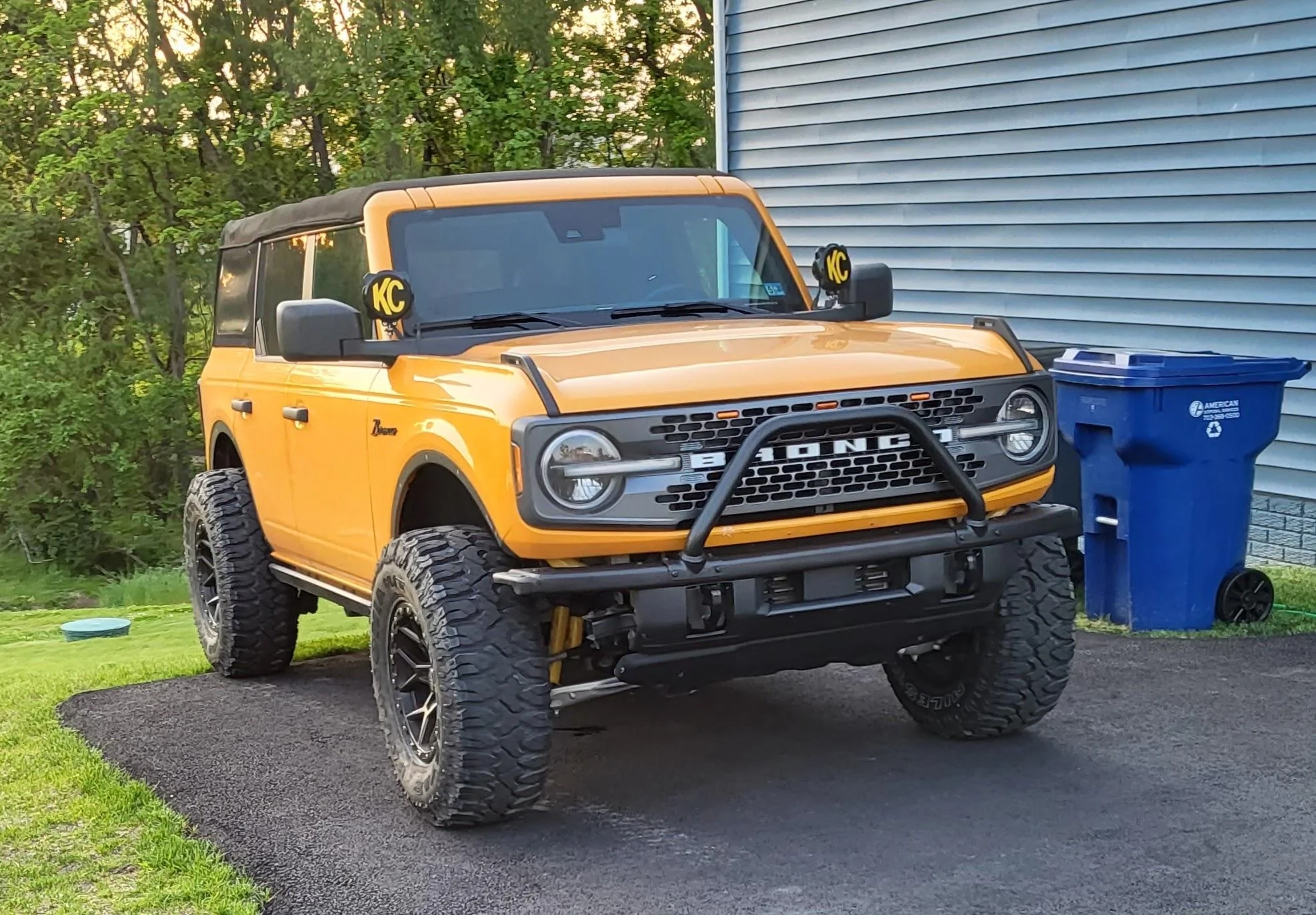

1.25 perch collar in the front is a safer mod. GRTOFFROAD or RPG have kits. Just use the rear perch on the front coilovers.
mine is a non-sas badlands with 35s. Wasn’t on level ground in both photos but it sits perfect.
