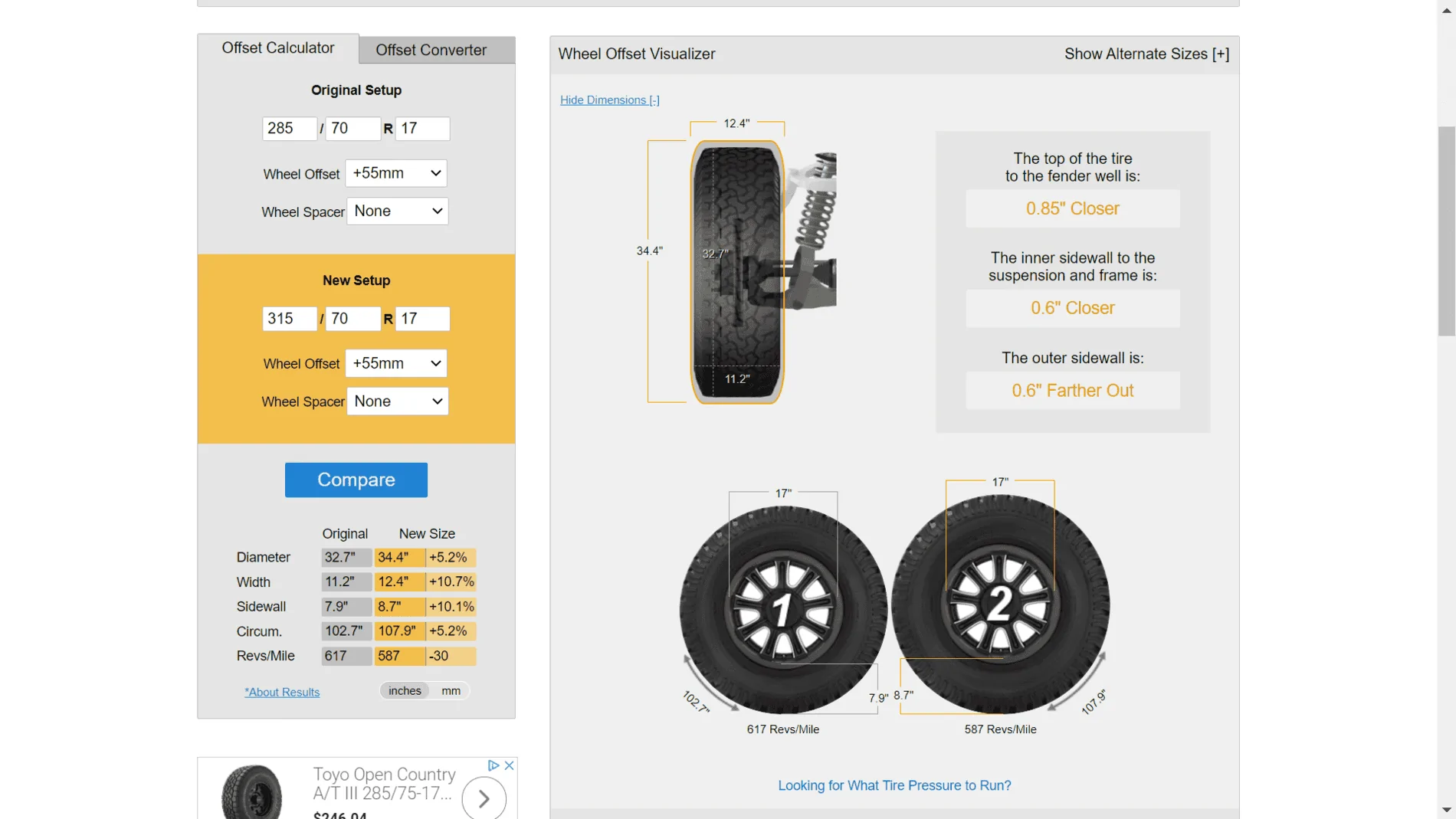

NO, that set up PROBABLY will not fit on the Bronco.
The 315 on a 17 x 8 wheel with 55mm offset may very likely rub the upper control arm. This is why Ford went to a 30mm offset, to push the wheel farther away from the suspension/frame components.

Not only this but you more than likely won't be able to turn to full lock without rubbing the frame. I can tell you from experience that this is a huge pain in the ass when you want to do crazy things like pull into a parking space or pull a u-turn.
