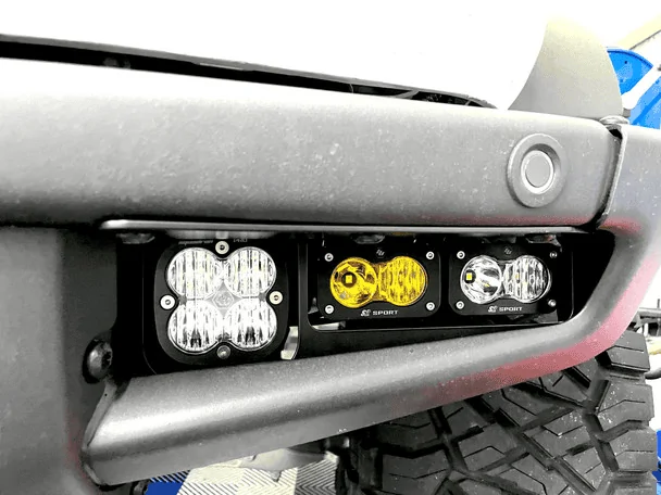

Baja Designs Triple Fog Light Kit w/KR Off-Road Brackets for 2021+ Ford Bronco (HD Modular Bumper)
https://www.4x4truckleds.com/baja-d...ckets-for-2021-ford-bronco-hd-modular-bumper/
Ford Bronco Baja Design lights adjustments 1706667083591
These sit in our KR Off-Road open style bracket. So you can see how they can be aimed up/down/left/right
Baja Designs Triple Fog Light Kit w/KR Off-Road Bezel/Flush Brackets for 2021+ Ford Bronco (HD Modular Bumper)
Ford Bronco Baja Design lights adjustments 1706667117561
Now our KR Off-Road Flush Bezels are designed off the original Baja Designs version (but ours work with different manufacturers and install with less hardware). They still allow you to move the lights up/down/left right as well depending on how you seat the lights.

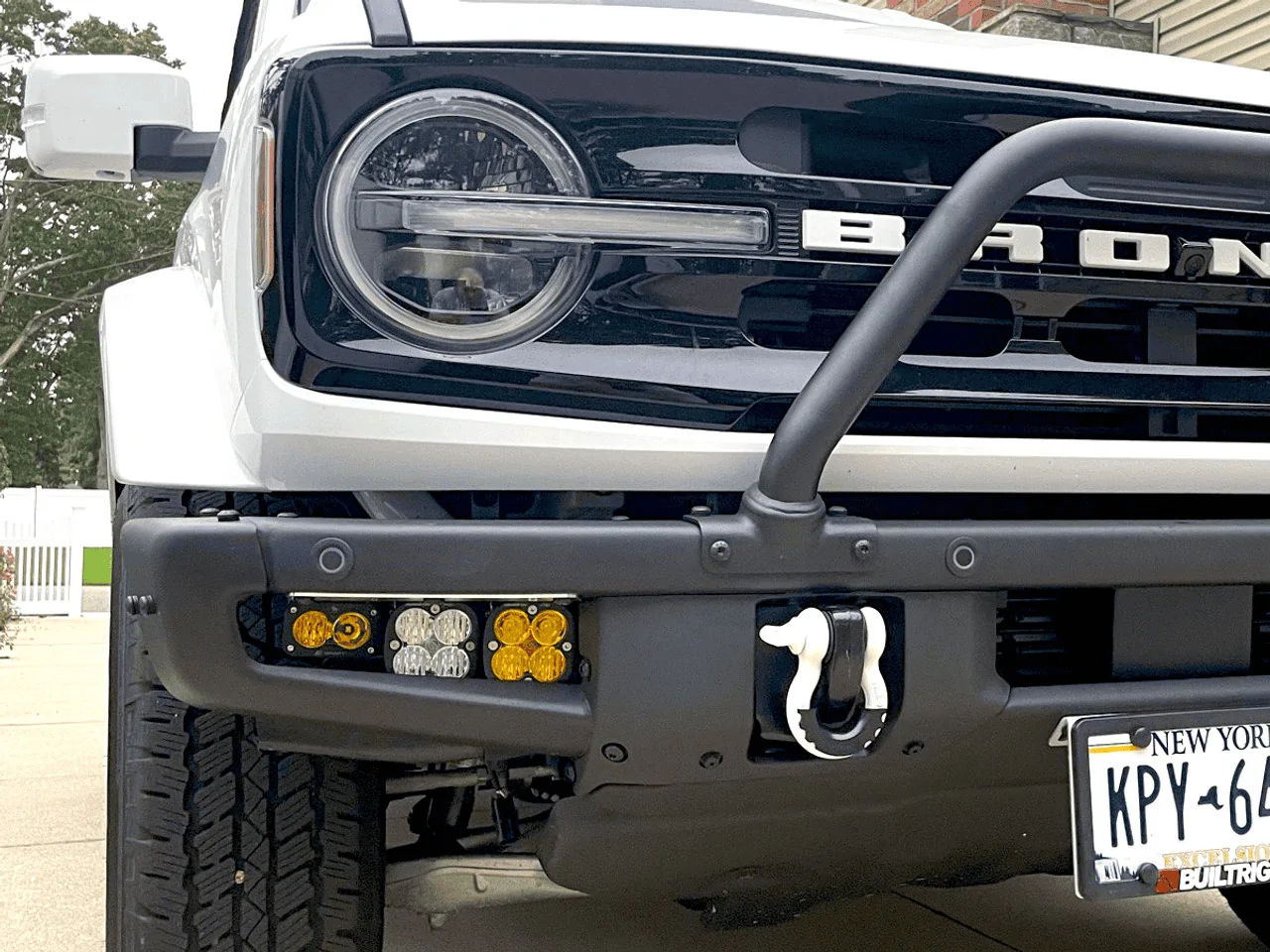

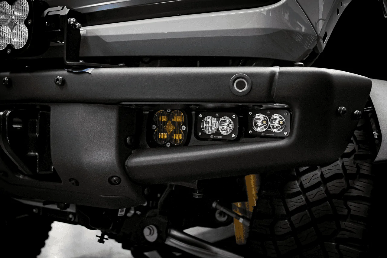

Baja Designs Fog Pocket Kit for 2021+ Ford Bronco (Modular Bumper)
https://www.4x4truckleds.com/baja-designs-fog-pocket-kit-for-2021-ford-bronco-modular-bumper/
Ford Bronco Baja Design lights adjustments 1706667178290
This is the original Baja Designs kit, which gives you 4 different lighting options. They have a stepped appraoch but still allow you to aim them up/down/left/right depending on how you situate the lights/brackets. But still complete adjustability.

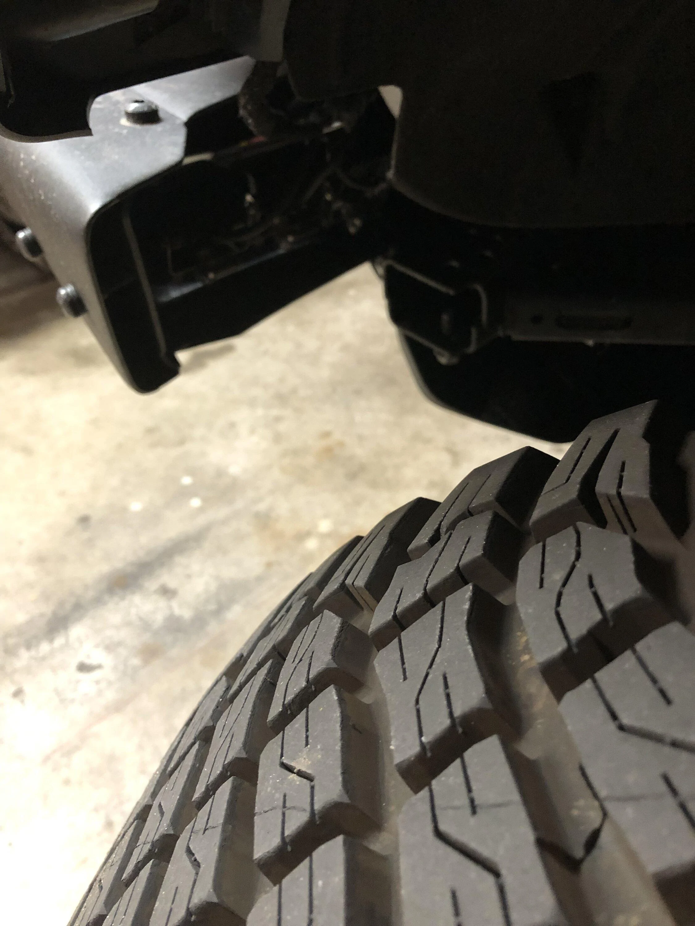

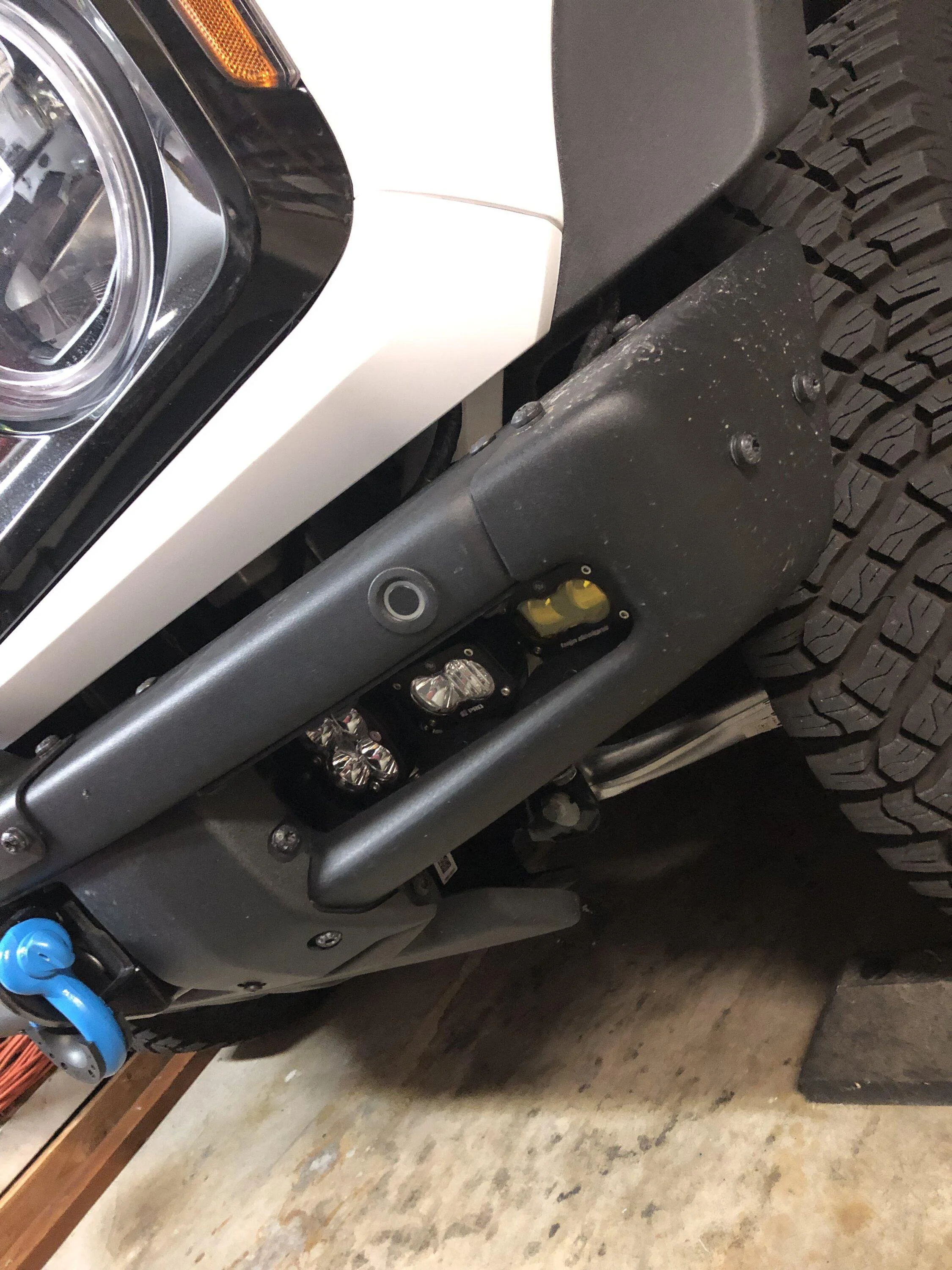

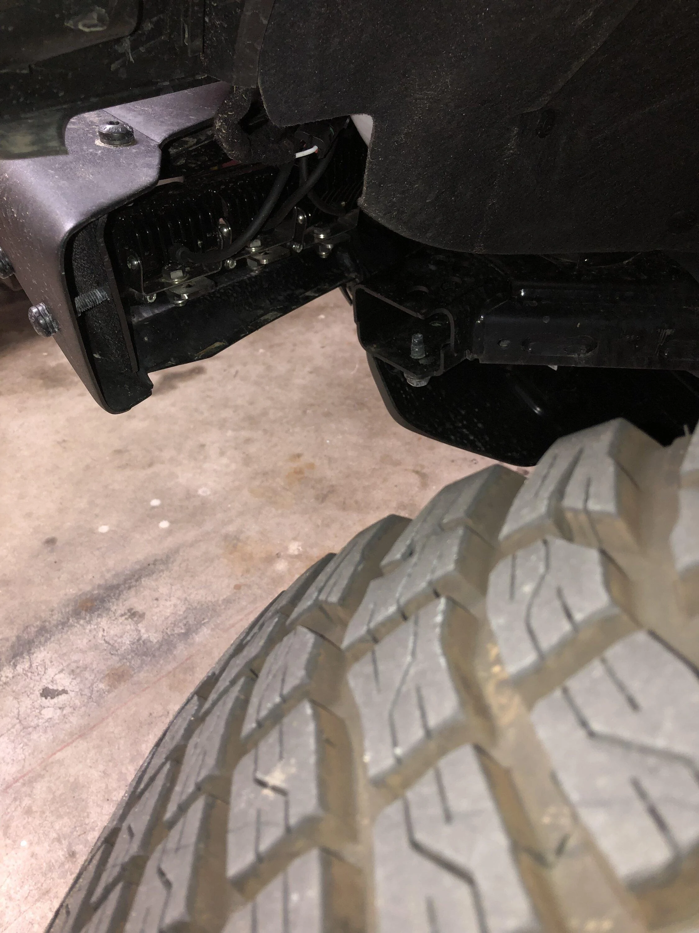

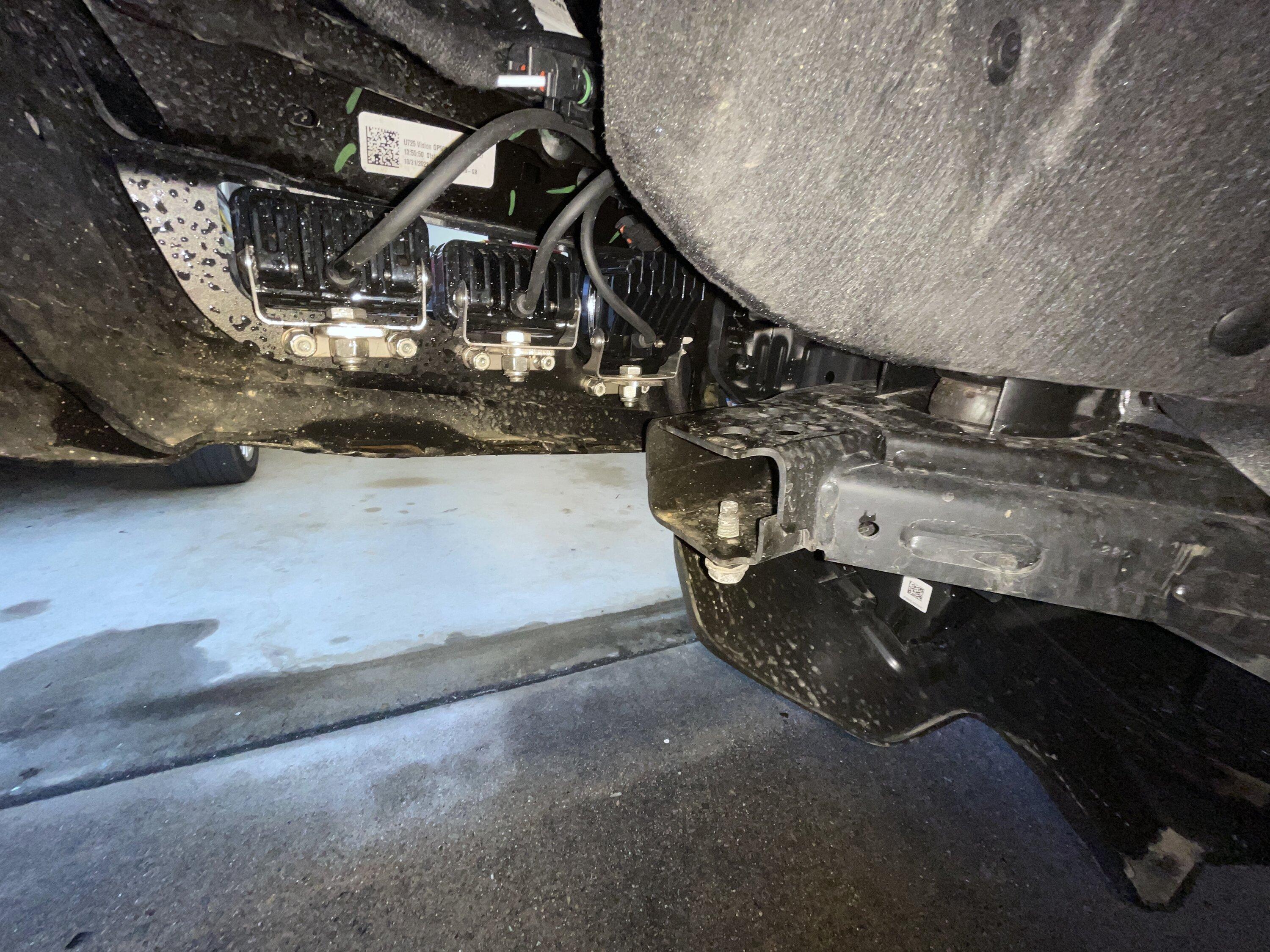

I've attached a picture of the invoice to show the unit and a picture of the of the back of the drivers side.

Sooo you can most definitely adjust those up/down/left/right. So that's a concern they told you that you cannot. They simply don't want to take the time to adjust them for you.
Another concern is the price... that kit retails for $1,279.95 but they charged you $1,284.95. Okay so they added a bit to it. $5 isn't anything worth making a fuss over, just WEIRD. Can you show us a better photo straight on up close of the 3 lights. I want to double check that they actually installed the right lights for you as well since we're chatting here.
Looks like they charged you $360 to install it and then $75 to wire it up? Do you have factory upfitter switches? They got $75 to crimp 2 wires on which takes 60 seconds to do? So a total of $435 for labor on top of charging you more then the product sells for?
We charge $200 to install fog kits to keep it in perspective. $300 if you do not have upfitter switches (because we have to mount switches on the dash).
Do you have upfitter switches? If so you should not have paid $435 for labor, unless that's just the going rate out there in San Diego, CA where I know things are expensive. But our shop is here on Long Island where rates are high also. I'm pretty low at $200-$300 but other shops might be around $300-$400. Bu still... that's on the VERY HIGH end for labor, especially since they are claiming you cannot adjust them. For what you paid they should be more then happy to adjust them for you.

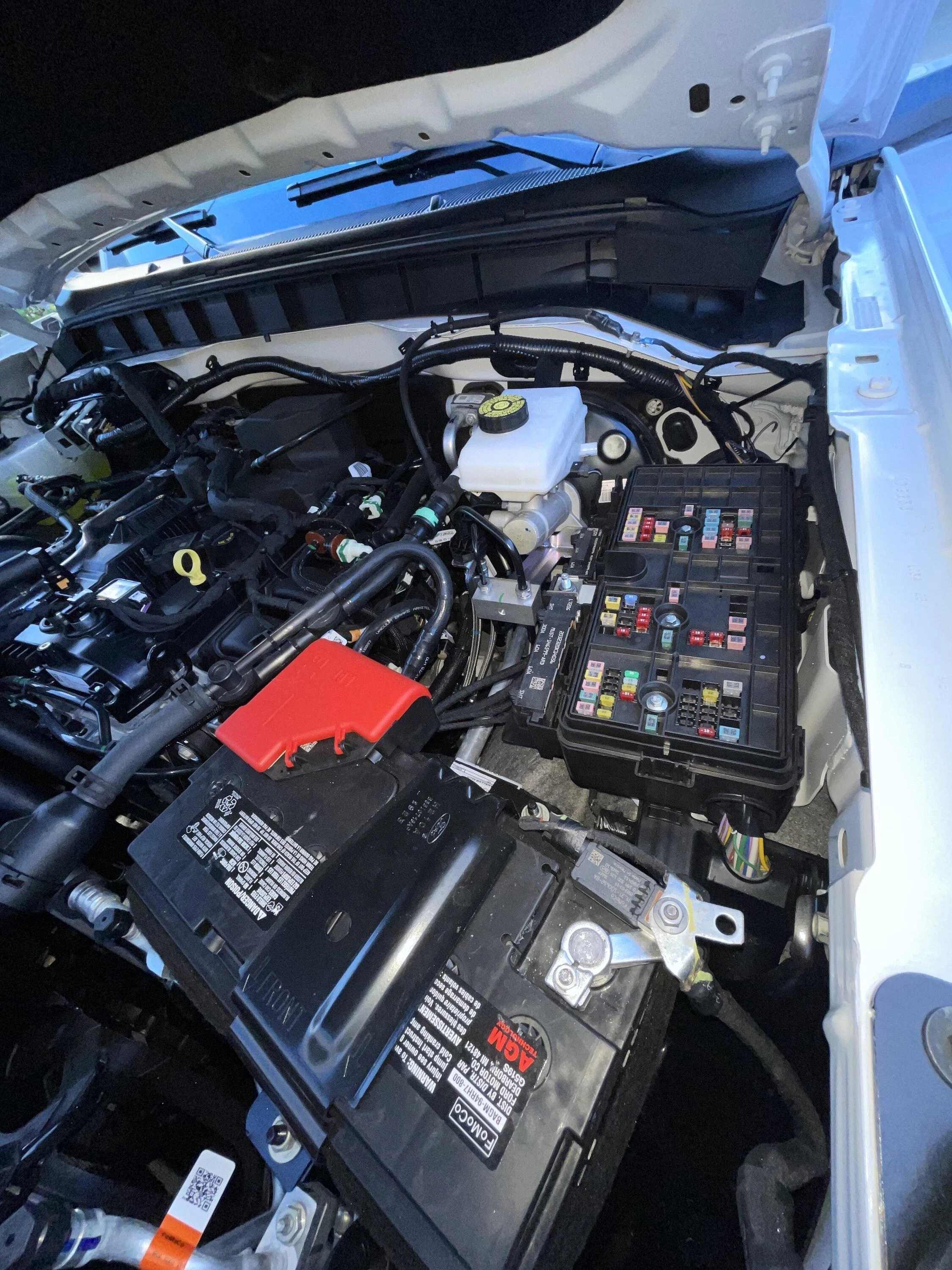

Can you show us a photo of the wiring inside. Again that's just a professional curiosity of mine. I've seen some local shops here butcher an install. Just show us a photo of the driver side firewall area where the upfitter wires are (north of the battery, against the firewall is where the wire bundle is)
The lights have a gap around them for a reason, so that you can move them up/down/left/right

It sounds like the shop took advantage of my age and didn't give me a reasonable financial deal and a quality install so thanks for opening my eyes.
I do have the Upfitter Switches and used #1 for the two driving light and #2 for the amber light. The wiring install looked clean and I've included the best picture I had. I've also included a hopefully better picture of the back of the lights. On closer examination it does look like the just didn't want to adjust properly. I was going to adjust myself but I don't want to let them off this easy for not treating me fairly. I thank all of you for your knowledge and suggestions.
