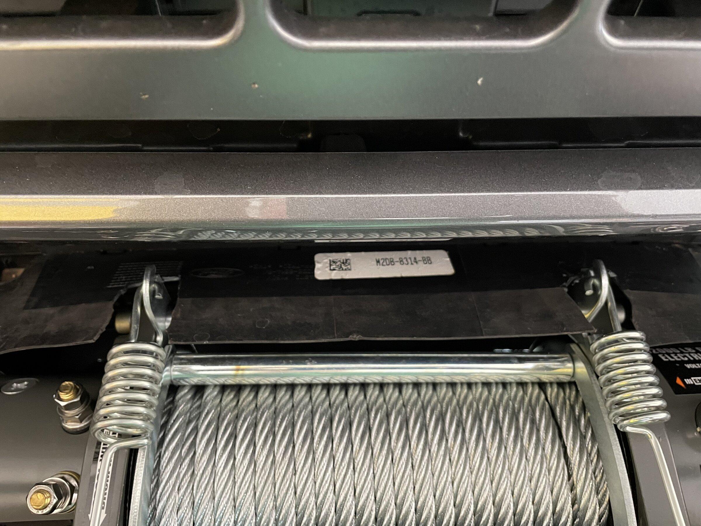

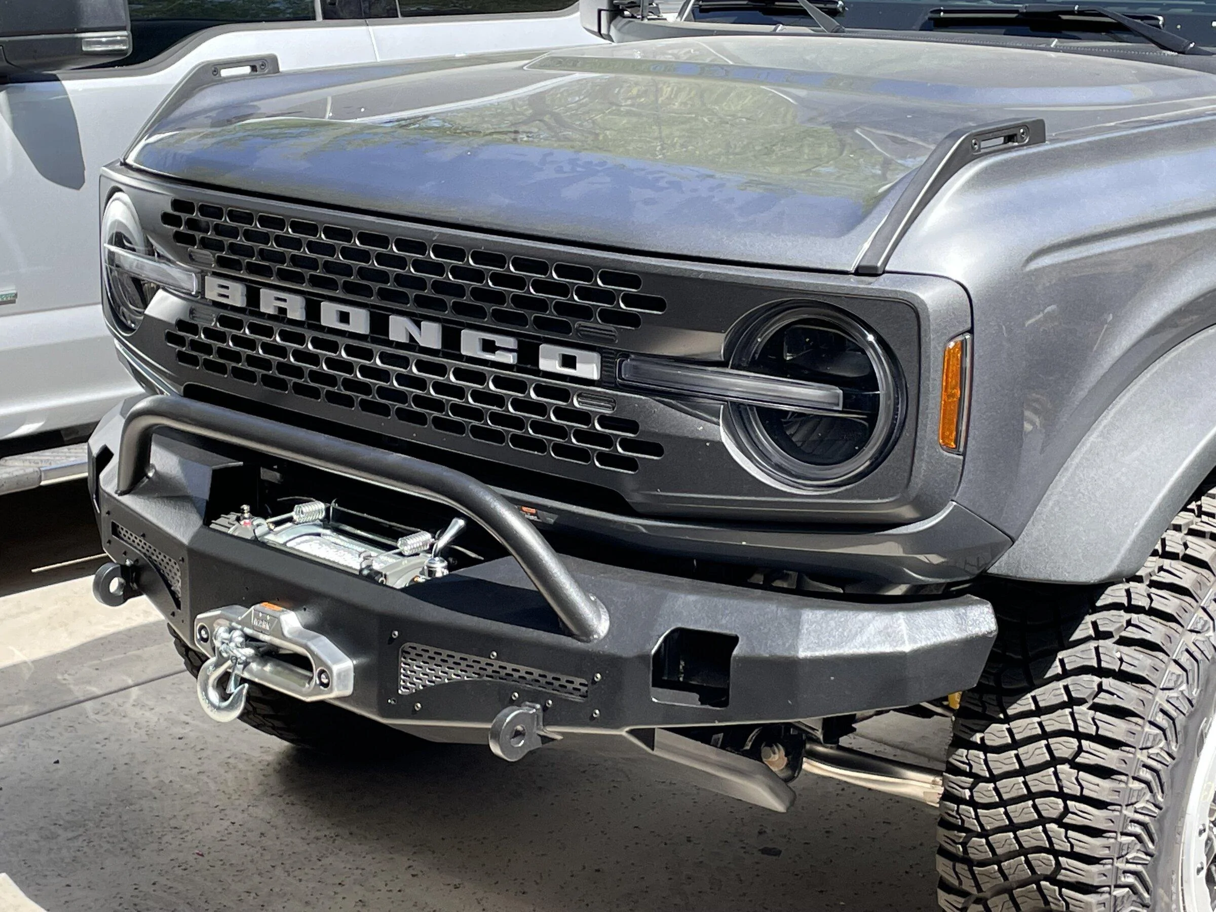

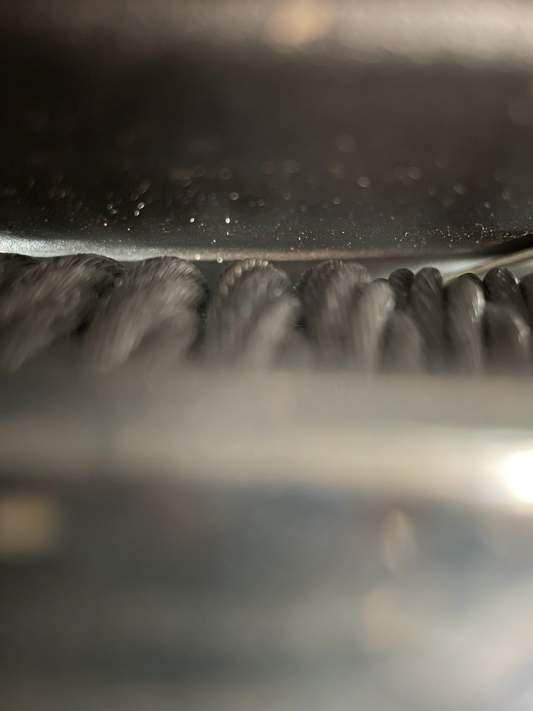

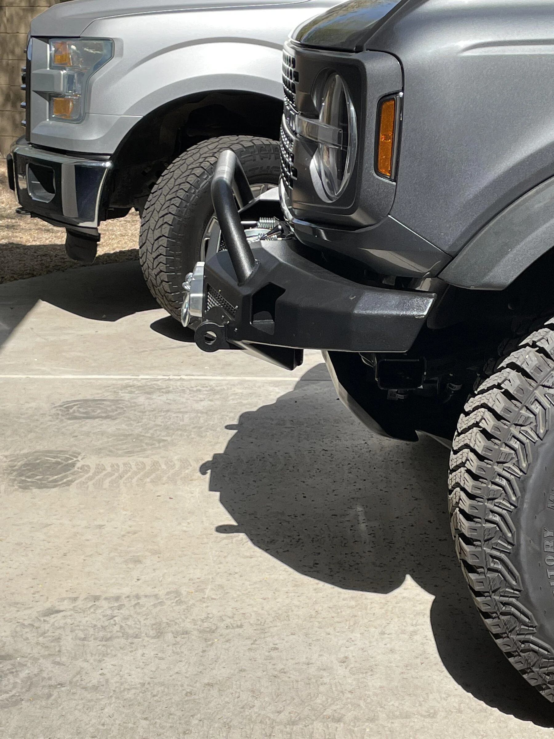

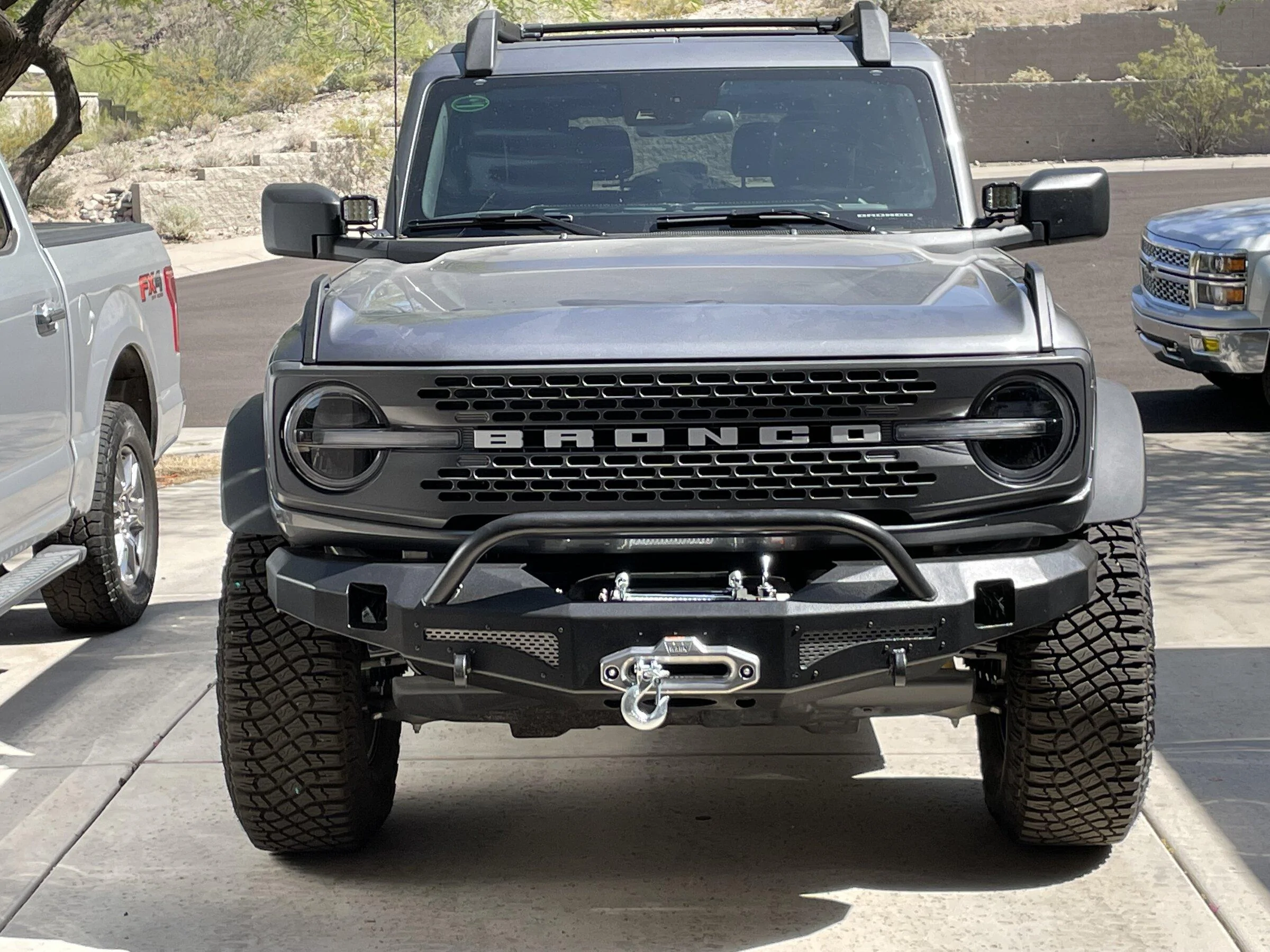

@BAMF Was able to get the bumper installed today. Absolutely dig the way it came out. Bolted in a 12k Badlands Harbor Freight winch that I’ve had sitting in the garage for a few years. I mention this just to show what a tight fit everything is. That’s the reason I went with BAMF and I’m glad I did. I’ll get around to switching out the cable for rope and get lights installed.

Had to do I bit of trimming

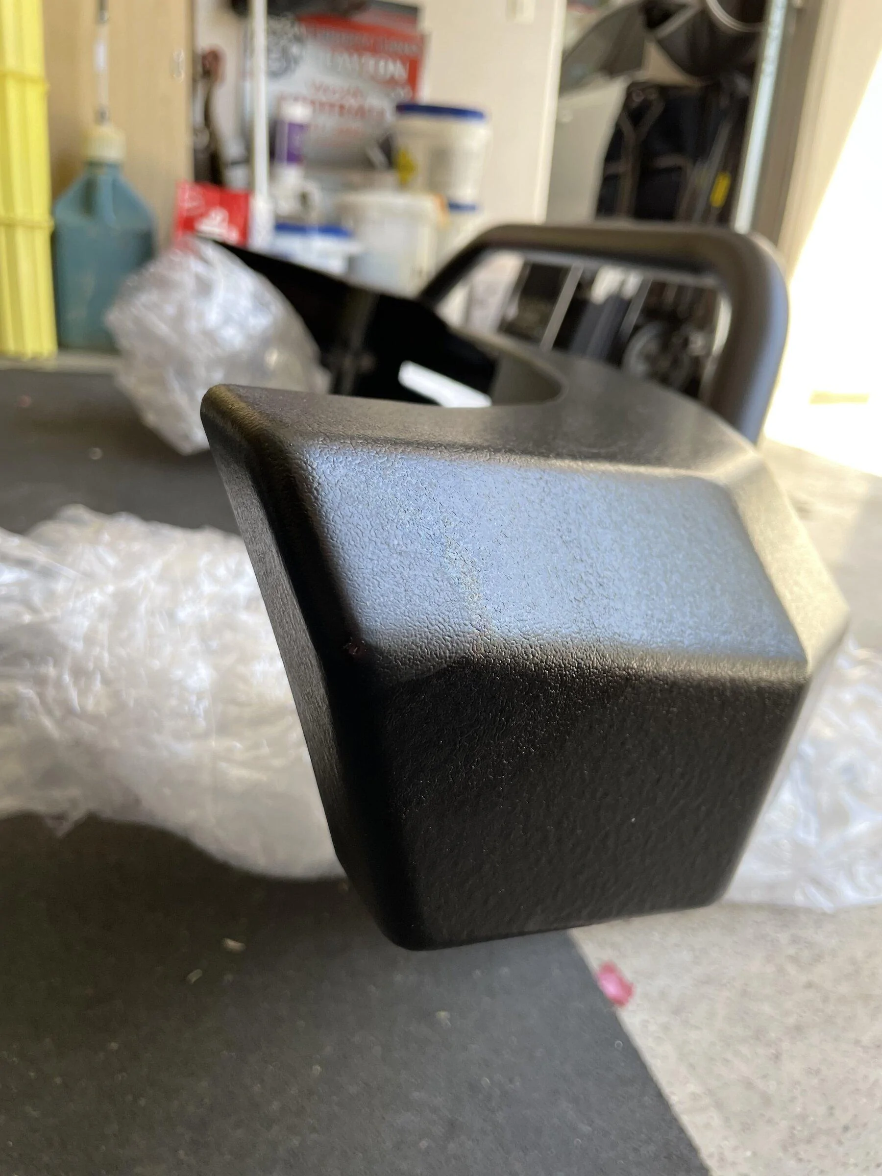

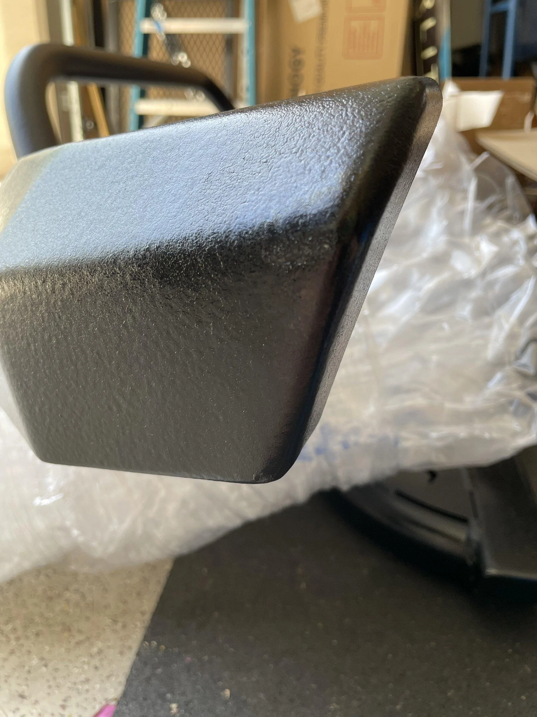

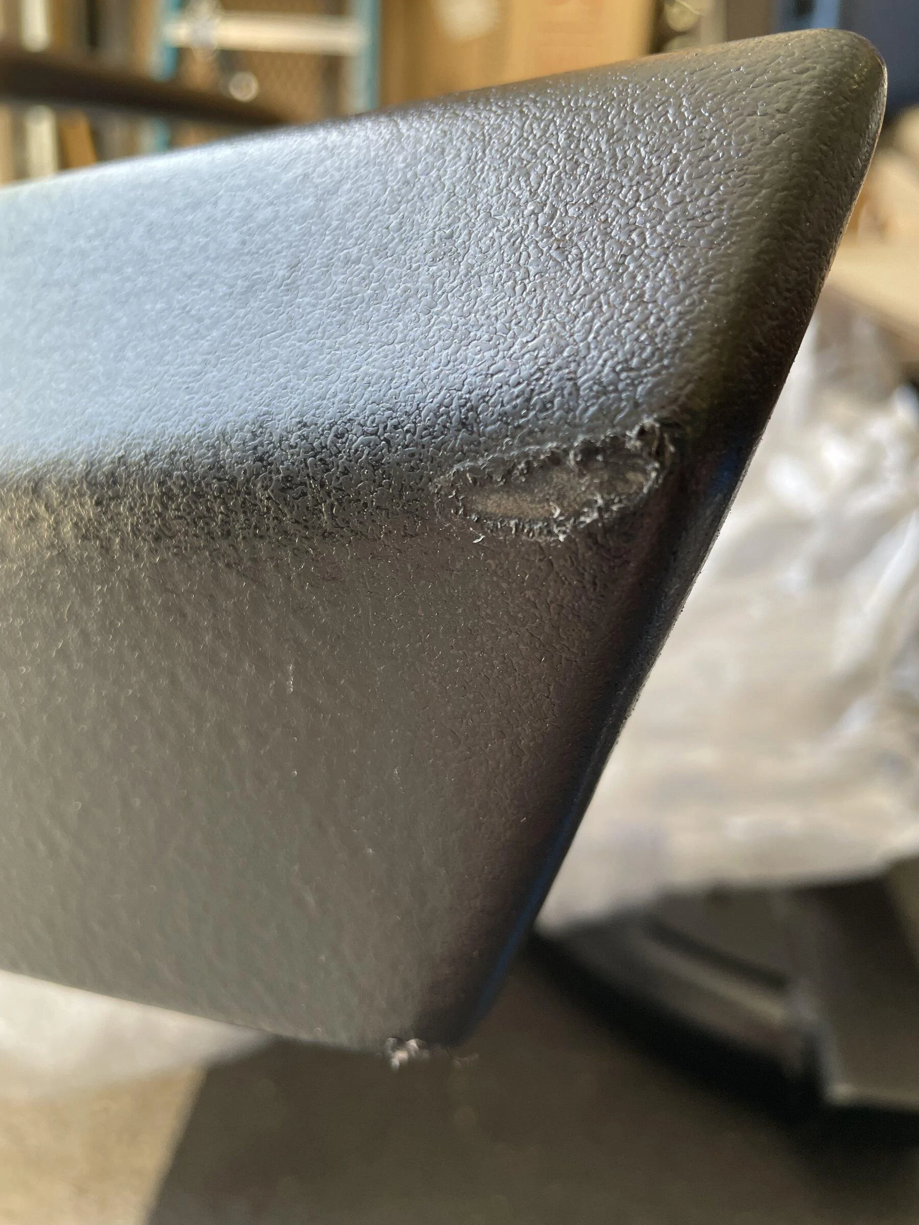

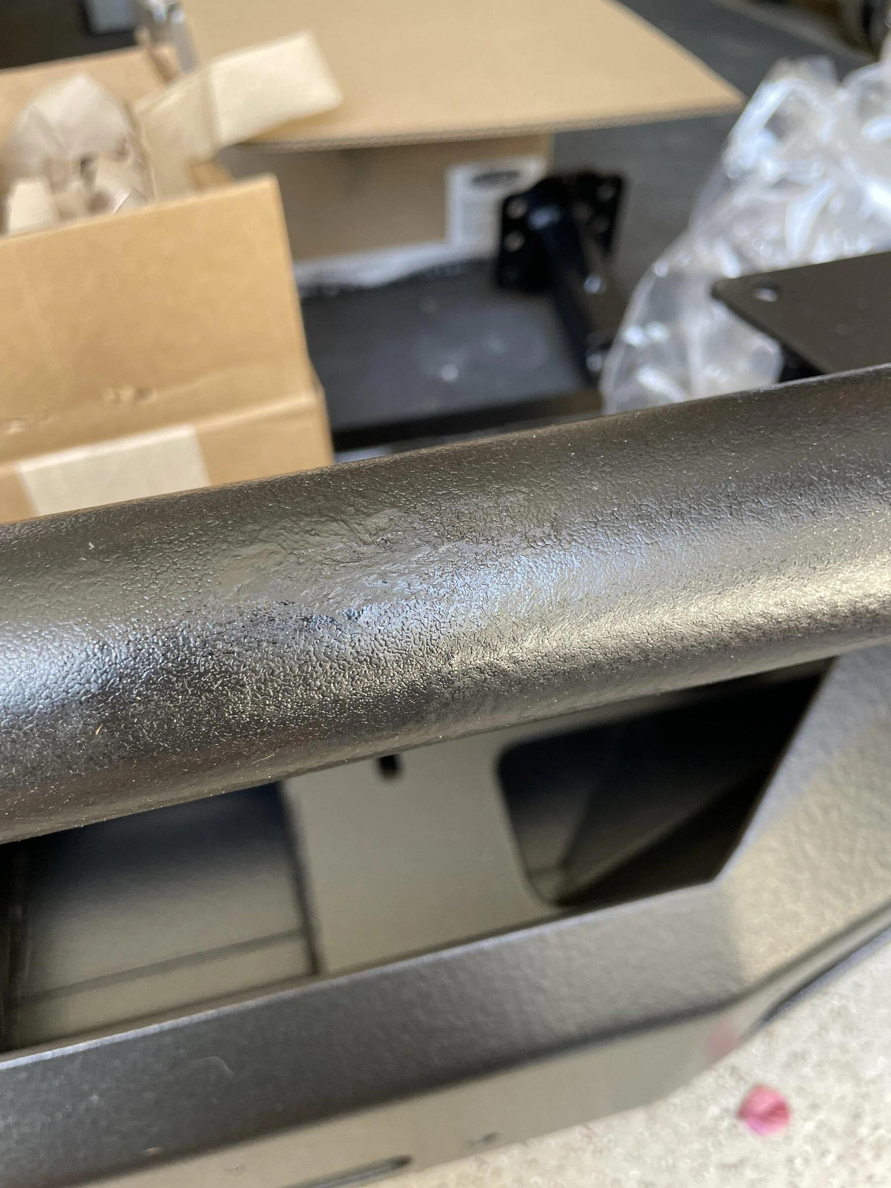

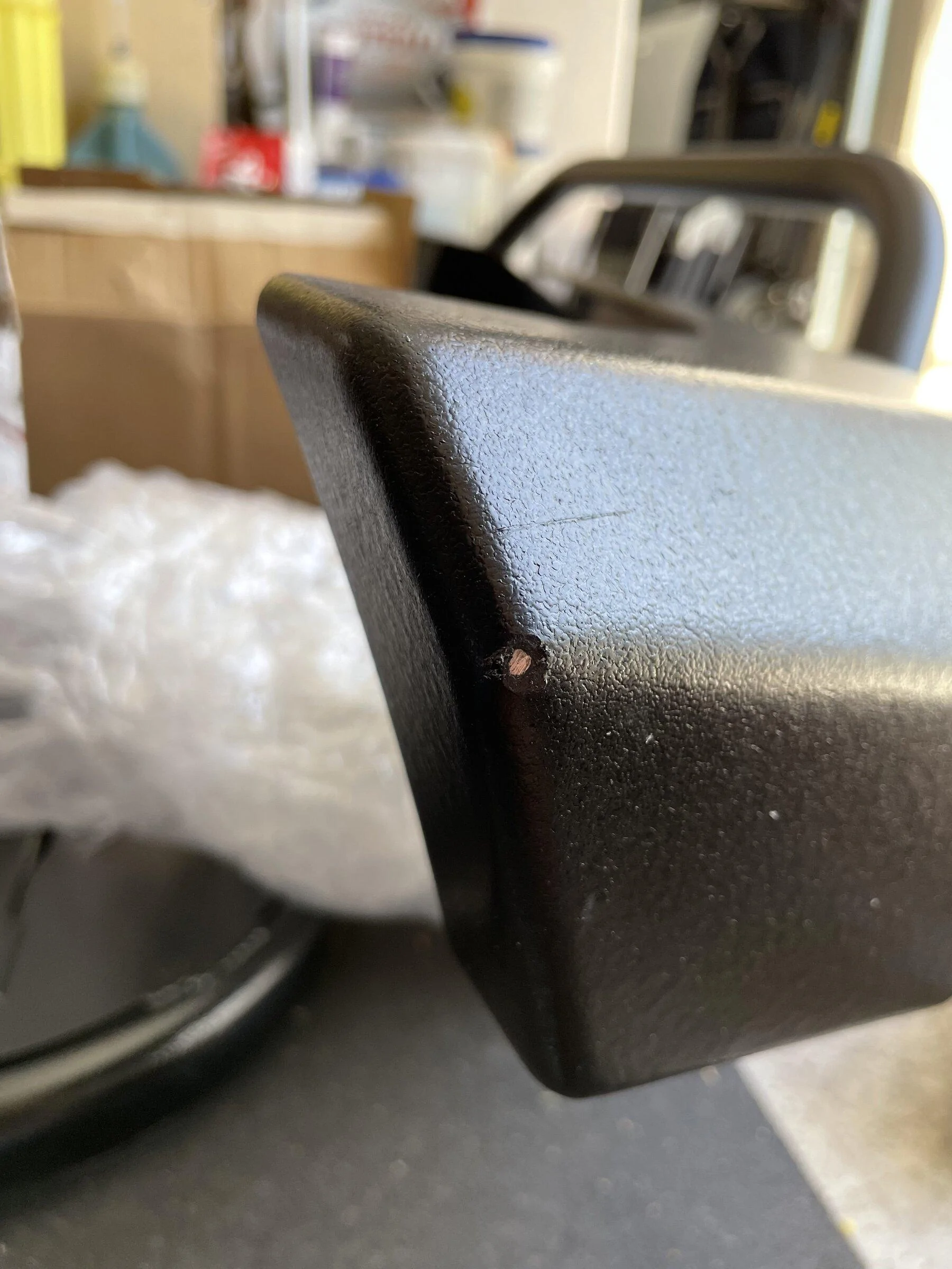

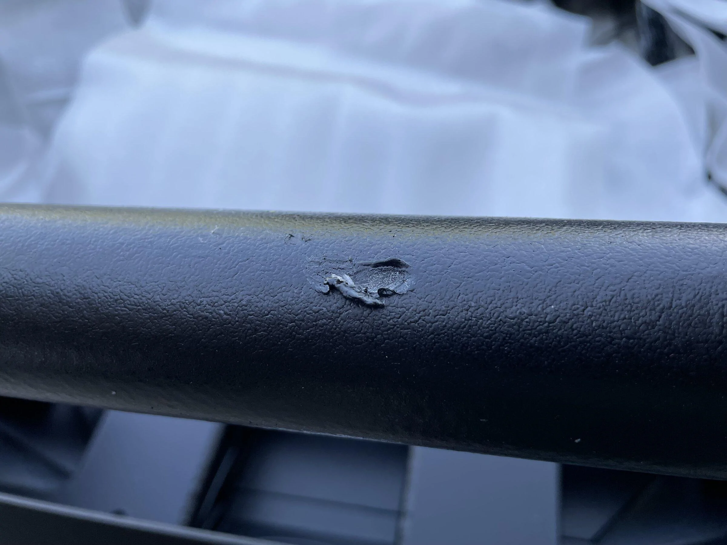

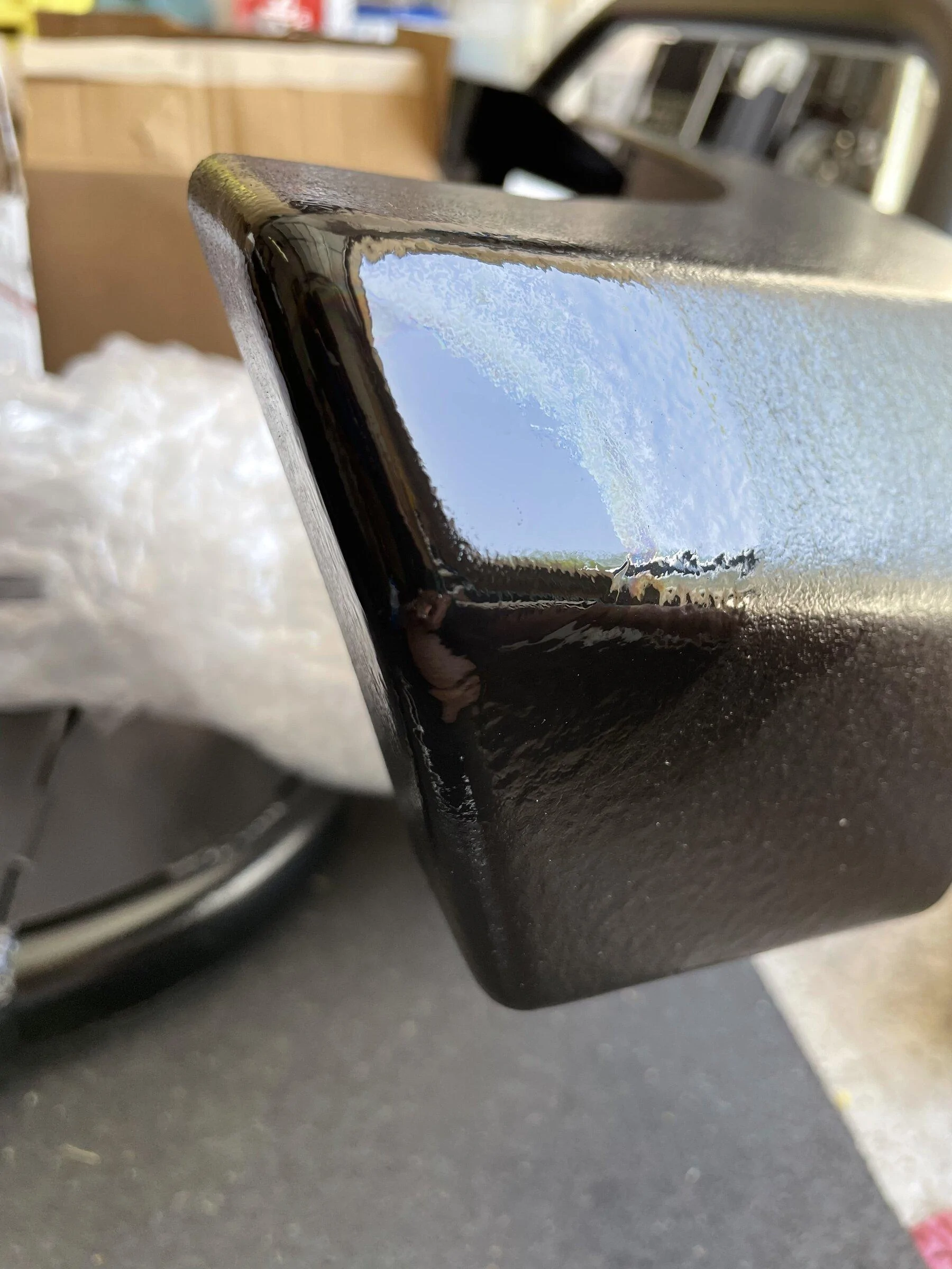

Powdercoating is super cool. There were some dings from shipping although the bumper was wrapped up well. Opened up and had a couple “ahh damn” moments. Put some heat to it and watched it melt together. The spot on the bull bar required some massaging, but all is good.

Looks awesome! Sorry about the shipping abuse we try to wrap them to survive the trip but these guys have gotten bad over the last few years.
The main reason we use the field reparable powder it's awesome to be able to fix little nicks and scratches with fire!
