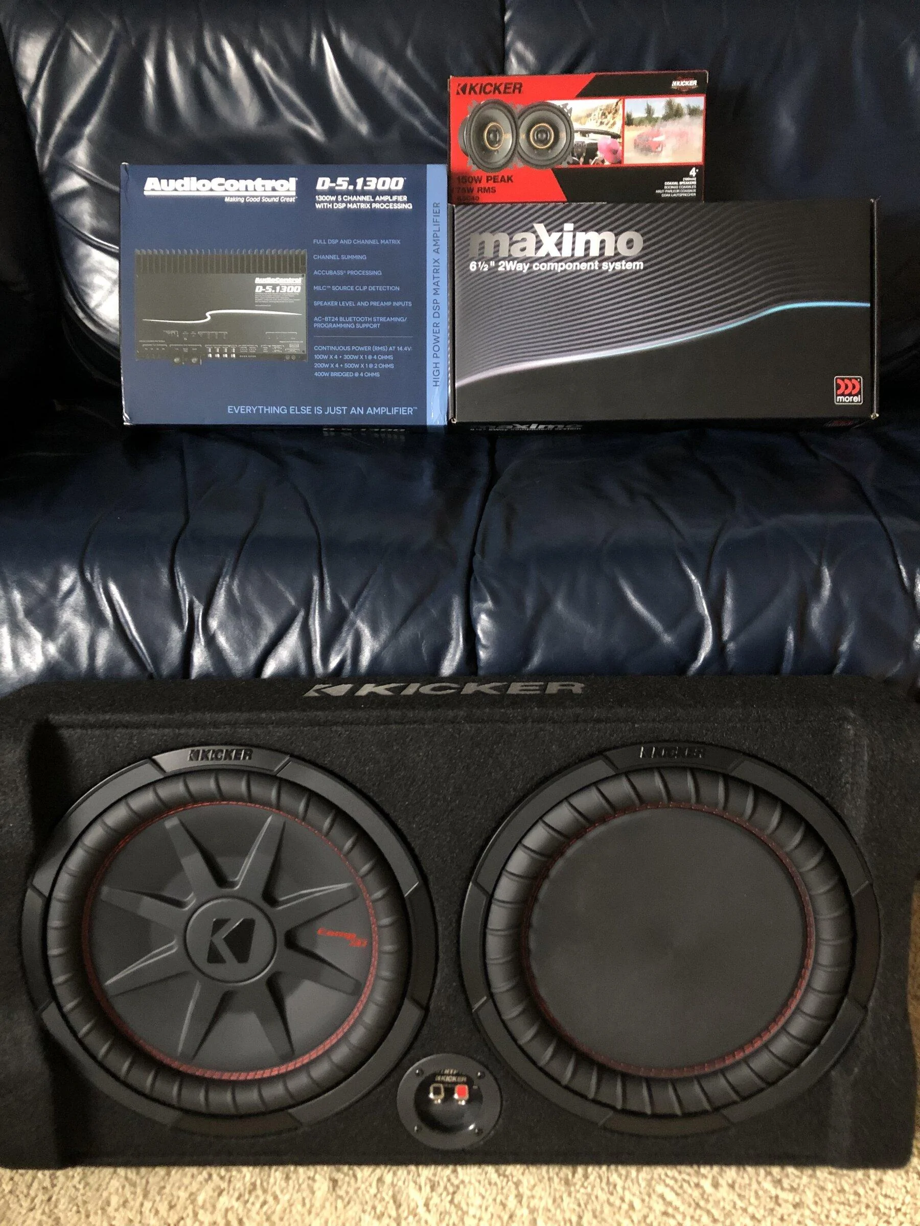

If you are curious, here are the components I chose after a lot of thinking about my requirements:
Ford Bronco Base Audio System Upgrade - Amp Configuration? IMG_2776
I am going to run 5 channels with a integrated DSP for simplicity, power and sound quality. The Morels will replace the factory 4" and 6.5" in the front and the kicker 4" are just for some fill in the back. 12" sub for the lows. Hope this helps.

I'll do a write up once I have time to get it installed. It met my 2 requirements - DSP (to correct the factory signal, control crossovers, time alignment, custom program different profiles, etc.) and enough power to still have good sound with the top down at highway speed.
Overkill? Maybe, but I'd rather turn things down and have it operating at less than max capacity instead of pushing a smaller amp to its max all the time.
