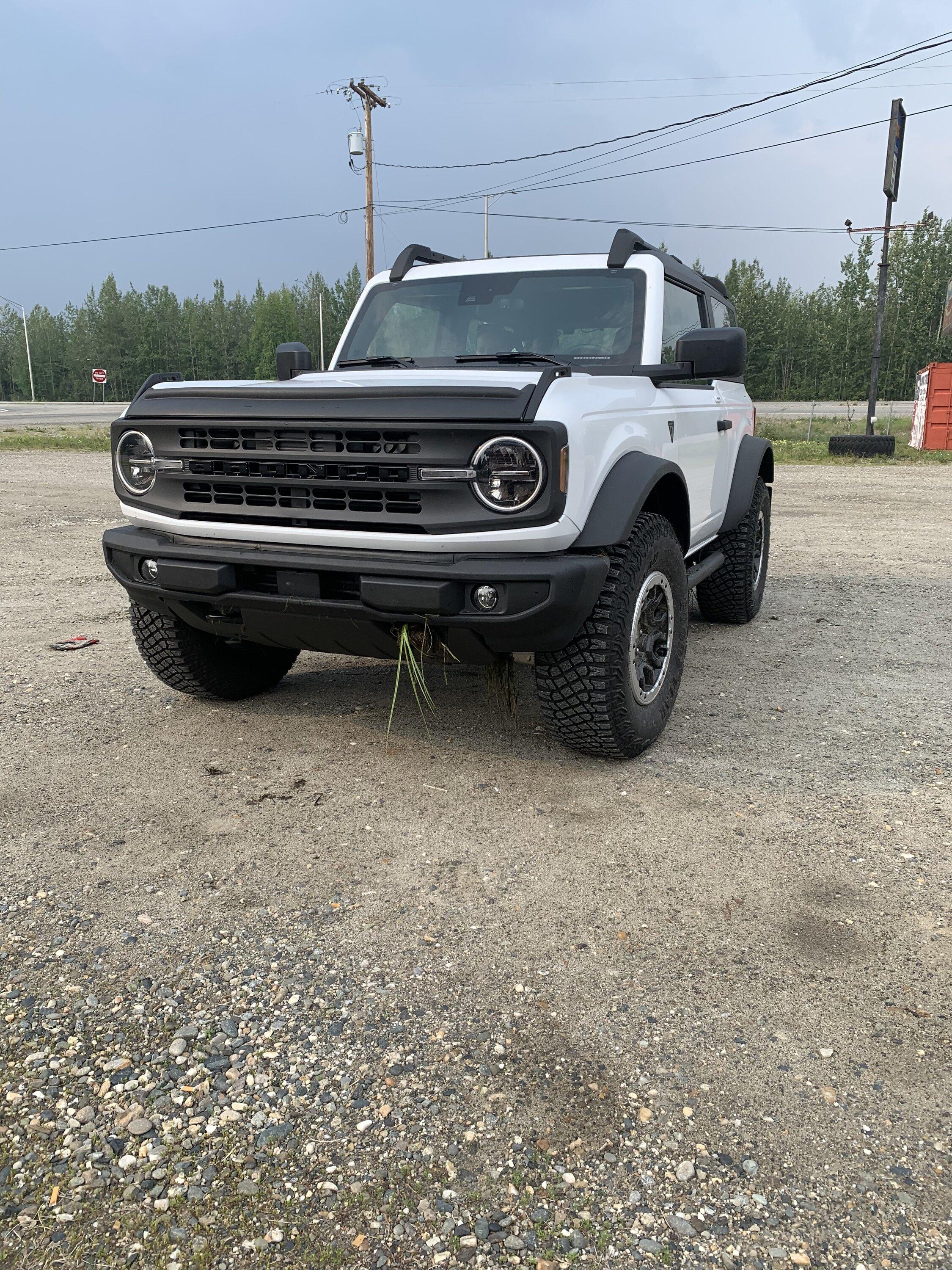

Should be M2DZ-17E811-DA (left) and M2DZ-17E810-DA (right).
FWIW I didn’t want to spend $100+ and just used a hole saw and deburring tool. The blank panels will be a dime a dozen eventually.

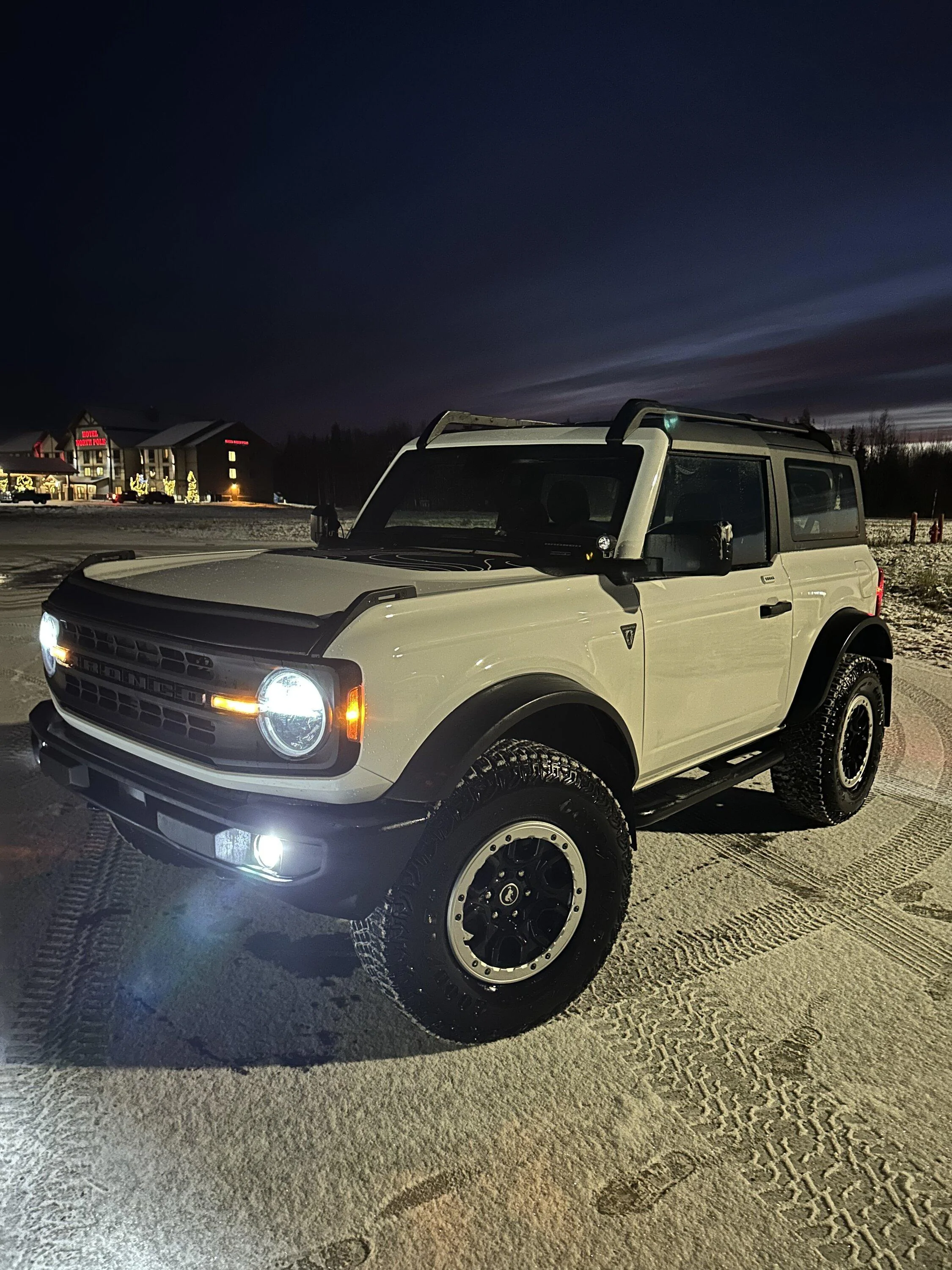

They’re Knockoffs from Amazon. I put leds in with a generic h11 harness hooked up to an aux switch. They stay on pretty much all the time.
