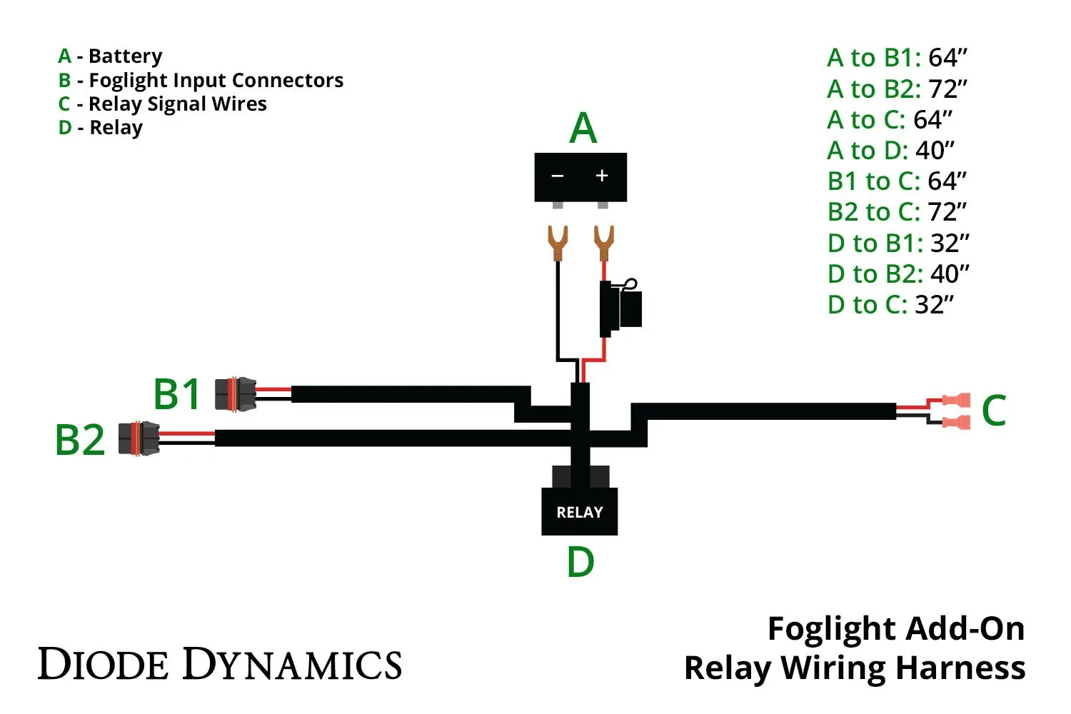

A bigger question is what is the best way to wire it. The Base does not come with the fog lights button/switch, but I am wondering if it is already pre-wired for fog lights. I ordered mine with aux switches, but apparently all of the aux switch wiring is there even if you didn’t opt for the actual switches. This leads me to think that the fog light wiring might be installed on all Broncos for ease/simplification of production.
If you're looking for a power source for your Bronco not equipped with fog light wiring from the factory.
We would recommend our foglight add-on relay wiring kit. It's suple simple to obtain power from the battery and tap the signal wires to the location of your choice. There are quite a few customers that tap to their low beams to run them all the time with the low beams.
Ford Bronco Base bumper fog lights 1631905735352
https://www.diodedynamics.com/foglight-add-on-relay-wiring-kit.html

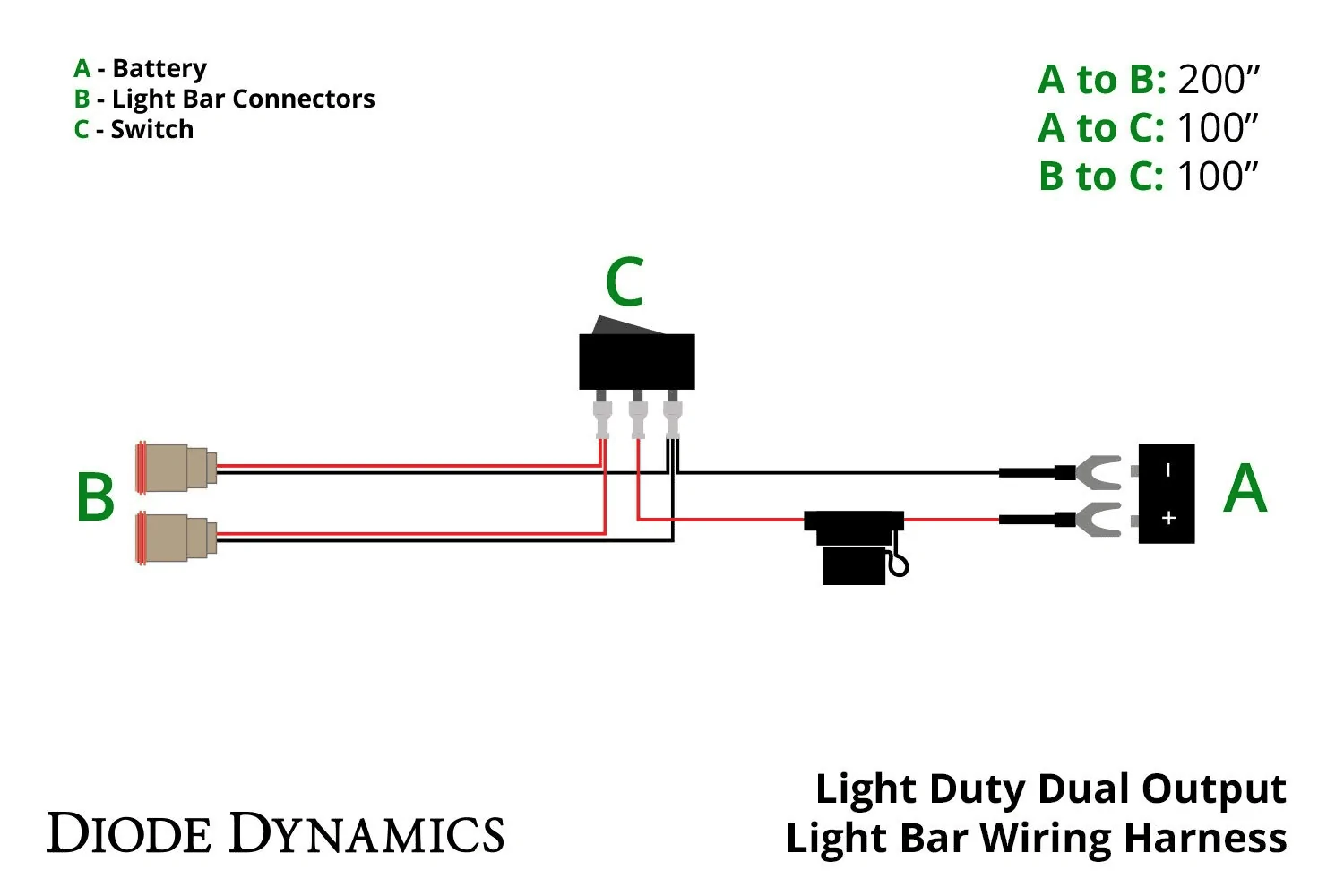

The second option would be our Light Duty Dual Output 2-Pin Offroad Wiring Harness that allows you run a toggle switch through your firewall for control.
Ford Bronco Base bumper fog lights 1631905744620
https://www.diodedynamics.com/light-duty-dual-output-offroad-wiring-harness.html

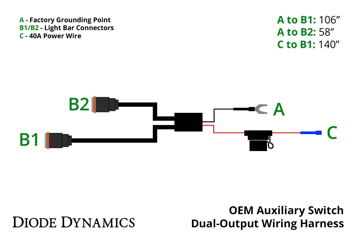

The final option would be our OEM Auxiliary Switch Dual-Output 2-Pin Wiring Harness that allows you to use your factory aux switches inside the cab of your Bronco.
Ford Bronco Base bumper fog lights 1631905770254
https://www.diodedynamics.com/oem-auxiliary-switch-dual-output-2-pin-wiring-harness.html
Please, feel free to let me know if you have any questions!
