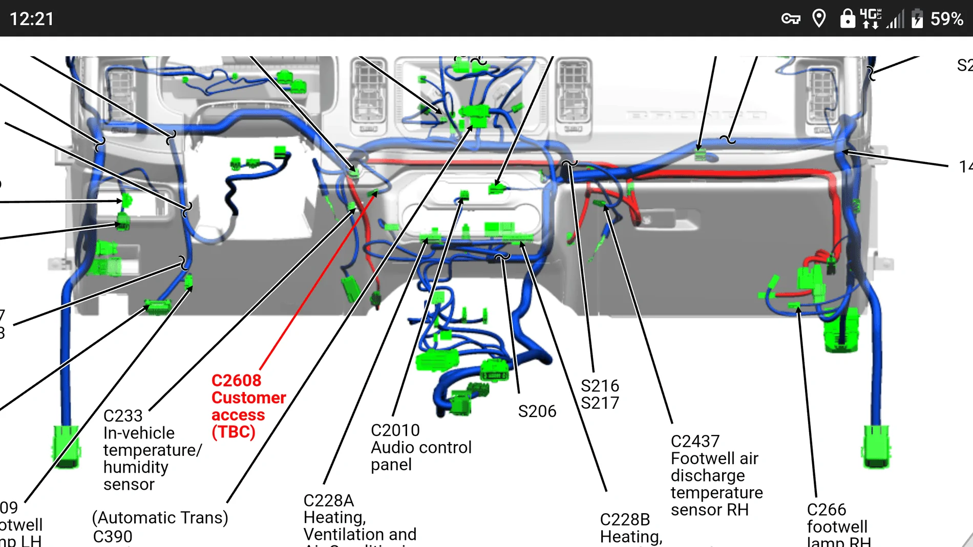

There should be provisions for an aftermarket brake controller, though it's just a basic "power and brake signal" connection.
Connector pinout

i'm an electrical controls engineer and I added a 7 pin connector and a brake controller to my 2012 Jeep Wrangler Rubicon. Lots of wiring and a relay. Don't think I would try it on my Bronco, I did order the tow package. That Can Buss can get you in trouble real fast.
