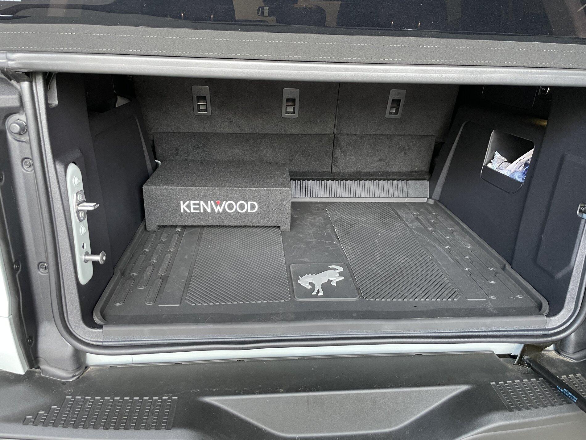

Mine was a powered sub. Tied into the rear 4" and it sounds great. Kenwood PA-W801B. Don't need an amp with it because it is powered.
Did you tie into both the left and right rear pods?

Thank you. Getting at the 6.5” speakers on each side wasn’t too bad. I don’t have the confidence to rip the entire dash apart though lol.
It was done by a shop so I can't say 100%, but I'm fairly positive it's just the left side. That's where all my wiring is running. I chatted with the guy before the install and asked if they were going to tie into the 6.5" or the 4" and he said he always ties into the back speaker closest and never has had an issue. And honestly it sounds amazing.
Nice. I like the placement and look of yours. Is there anyway you could confirm how they connected it or post pictures of the connections? 🙏
