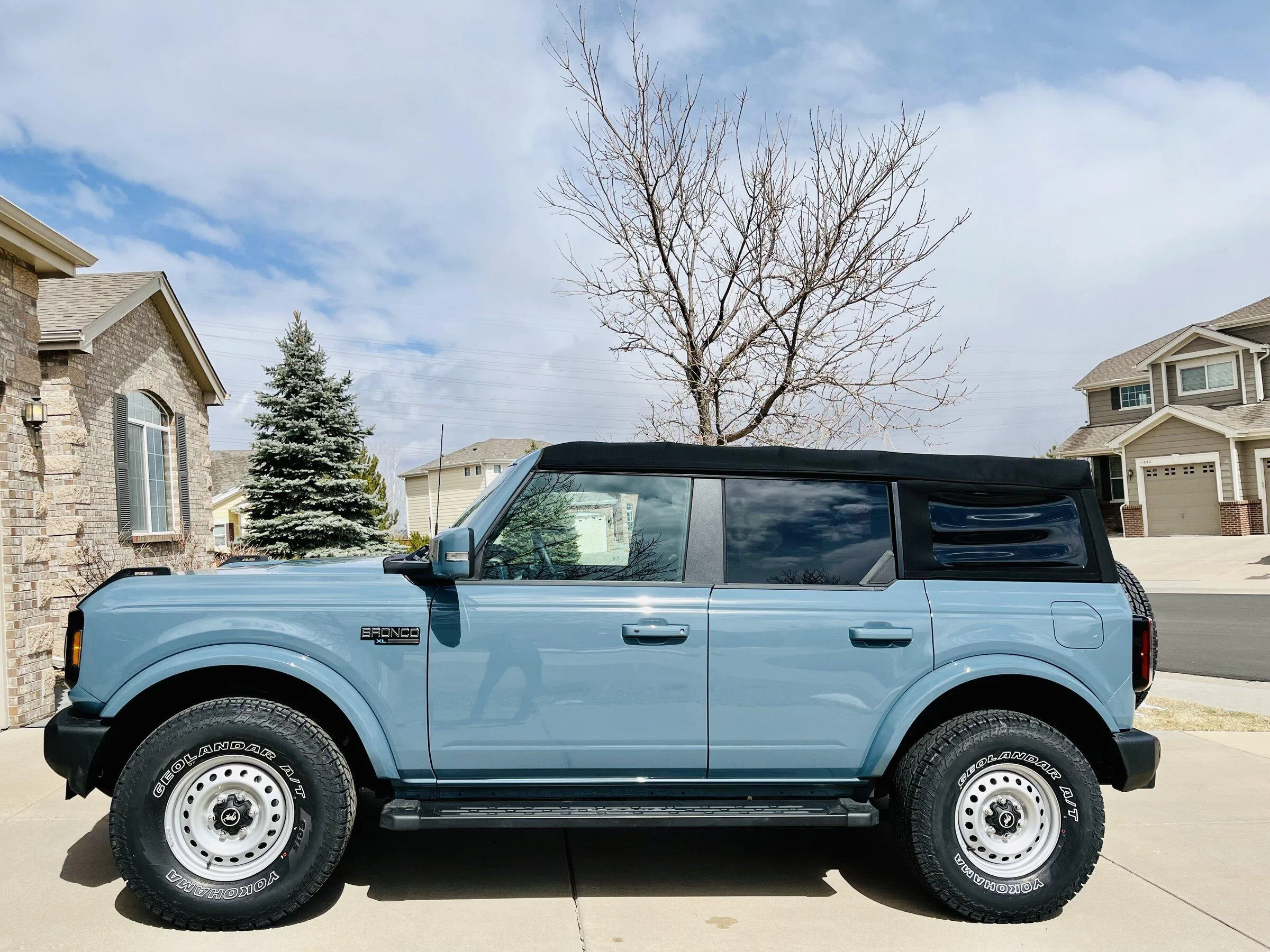

Hey guys picking up BFG AT KO 285/75/16 today on base wheels. What PSI are you guys running on that setup? Or any guidance about where to start with those. My local tire shop loves to over inflate tires
I just got this size tire on base wheels put on 2 days ago and they put them at 38psi. But honestly I’m not sure what they should be at either? The Ford app says 35 but that was assuming stock OBX.

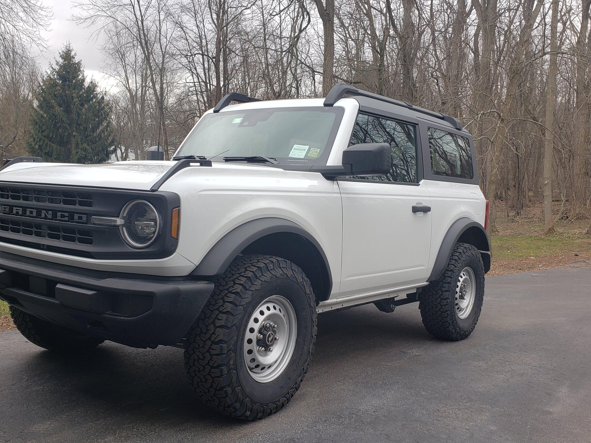

White works so well on the base Bronco! Looks fire 🔥
Like @kodiakisland says, pressure varies depending on usage. You can load up with typical cargo and occupancy and do a chalk test:
https://www.intercotire.com/using_chalk_method_determining_psi
I've gone from the stock 40 down to 35 on my 315's and I'm probably still overinflated for what I do so I'll be reducing the rears even more and running a chalk test to see how it works out. A wider tire needs less pressure than a narrower tire to support a given weight. Overinflated is safer than underinflated but neither are great for tire wear or handling.
