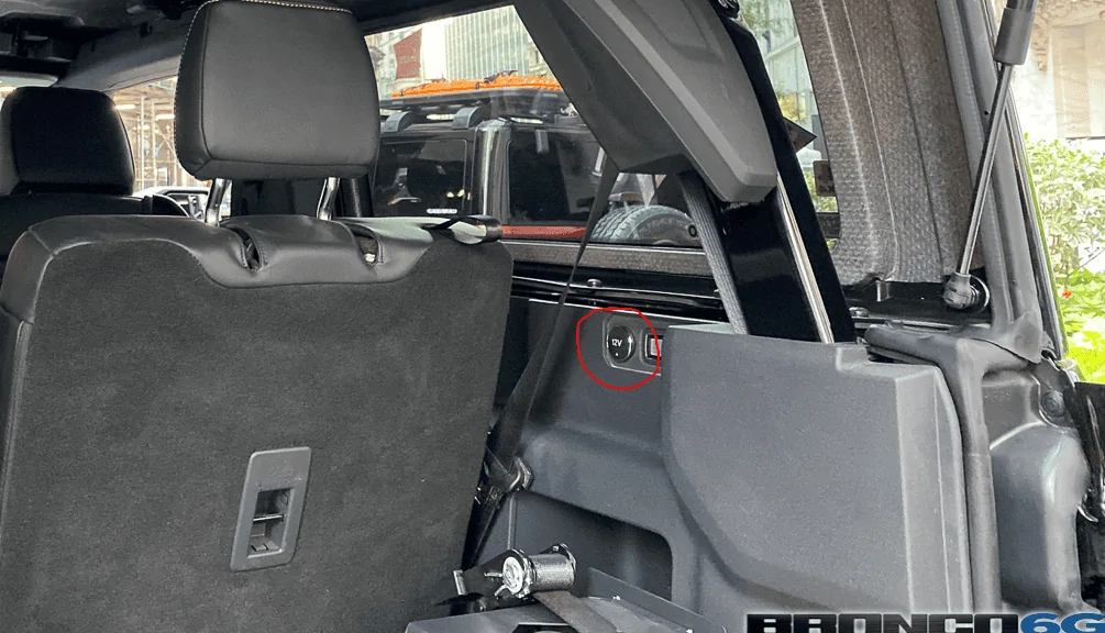

How far in the back is it? I'm hoping it was in the very back in the storage area. I thought that was only in the upgraded packages though?
Literally in the side wall of the cargo compartment:
Ford Bronco Basequatch refrigerator hook up? 1618579560002
...and yes, it's standard on ALL models.

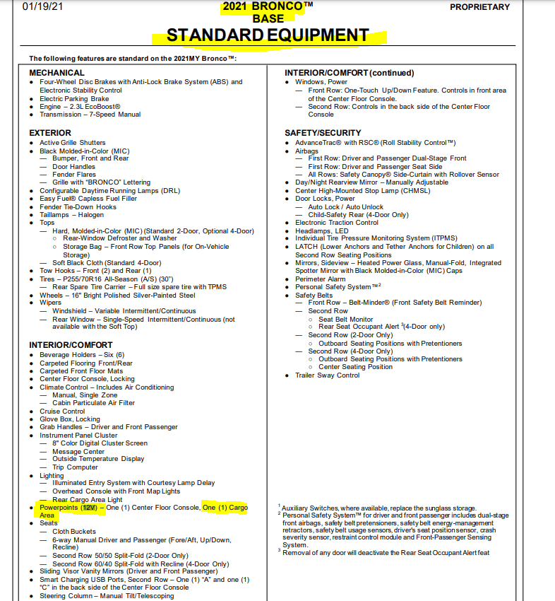

As noted in the official dealer order guide, which nobody remembers to look at any more:
Ford Bronco Basequatch refrigerator hook up? 1618579432942

As mentioned earlier, Mid and above will add the 110/120V inverter plug, which I think is on the back side of the center console. The twin 12V ports are universally standard across trims.
And as also noted, the dealer order guide is a pretty good reference for minute content packaging details - far better than B&P or some of the other "pretty" materials Ford has issued, anyway.
