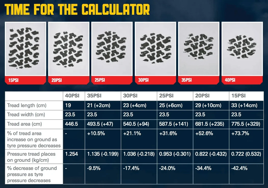

Like how low -- before you need beadlocks?
20psi?
Is there a general rule for activity / psi?
Sand : 15-20 psi (NO BEADLOCK REQUIRED)
Mud : 10-15 psi (NO BEADLOCK REQUIRED)
Rock Hopping : 5-10 psi (NEED BEADLOCK)

Like single digit low. I've aired down to between 12-15psi on regular wheels for years without trouble.
The only uses case would be extreme rock crawling where the extra bit of tire wrapped around a rock will make the difference between making it over or not.
99.8% of people have no need for beadlocks.

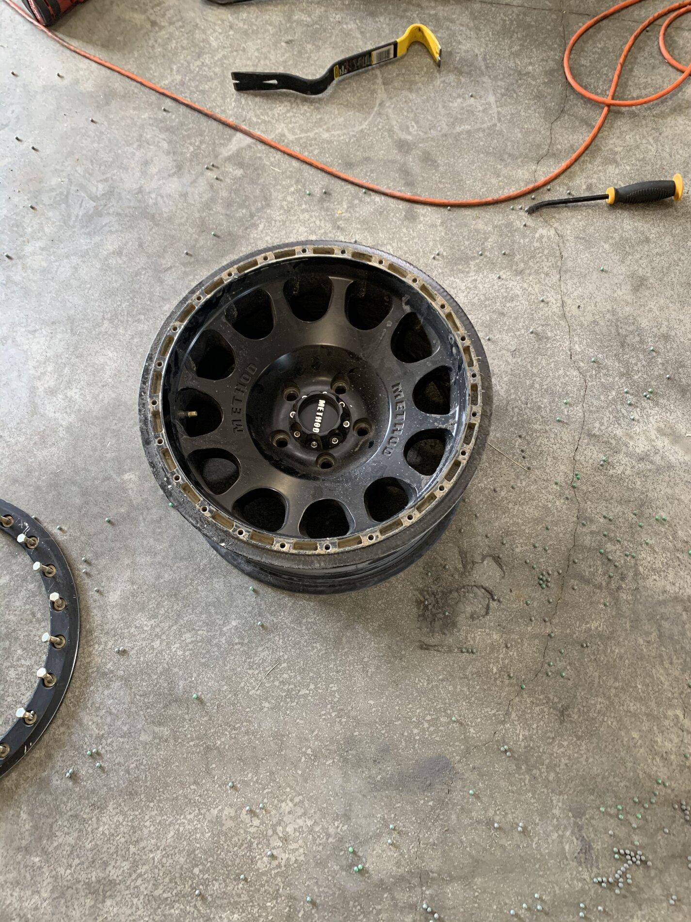

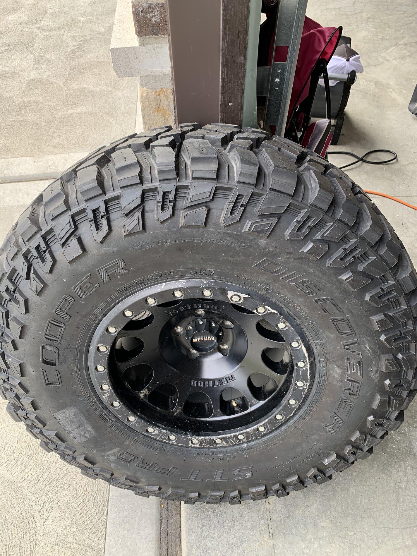

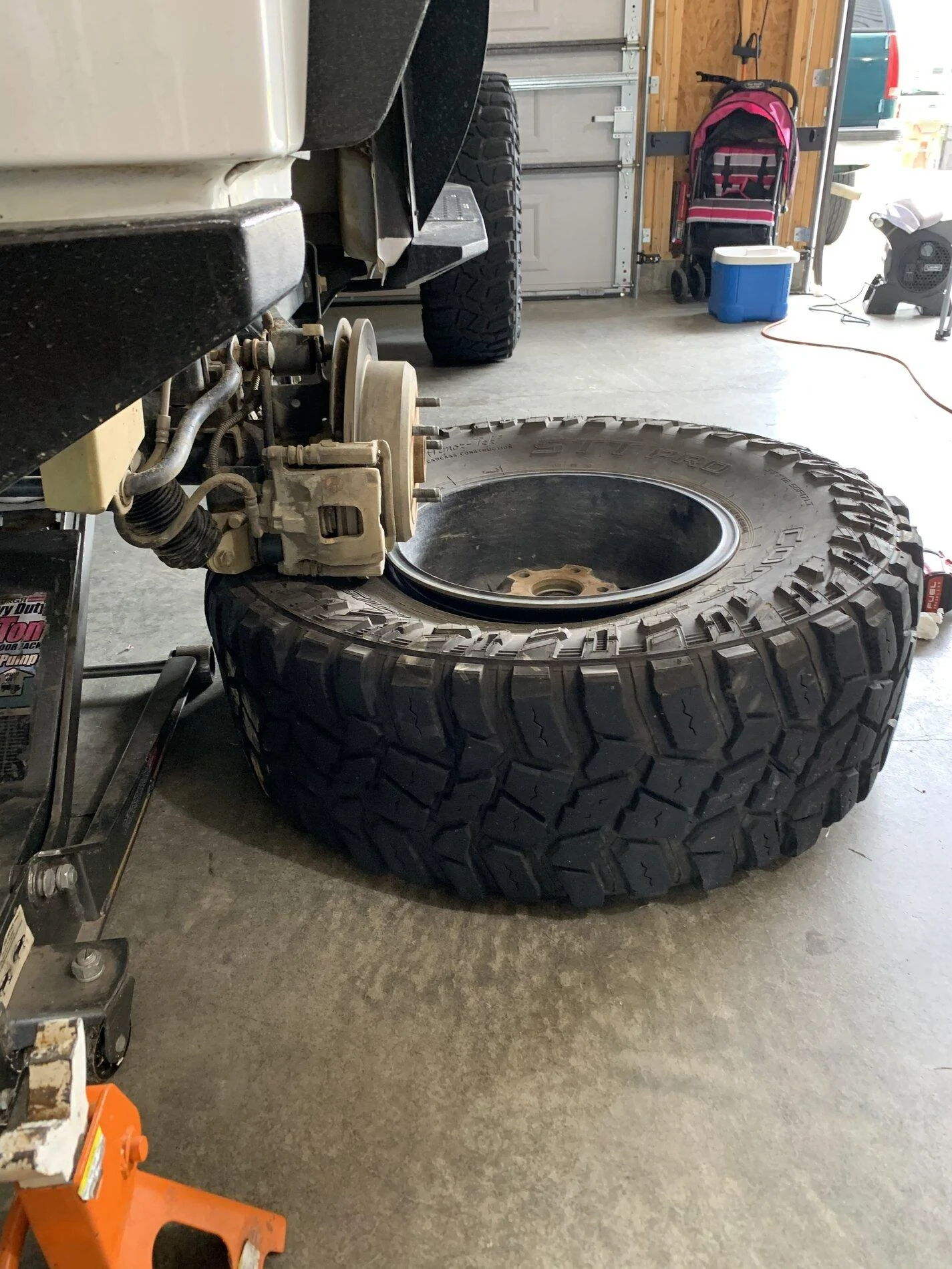

I’m going Sasquatch and will run beadlock rings 100% of the time. I currently do. I change them myself in the garage as is. Once you get the hang of it, it’s not a terrible job. They aren’t for everyone, that’s for sure. I’ve been using the weight of the Jeep to break the inner bead with good luck. 😂
keep in mind, this is a 115lb wheel and tire. It’s a workout. Lol.
