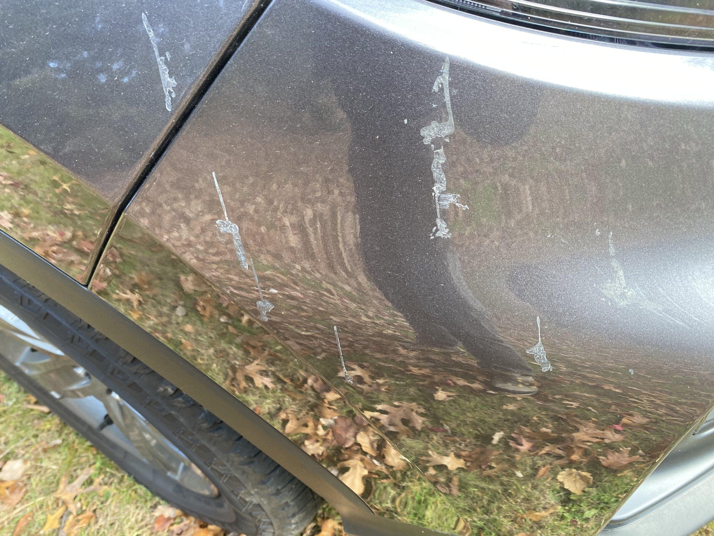

Asking for my Buddy, had work done on his house so had to park his truck outside, and well;
Ford Bronco BEST tree sap remover? 5FDCE7FE-6476-4D6A-A81D-EEE4D1BC84BB
what do you guys recommend to take care of that?
thanks in advance

I use lemon joy, it doesn't strip the wax.

Hot water on a rag and lift/peal it off. Any rubbing will just spread the stuff.

Pro method: Put a large dab of cleaner wax on the sap. Saturate a spot on a micro fiber towel with Brake Cleaner and polish away with light pressure. Follow-up with protection of choice.

Wd40! Works like a charm!
Spray a little on to loosen up, and use a terry cloth to lightly rub it, wipe clean, them use a little dawn soap to clean the WD40 residue. Then wax that spot. Its awesome!
(just read the post above I wouldn’t risk using brake clean on the paint!)
