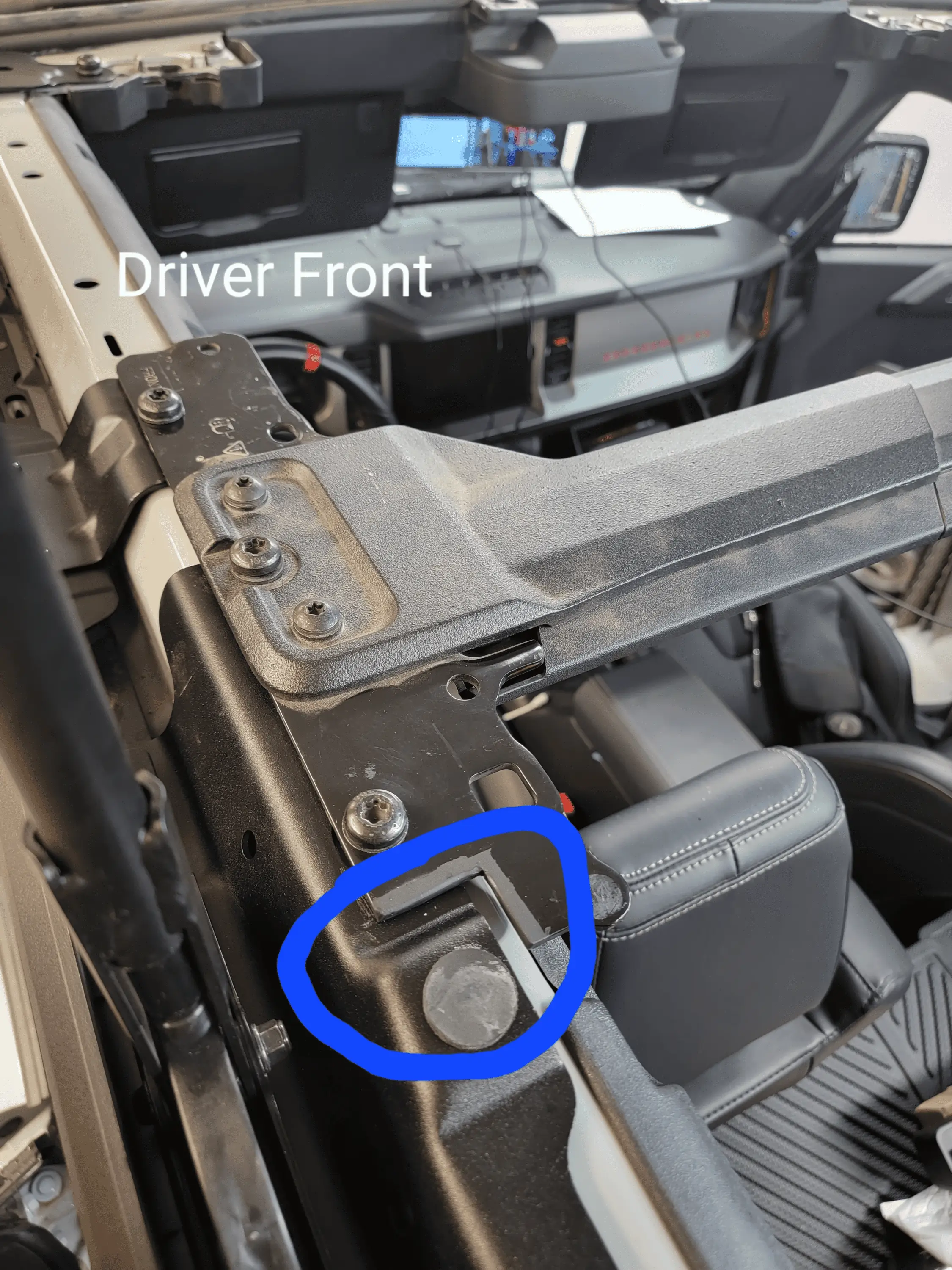

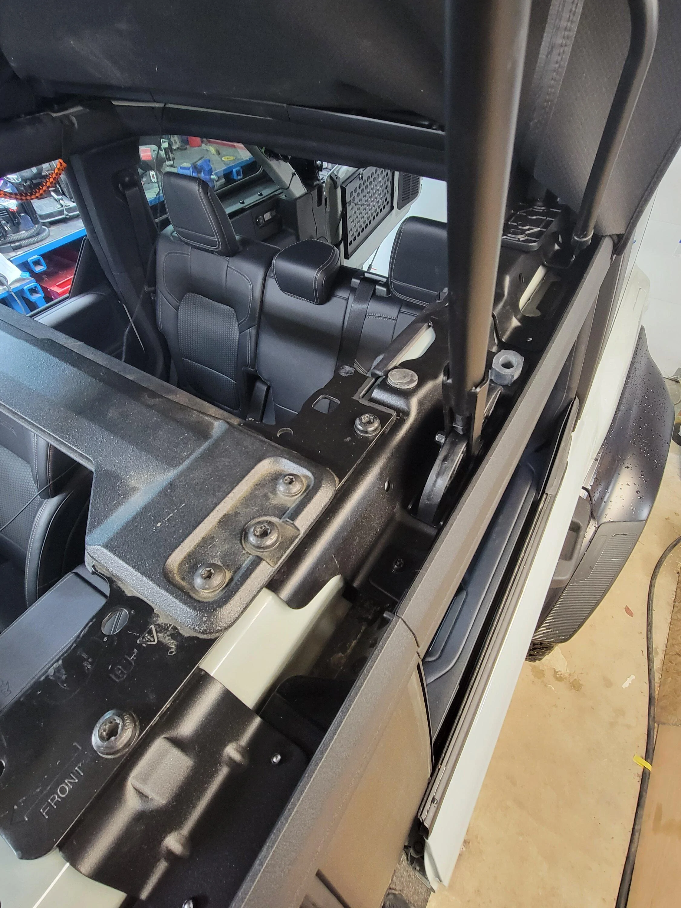

Posting here as I spent a lot of time researching if this would fit and thought it might help someone else out.
Tonight I installed the bestop skyrider, and as suspected it required minimal modifications. This solution is obviously not supported by Bestop or Ford to my knowledge, so proceed at your own risk.
If you want to remove the B pillar raptor specific support, it will fit fine with zero modification.
With the support in place your options are to trim about 1 square inch off the corner of the support or to cut and weld the Bestop provided bracket.

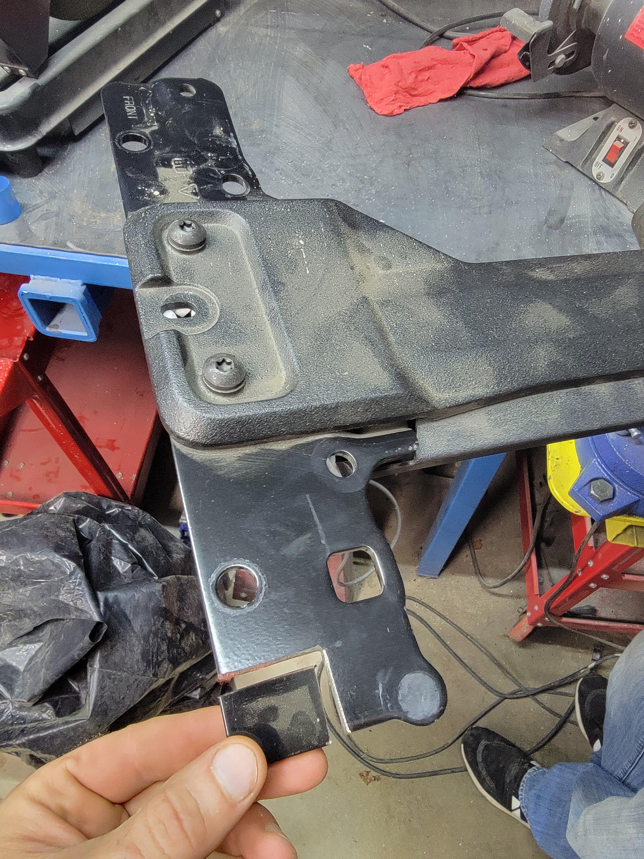

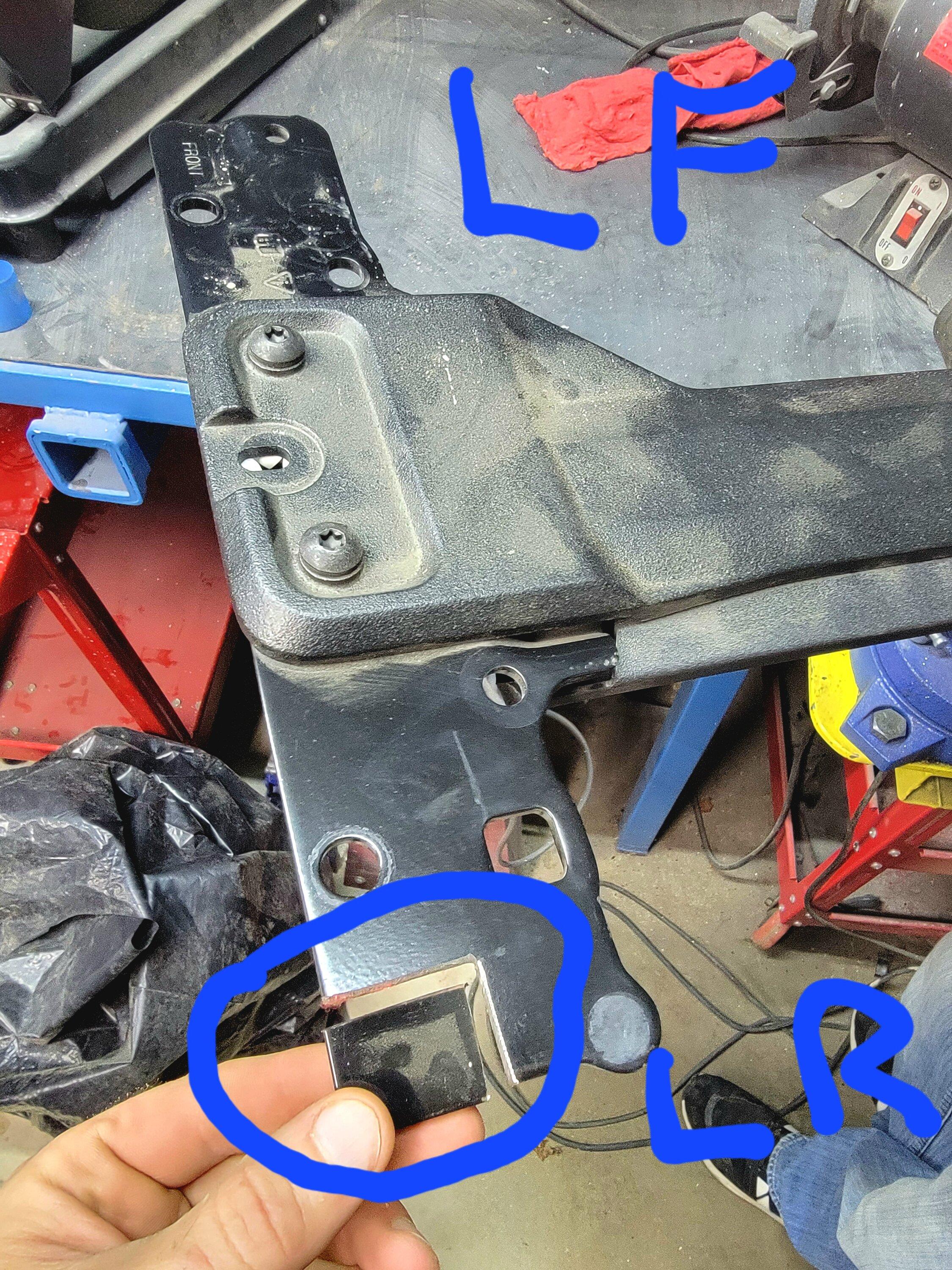

I opted to trim with an angle grinder and touch up the paint, then reinstall the brace on top of the Bestop brackets.
No other modifications or changes to the instructions were necessary.
This obviously puts the brace above the bestop bracket but there is plenty of clearance around it opening, closing and with the cross bows.

#It would be fairly easy to modify the bestop bracket if that was the desired approach too. It appears the bump up with the foam sticker is there to keep the cross bow supported tight and not rattling when closed. you could easily remove it and use a rubber or foam bumper on the edge of the crossbrace and accomplish the same thing. I chose the path of least resistance.

it looks like you could of sloted the best top bracket to fit over the brace as well. A relatively easy modification for best top to make .....

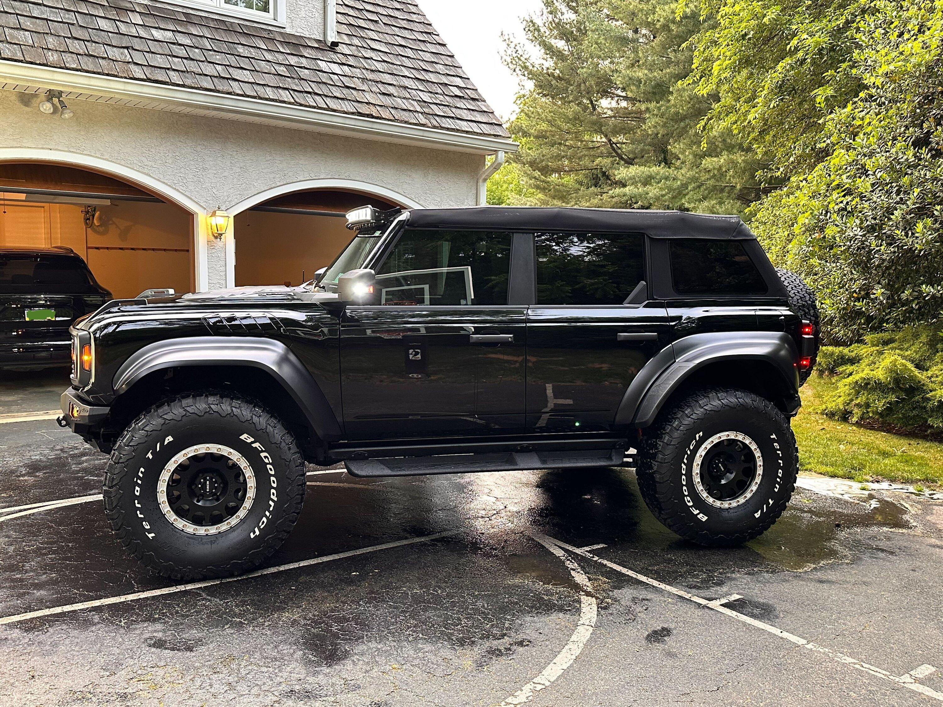

pictures of your BRAPTOR with the SKYTOP? open and closed?

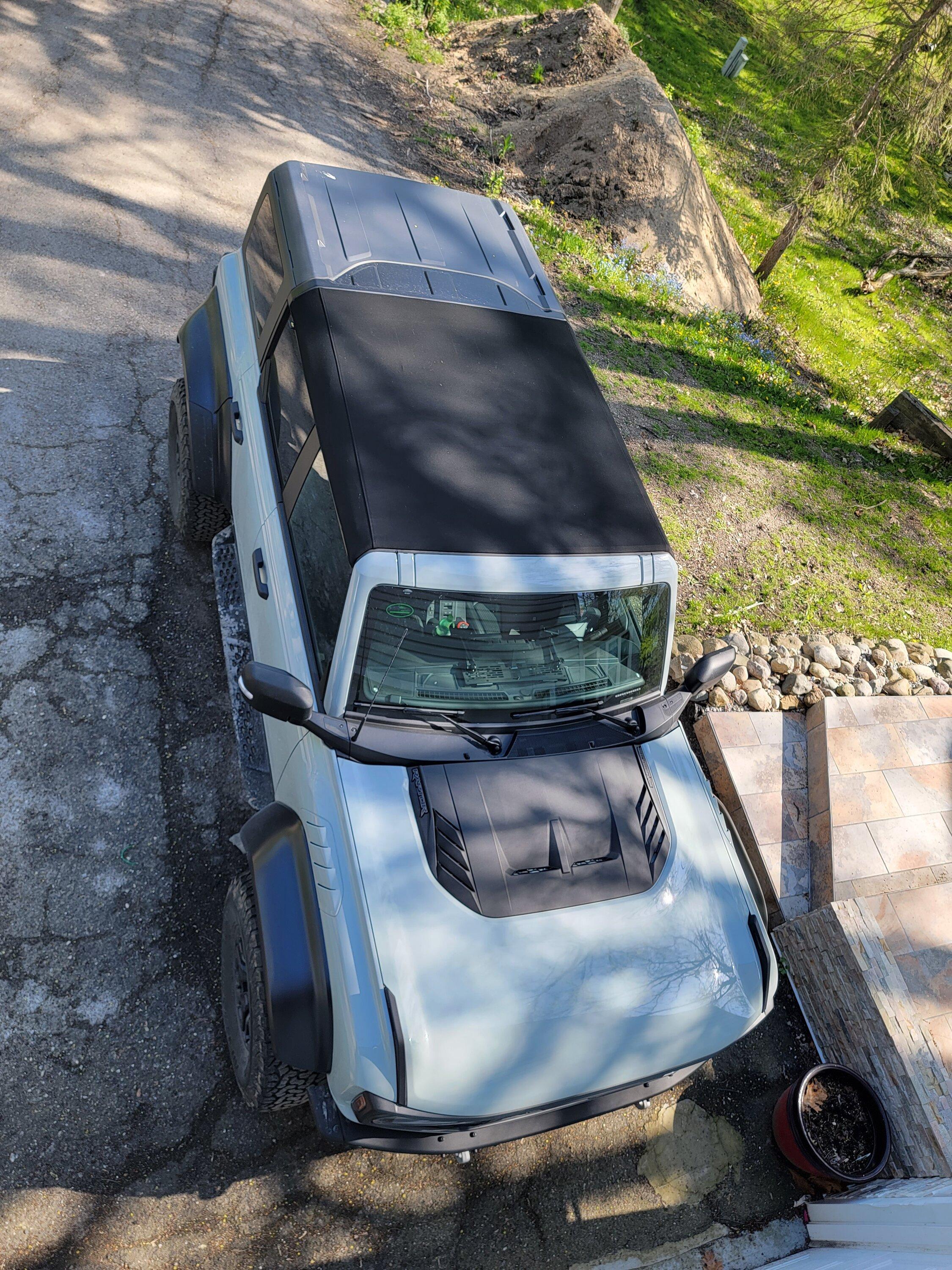

Out of town to next week but have a few attached that sort of show and highlight the MIC color difference. (also, yes....my wife loves me parking on the porch steps).
Will grab a few better open pics when back home.

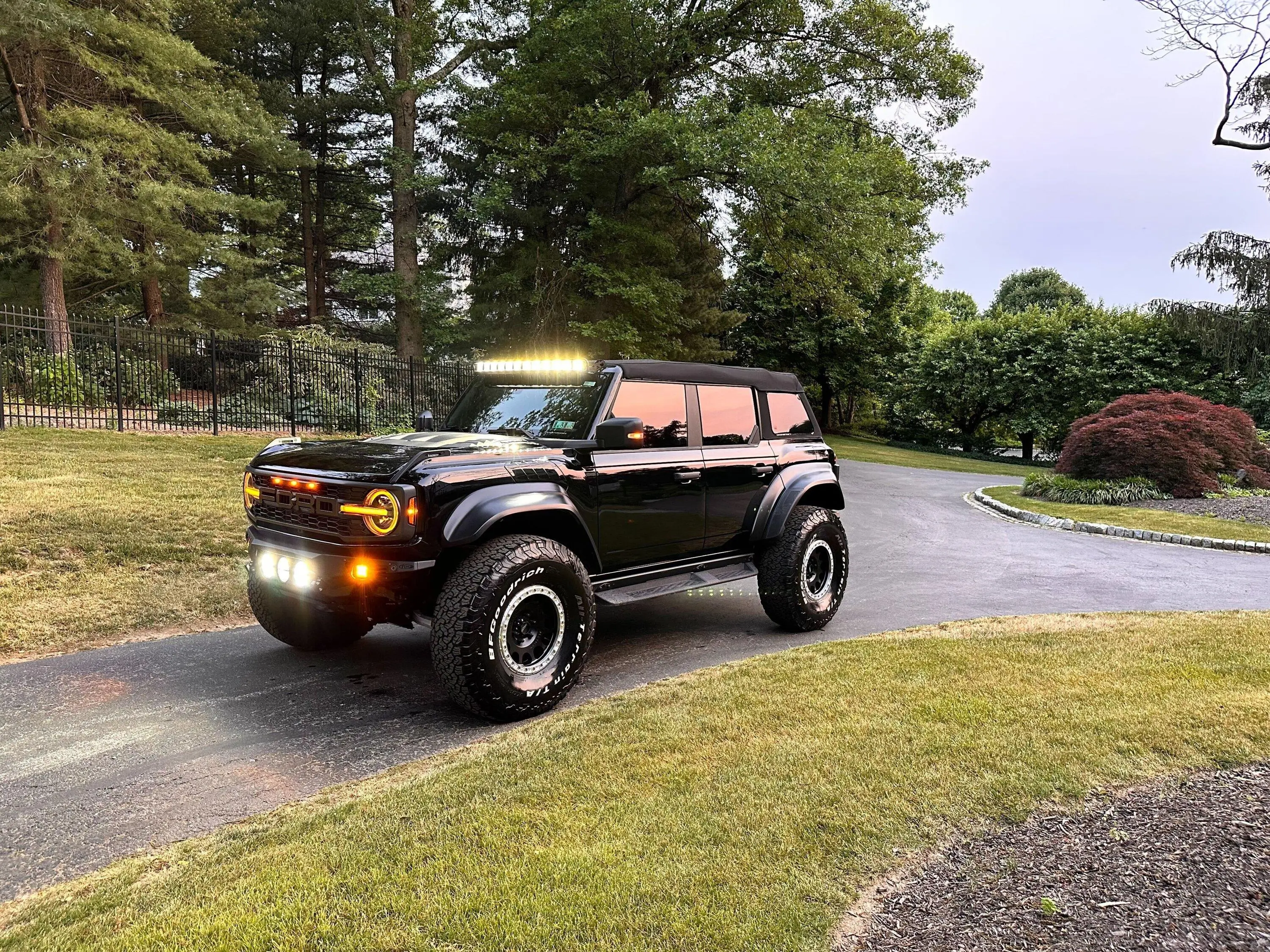

hey folks,
i had been watching this thread closely as i was hoping to get the trektop installed on my raptor.
short story, the trektop fits well and works with the modification suggested at the beginning of this thread.
i did have to tweak a few things to get it perfectly adjusted, but they were related to the trektop and not the install on the raptor. for example, i put foam inserts inside the velcro straps that wrap around trektop frame, b/c there was a bit too much slack. it made a big difference. next im going to remove the bestop logo out back (was very surprised to see that after it was installed); and also look to see how i might be able to easily remove it for days i want to go completely open top. i wonder if i can create some sort of quick-latch mechanism so i can just pop it off the frame.
but more importantly...as far as install goes, it fits great....
