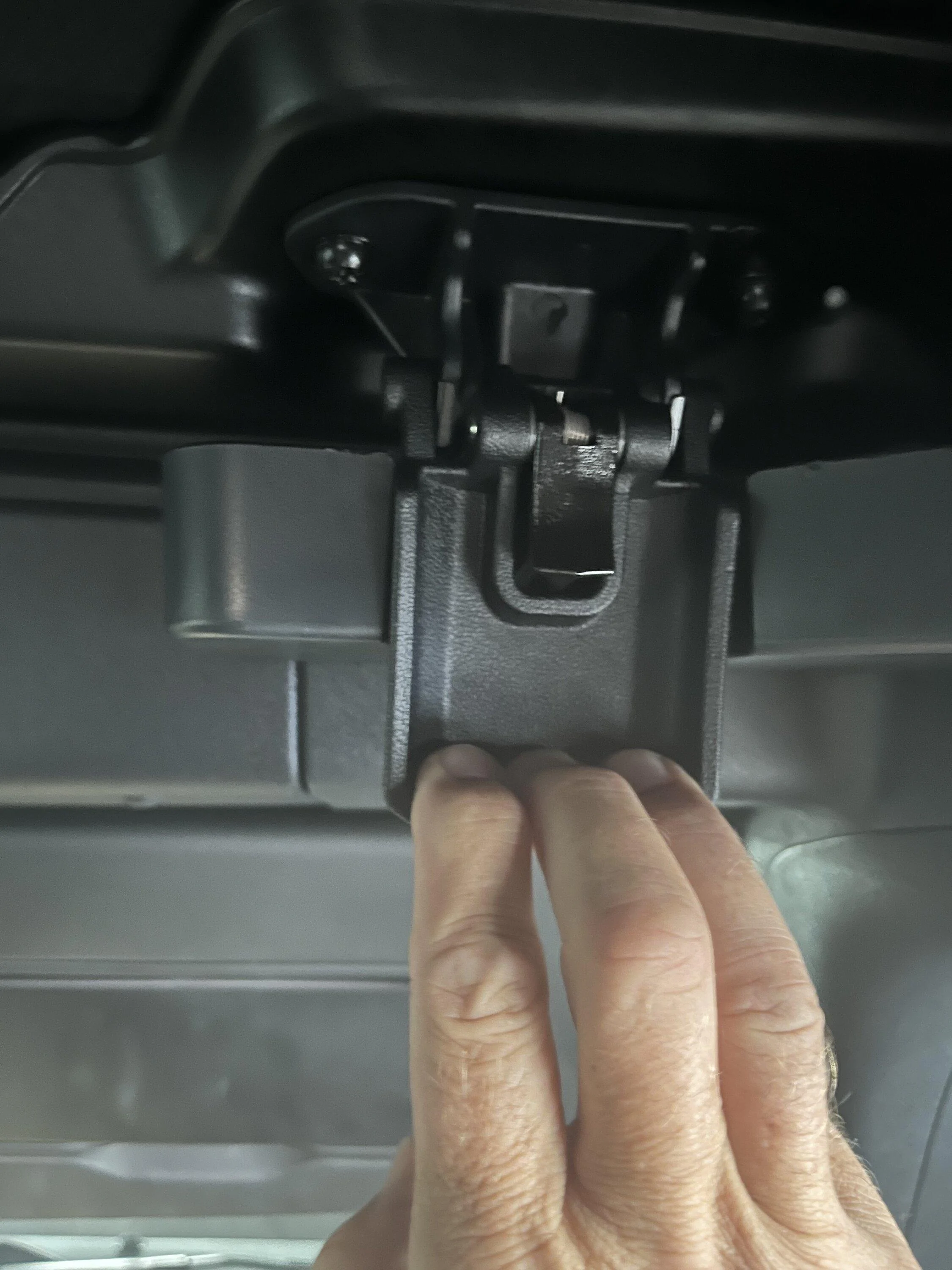

Ok so not so much a trigger. But when you unlatch, pull down on the mechanism while you swing it back up, if that makes sense. You’ll feel the roof header come down a snitch, and the j hook will disengage.
Ford Bronco Bestop Trektop won’t unhook 8BD793A9-94DD-41E7-B749-03CF2452AC28
