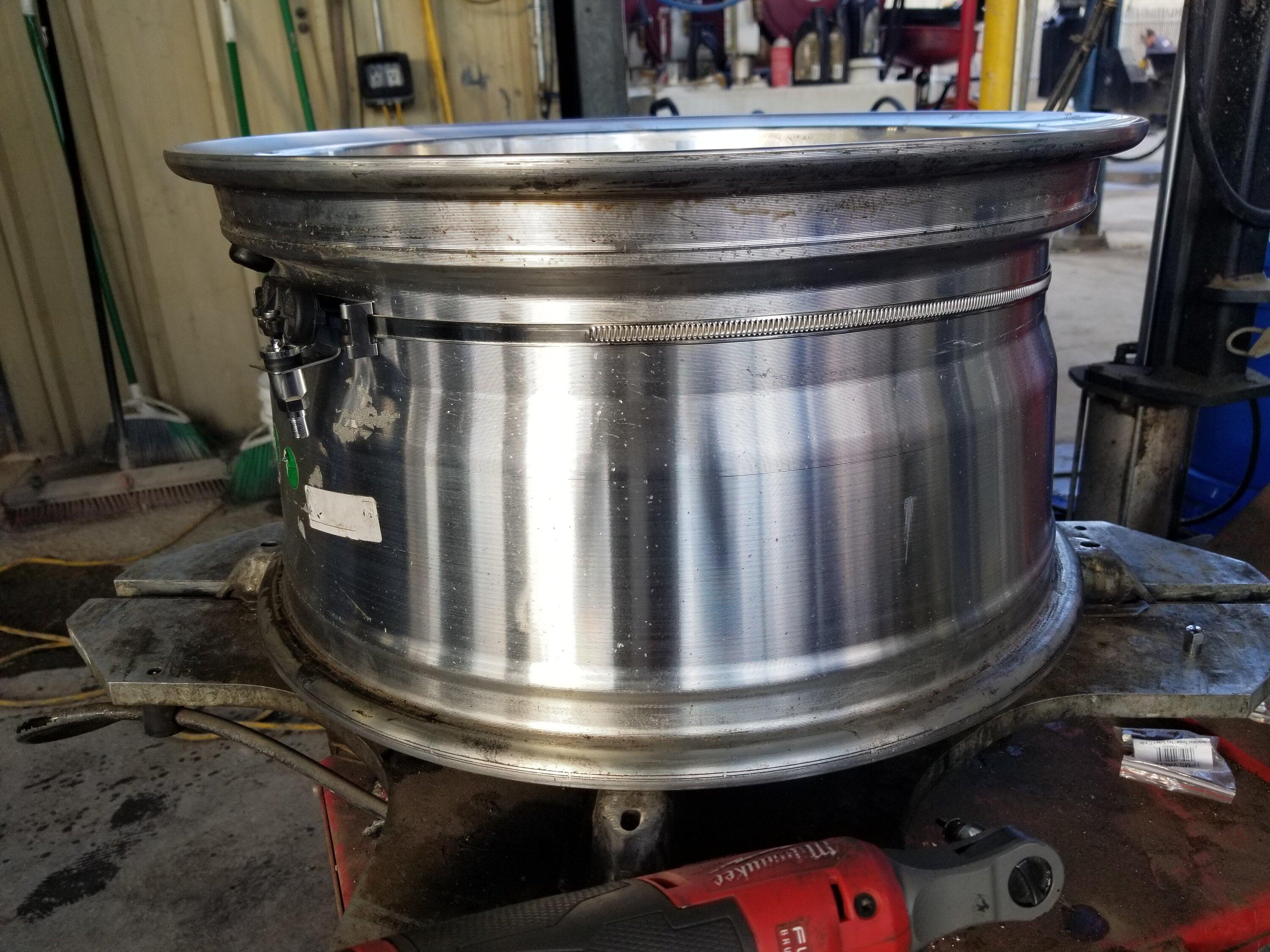

I thought I'd post up a different way to deal with TPMS sensor mounting, especially when mounting aftermarket wheels. One of my concerns with the normal valve stems and TPMS sensors is that the valve stem is rigid. It's rubber, but has a copper tube inside which makes it rigid. Rigid valve stems are always a risk off road as a rock or stick or log can rub against and break off the valve stem. Seen it happen and it's happened to me. We always run rubber valve stems for this reason. We found this way to mount the TPMS sensor inside the rim so we could use a normal rubber valve stem.

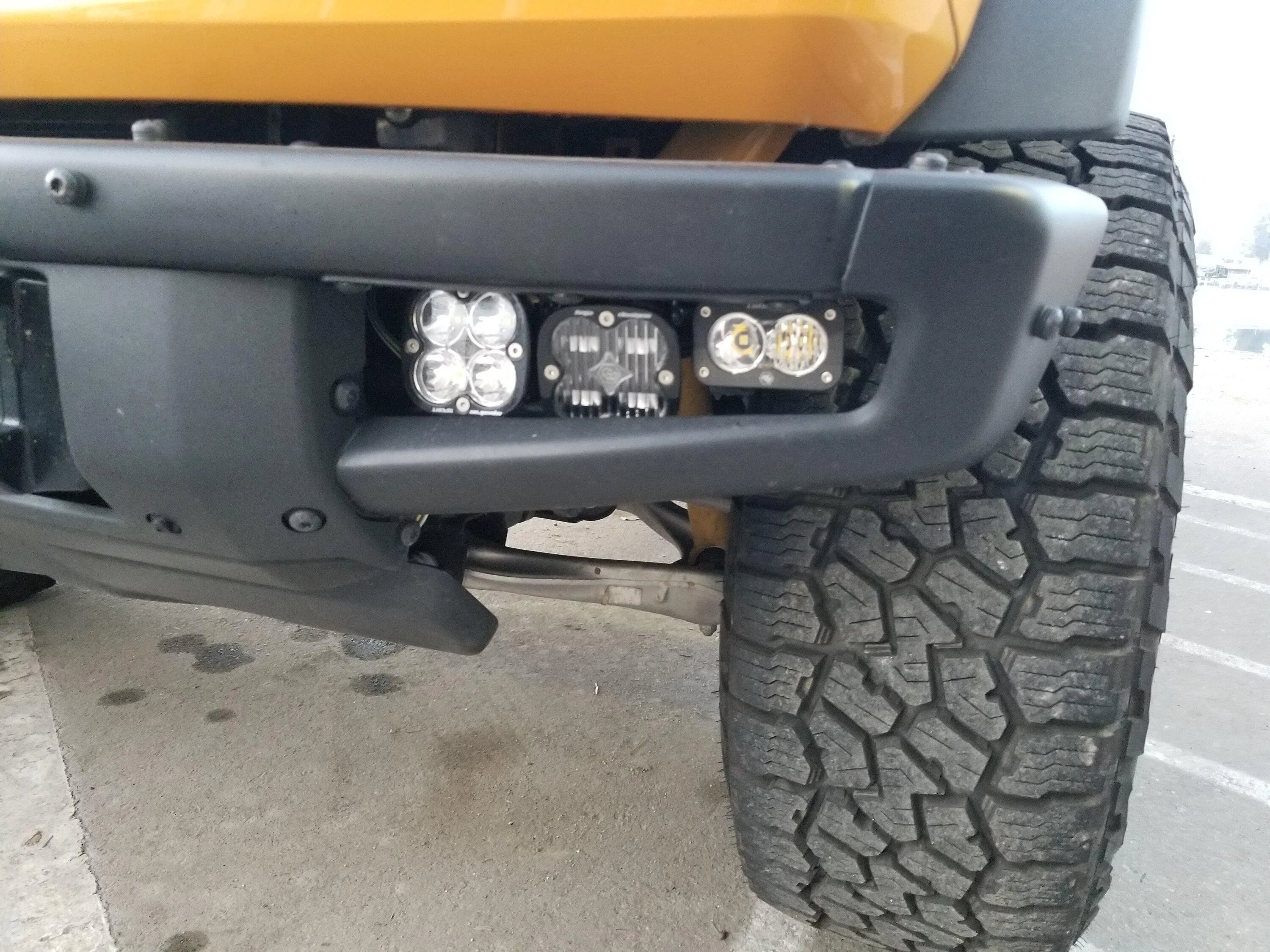

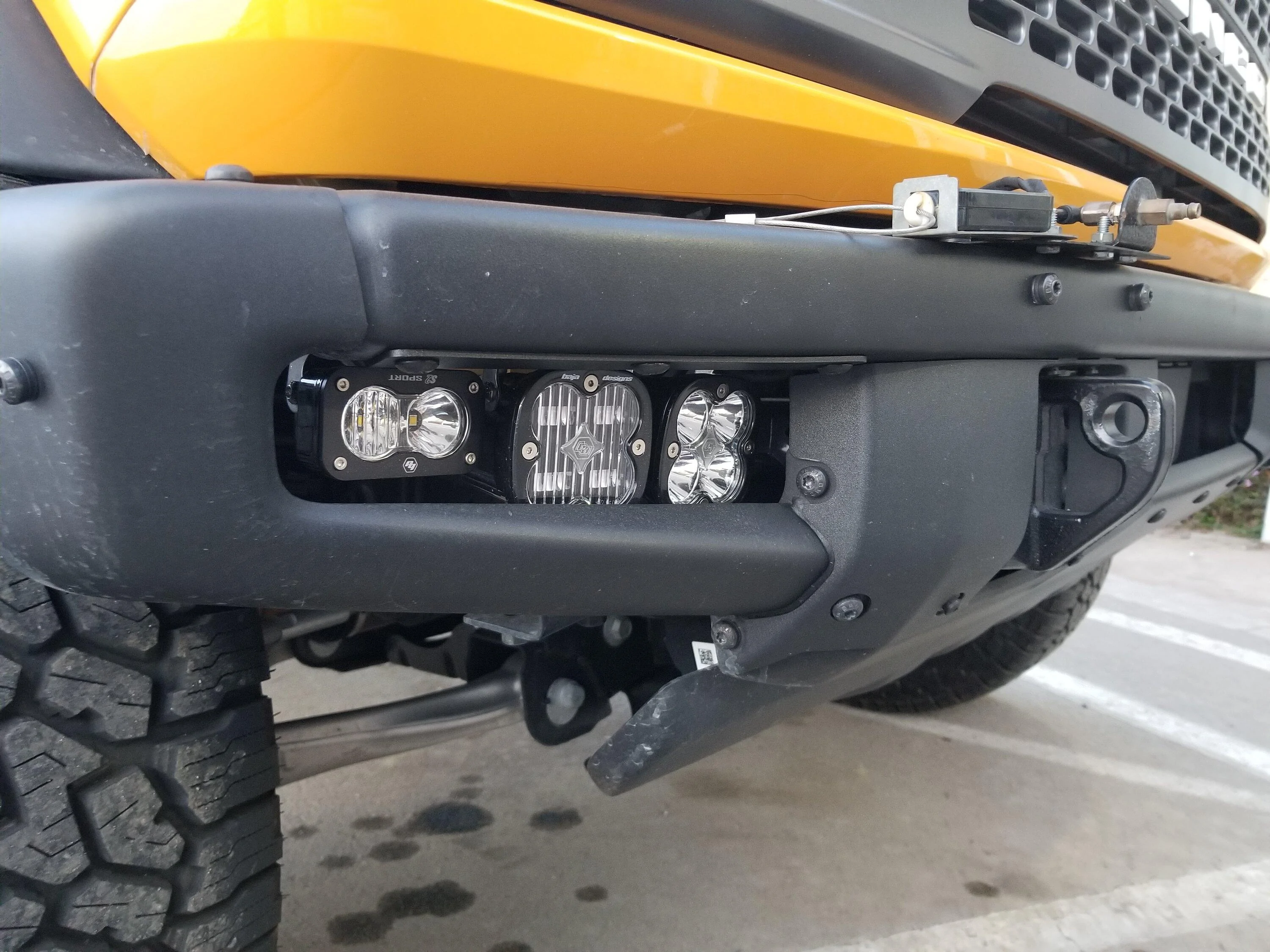

I also broke down and installed a set of Baja Designs lights in the bumper. I'm not too big on lights, since factory lights are very adequate for night wheeling unless you really haul ass through the desert. And, I lead a night run every year and with all these vehicles with useless light bars all lit up you can't see anything because of all the glare behind you! Anyway, I got some lights. Wanted to find a use for some of those cool accessory switches. :)

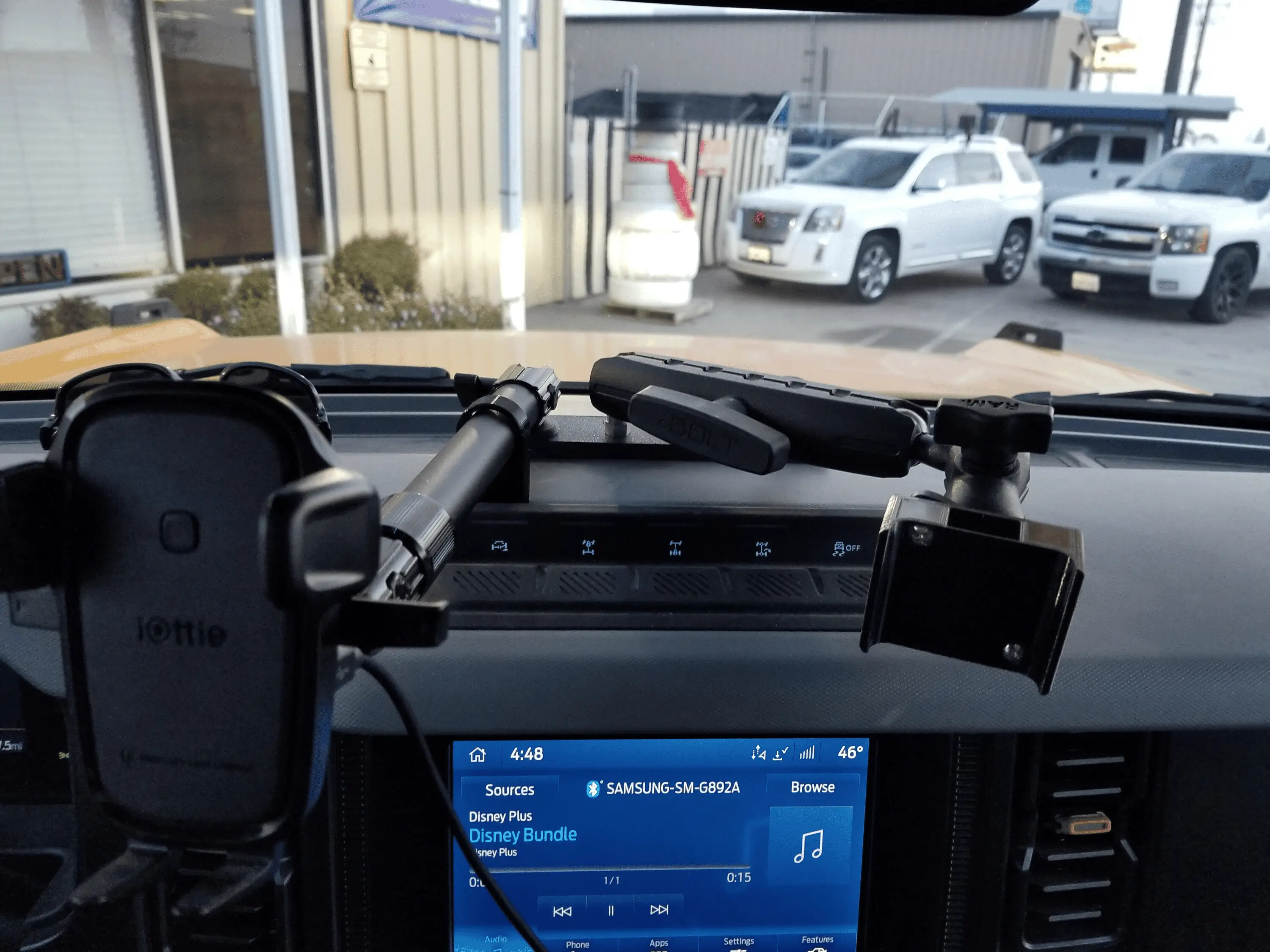

Got and installed a dash accessory mount for my phone and handheld radio. I'm not really impressed with the one I got, and might change it out. It uses only the one factory screw to mount to, and it's a bit wobbly. I might opt for another one that also uses VHB on the ends for more strength and stability, though this one gets the job done.

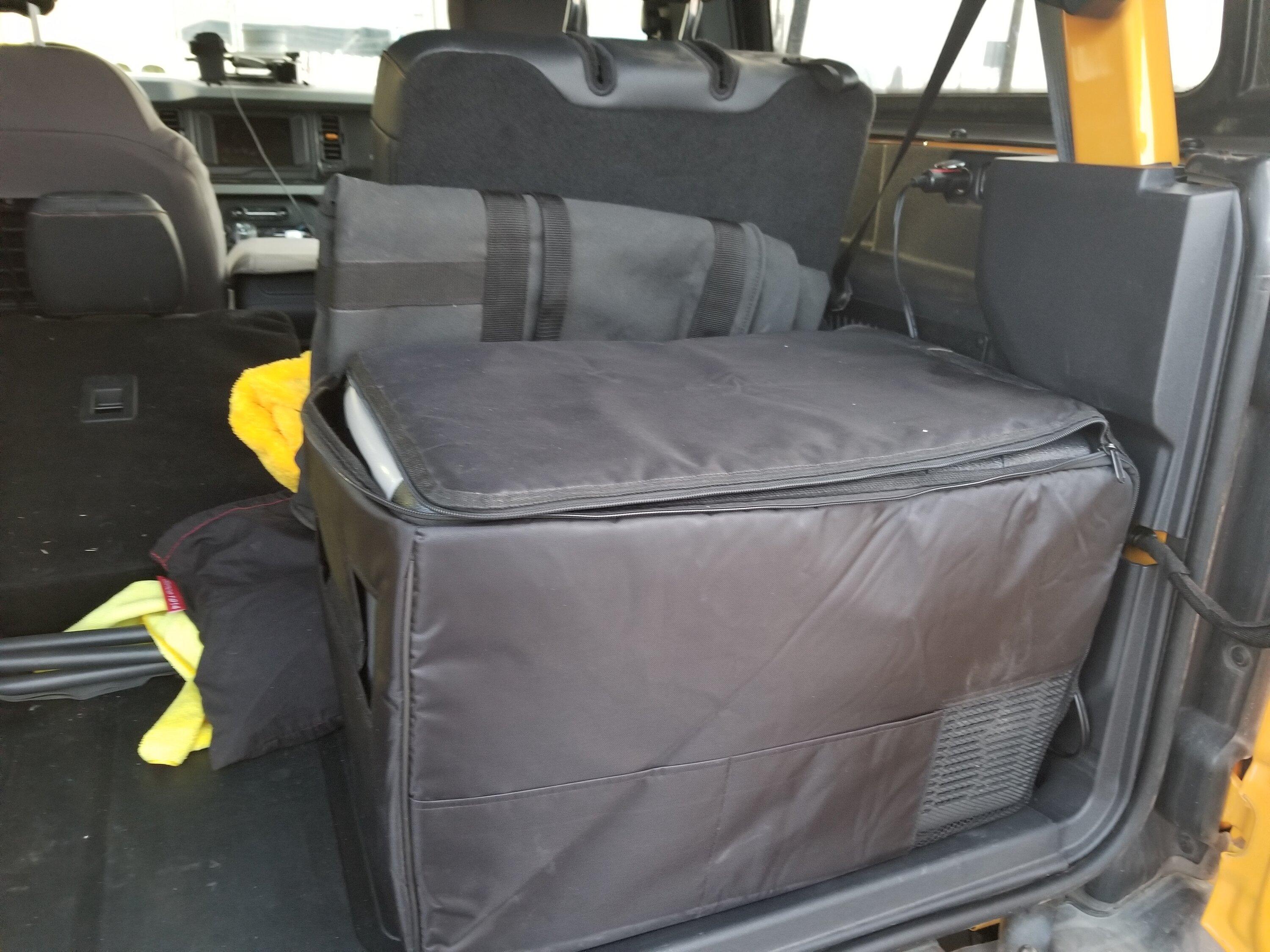

Finally got my Air Force One RV tow brake kit moved over from the Jeep to the Bronco. I had some gift card money to use up, and decided to get a refrigerator for the Bronco. Never had one in the Jeep, but I'm really glad I got it. Worked really well on a recent 10 day road trip, and it's super simple for drinks and lunch on day trips. Even helps going to the grocery and not having to get right home with the cold stuff. After a bunch of research I decided to go with ICECO. It's middle of the road price and yet has the good compressor so it's very efficient with low amp draw. Mine is the JP40 and I'm very happy with it, fits fine in the back of the 2 dr Bronco.

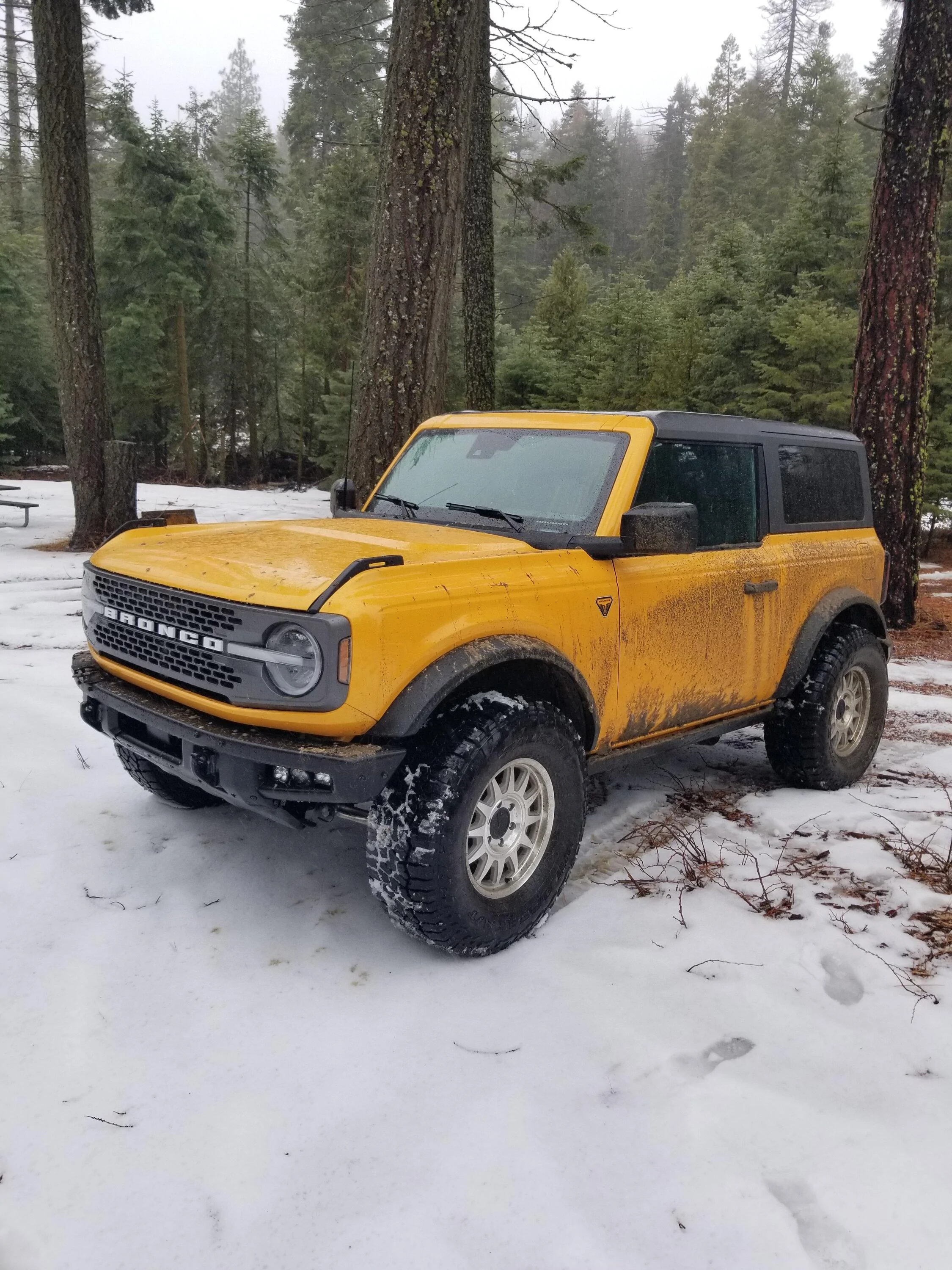

So, with this new stuff, the Ceramic Pro PPF, the Raceline wheels and 35" Wildpeaks, and half of a 1" leveling kit installed in the front, this Bronco is finished. No plans for anything else. Oh, and the already installed tie rod reinforcement sleeves and the Auto start/stop eliminator kit, which is awesome.

What's funny is I once had a 07 Explorer and the sensors were mounted like this, I converted to stem mount when I put on aftermarket wheels.
Where did you find that bracket?

We're a tire dealer, so got them through one of our tire distributors, ATD. I see them available online, both the straps and cradle are needed.
07 Expy. Those things were the WORST. I just drove on a bad sensor for 2 years while waiting for my Bronco to be built.

I was thinking today about installing a half of a 1" level kit. Your bronco looks level. Did you use something like the Zone kit and just leave the bottom part off?
Thanks

Yep, but left the top part off. Only installed the bottom spacer, which is pretty easy to install as it just goes between the two bottom mounting bolts. Bronco sits level. Since a Badlands is only .43" lower than a Sasquatch a full 1" level kit would be too much. And, the 35's fit fine in the rear. I've wheeled it pretty good and no rubbing with the 35's at all.
I share your same thought on light bars. Far better improvements to spend money on ;)

What fridge is that and how do you have it tied down if you do?
It's an ICECO JP40 and it's not tied down. No issues so far. Fills one side of the space behind the seats.

Cool, that’s great to know. I have a Dometic CFX45 which I may sell and go down to a 35 and didnt’ want to remove a seat or add anything like the Goose Gear platform which costs a small fortune. I may strap down, but will try without doing so first. Glad to know it works for you.
When mine finally arrives in the next few weeks, I’m adding the fogs as well (Baja Designs) and the little pods I think, but have moved away from a full on bar up top, since Like you said, some dude behind me will usually have one or several dudes!
Fogs are functional and good in bad weather as well since I’ll have Amber on the Squadrons.
