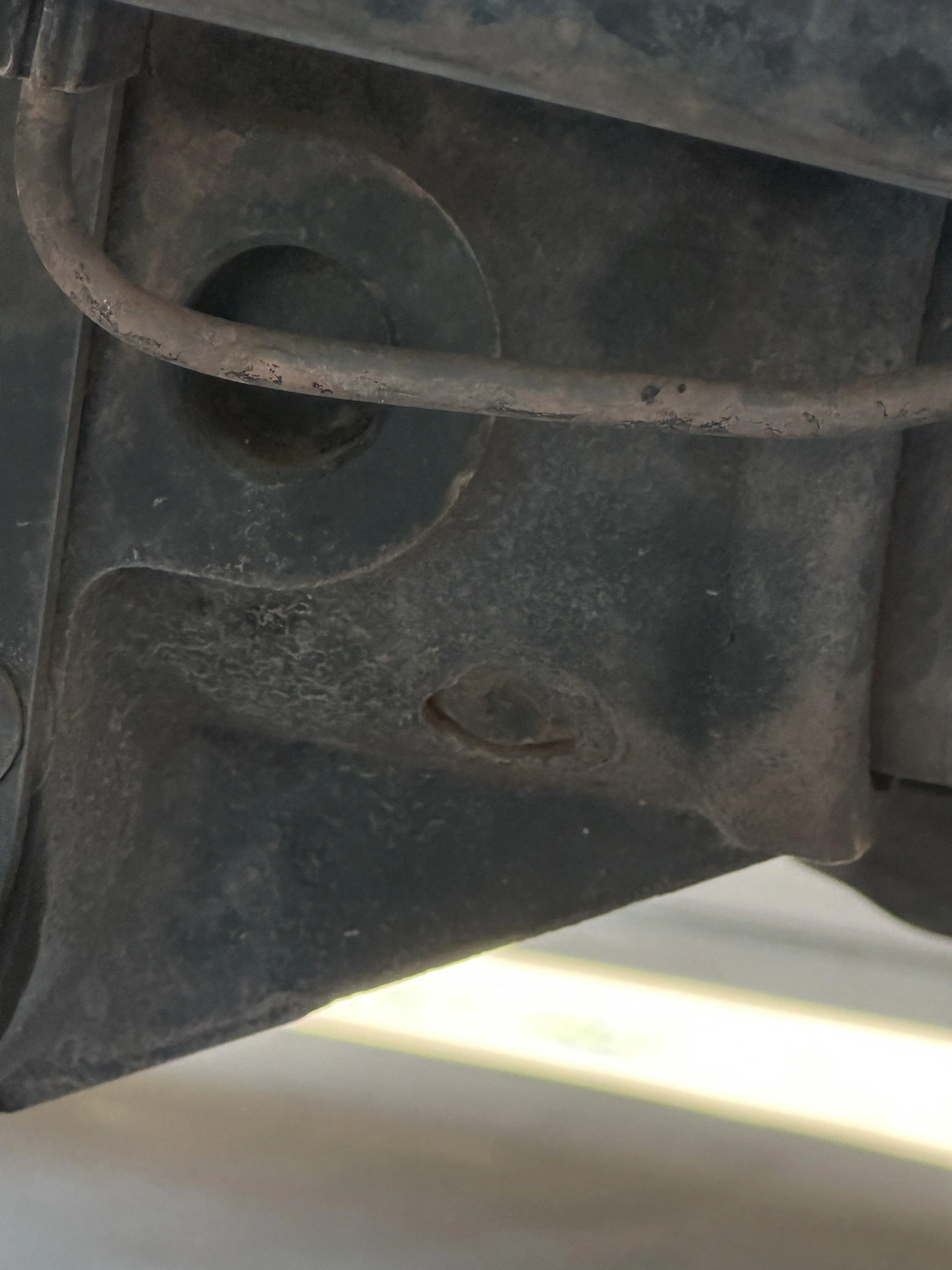

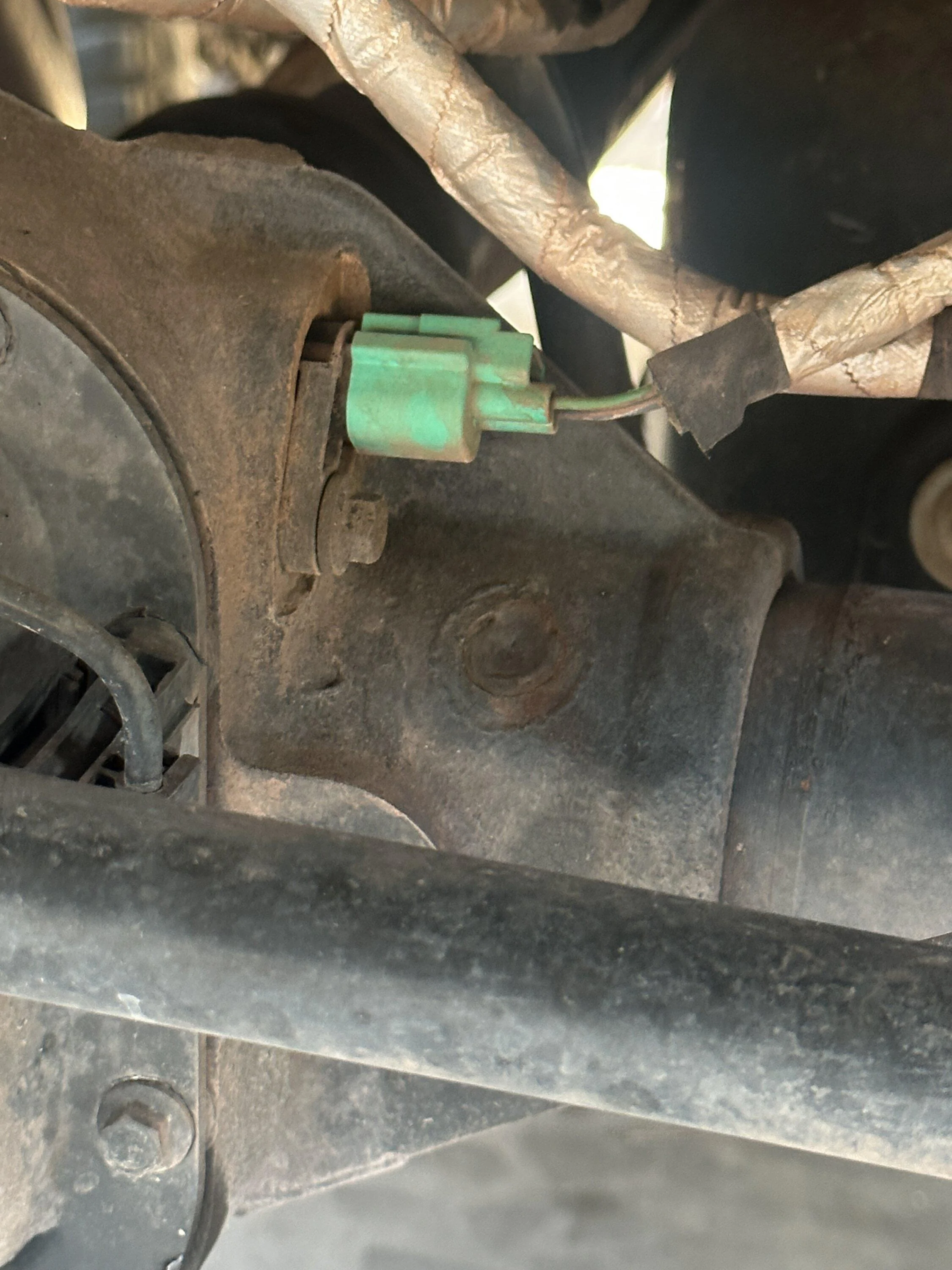

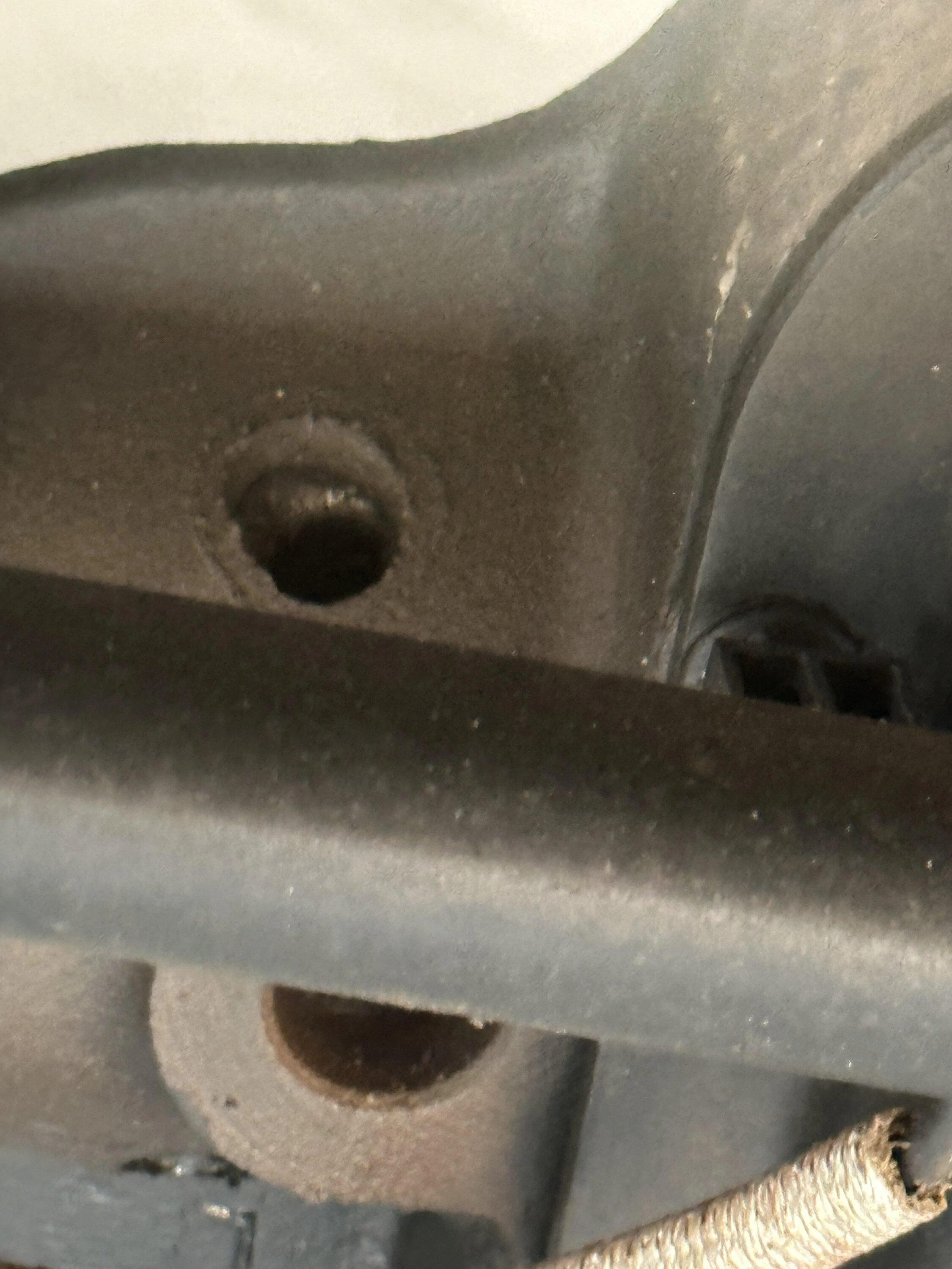

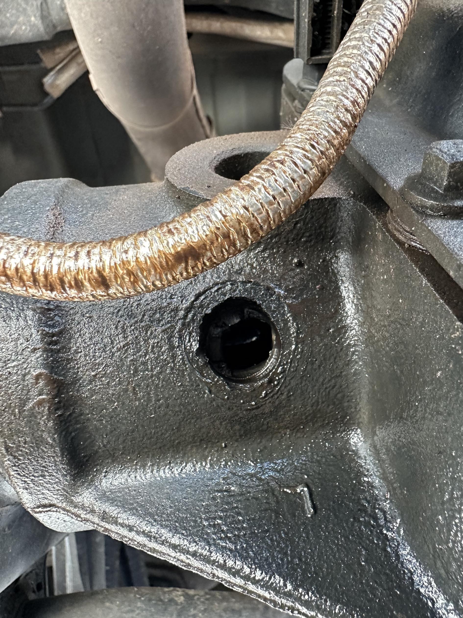

I want to put this out there before it starts happening to more and more vehicle especially any that have upgraded their Suspensions on your Bronco. The rear axles on any of the Bronco's are not designed well enough to handle Trail turn assist with these Rear Axles (unless you brace the axle tubes and pumpkin). The axle tubes aren't welded properly from the factory to handle the force of the inner tire braking while activating Trail Turn assist in our vehicles. You're literally applying tons of pressure to the axle tubes while it brakes the inner tire. The brake is directly connected to the axle tube so when it apply's the braking force to just one single tire it's putting tons of pressure on that axle tube and could cause it to break the welds on the inner section going into your pumpkin. There is only 2 weld points that hold the axle tube from turning essentially, the top and bottom weld (Pictures Below).
Attaching pictures of my Passenger Side which is still welded and Drives Side which the welds are GONE!!

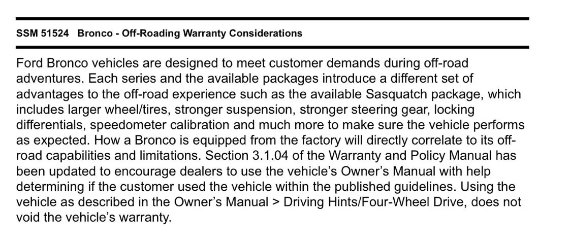

My Ford Dealer is Denying it and I have attached their reasoning of why they're saying No to even asking Ford to Warranty my Rear Axle.
I have a 2022 Ford Bronco Badlands w/Sasquatch. I have seen multiple other people that have experienced the same issue's and some that have been deny'd by their ford dealers.

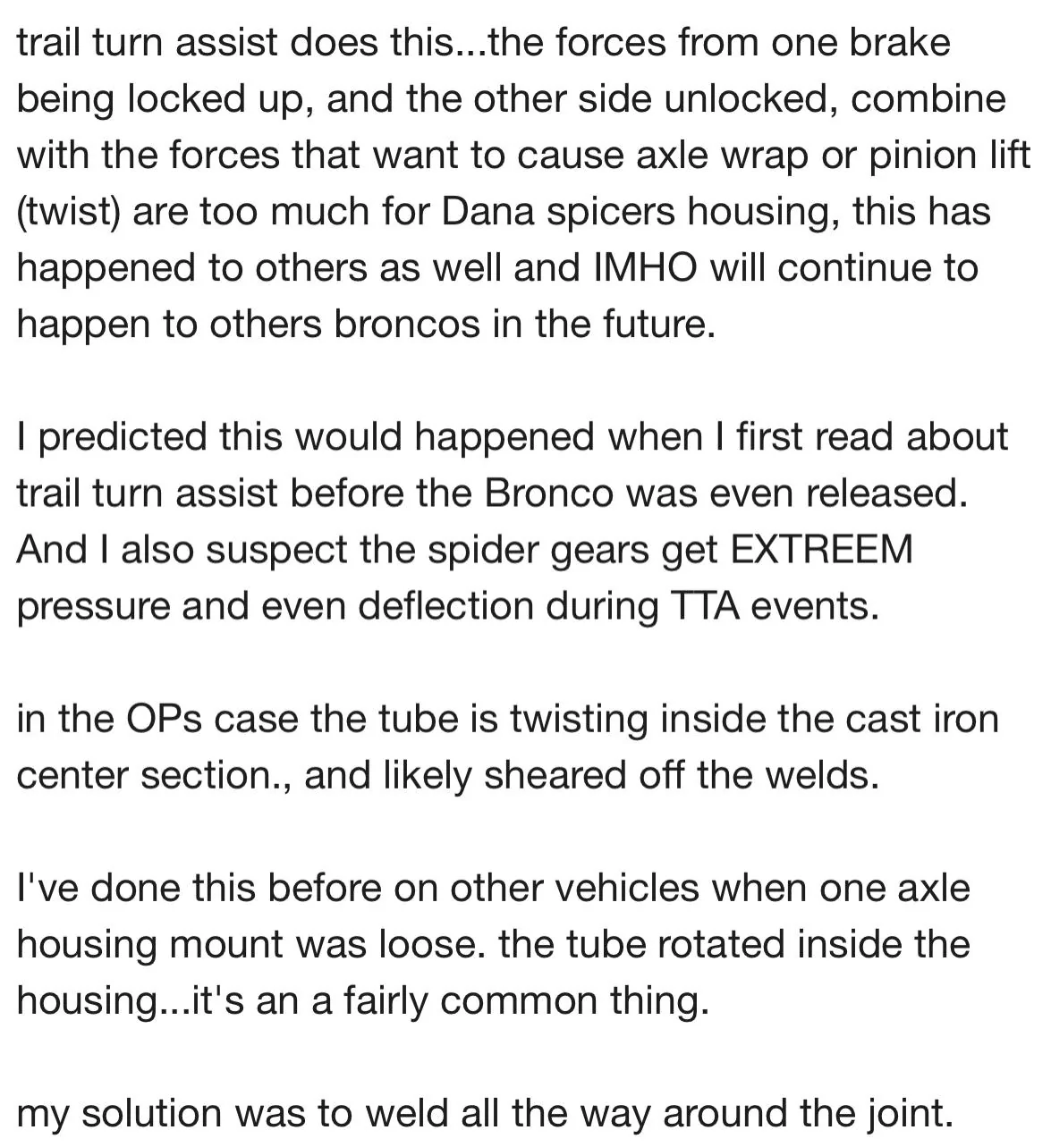

Weld all around the joint between the axle housing and diff, then change your diff fluid. My manual doesn't have TTA, but getting my rear diff welded properly may be in the cards anyway.

Do you think they will consider having their FSE come in to make the call? If you're stock and knowing this has already been reported, dealer shouldn't have any issues covering (assuming no impact or other obvious damage). Getting the FSE in to make the final determination will be additional insurance for them to ensure Ford pays the claim.

I really don't think the dealer has any say in warranty work. If a client walks in wanting warranty repair, then it is the dealers responsibility to file for approval if said dealer deems the repair questionable. The client has the right to ask for a FSE at anytime client feels the response from dealer is incorrect without pursuing verification from Ford Corp. Then the Ford engineer will determine the steps forward.

I don't think Ford has any obligation to cover this under warranty because of your upgrades/larger tires, and maybe they were also able to pull some data on what kind of speeds you hit with TTA and whether or not they were higher than specified.
It could possibly be caused by a manufacturing/welding issue but, coming from someone who has worked with repairs/RMAs, I completely understand why Ford would deny warranty on a modified vehicle unless they just wanted to do it to make you happy.
If this was a stock Bronco and we 100% knew that TTA was only used as specified it would be different, but I don't think this can be completely put on Ford IMO.

Is this just a plug/spot weld to make assembly quicker (where a normal person would weld completely around the tube)?
Plug welding is the norm across the board. And under normal circumstances is sufficient.
But like all parts, if you over work it or over stress it, it will break. If you were to fully weld the axle tubes and something is over stressed like in this scenario, then the damage could possibly be worse. In my opinion, when you shear a plug weld, you are relieving the stress immediately vs full axle twist.
Warranty coverage is completely up to the dealer unless there is some sort of prior approval for a part (which most things do not have)
Also I don’t think any customer has the right to request an FSE to come out, however they do have the right to contact Ford directly if they believe something being denied should be covered. In which case Ford may then send out an FSE.
That being said, I do believe most good dealerships would automatically involve Ford or an FSE in this situation. I know for a fact that my dealership would. Unfortunately not all dealerships are the same.
Either way, this should be a warrantable concern in my eyes.
