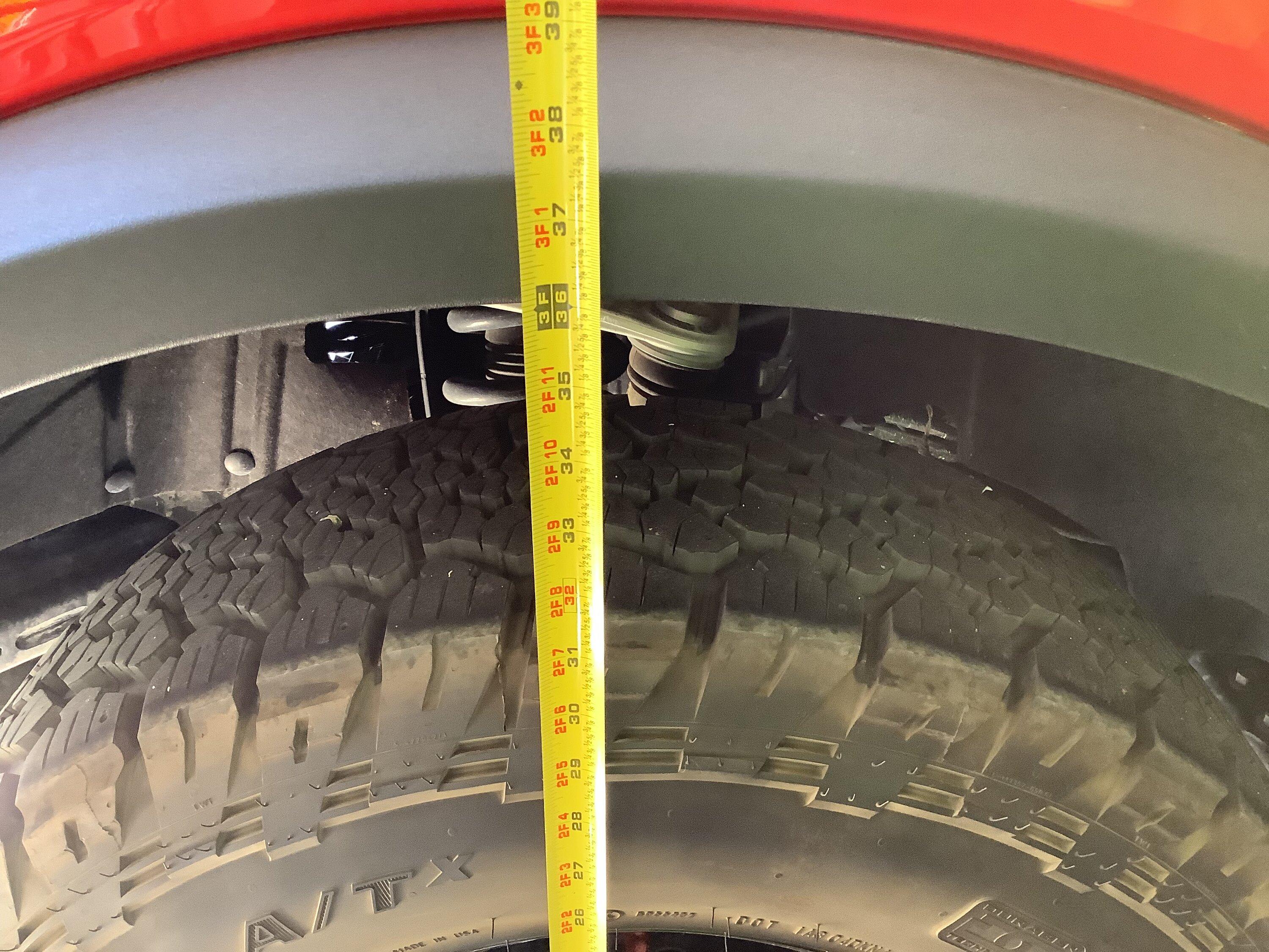

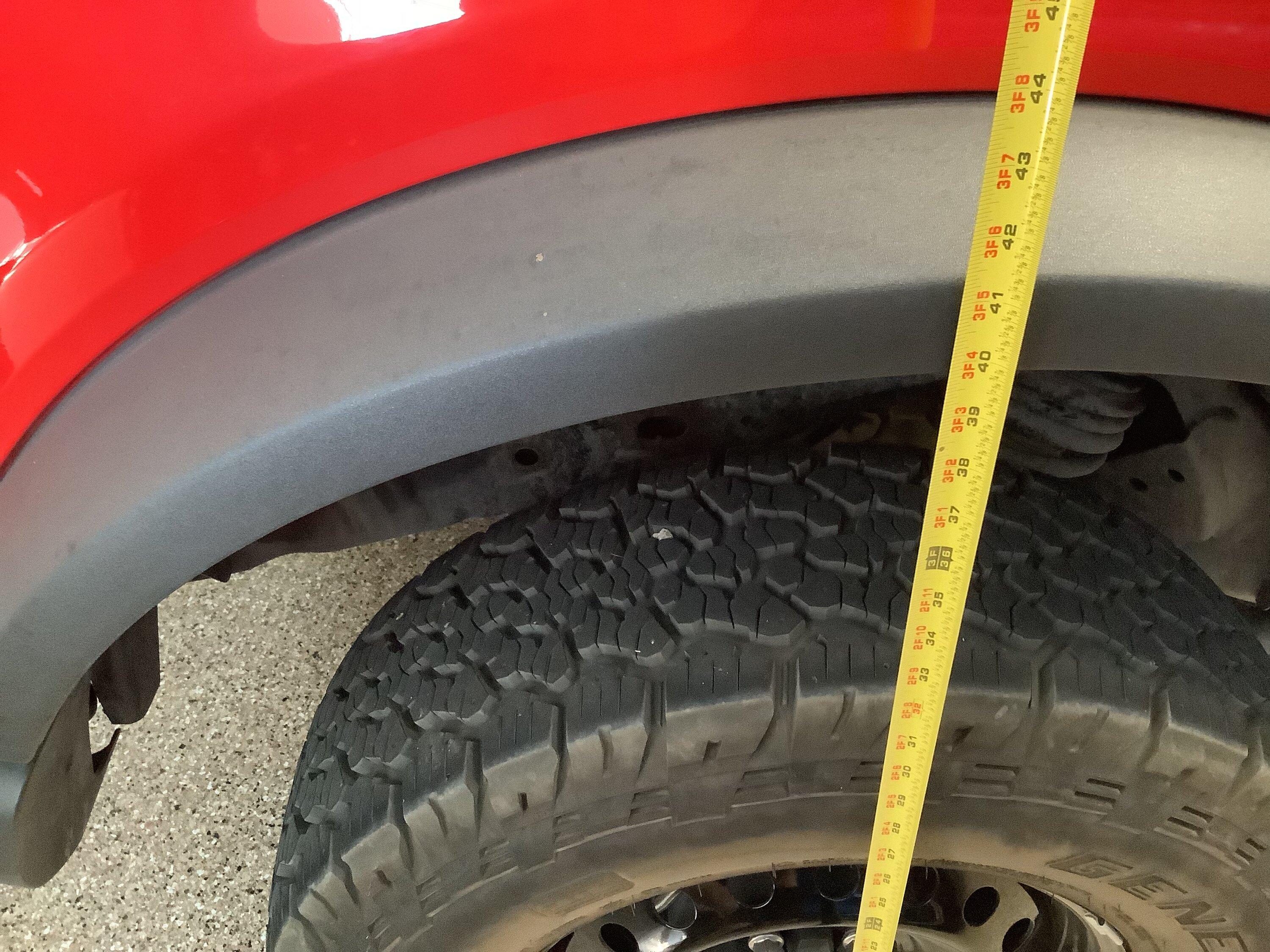

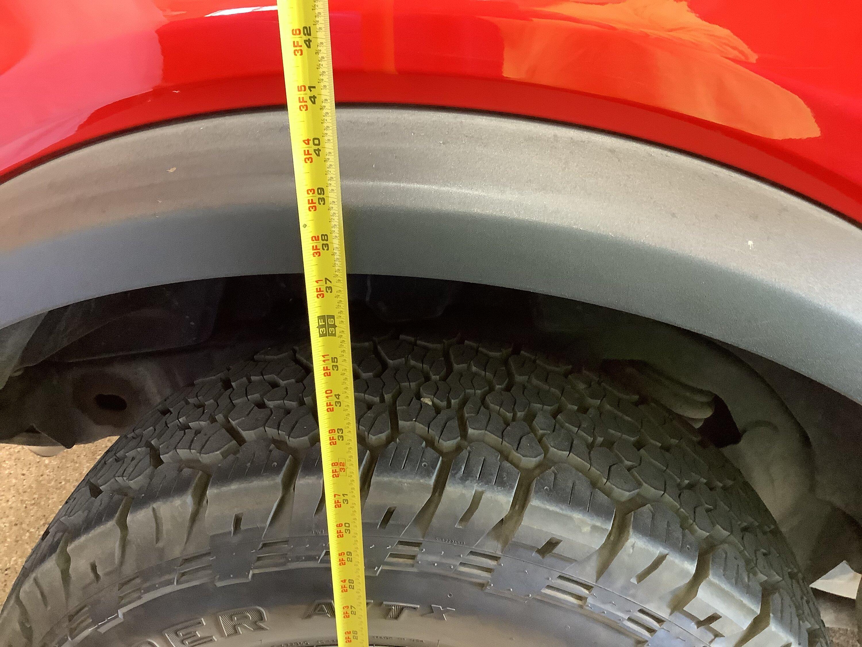

I just put this lift on so I can fit 35 tires I have before and after pictures ,seems to ride OK maybe a little stiffer I have a stock black diamond non-Sasquatch
Ford Bronco Bilstein 5100 adjustable lift shocks installed. Before & after pics (updated with Wildtrak tires & wheels) 8F2A2AB8-DF4C-4233-B35F-FA92FB7C1307
Ford Bronco Bilstein 5100 adjustable lift shocks installed. Before & after pics (updated with Wildtrak tires & wheels) 64749255-491D-443C-8F89-5ACD23A37C4C

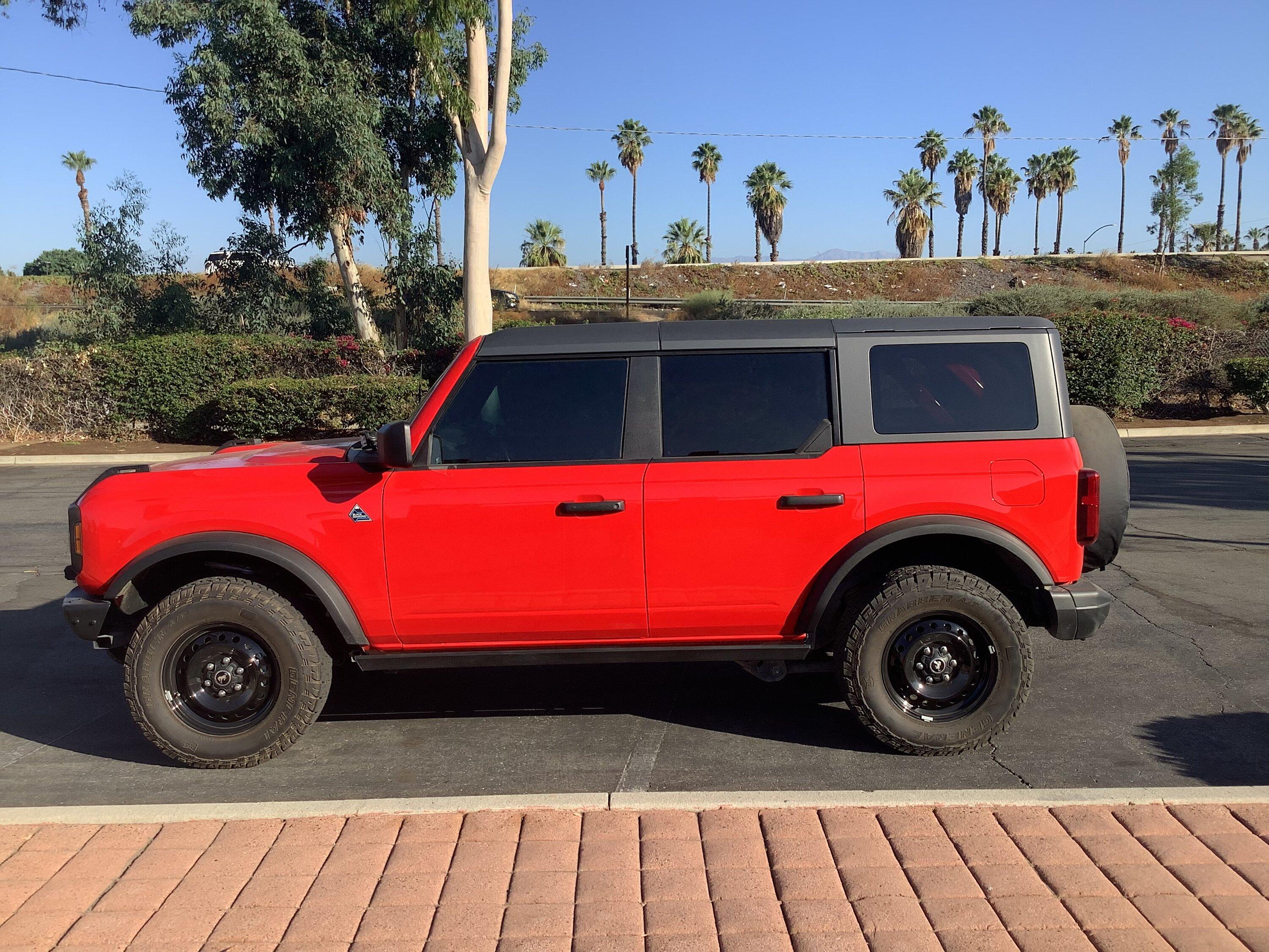

Update:
Wildtrak tires and wheels installed. They look great my speedometer is of by 4-5 miles per hour, need to find someone with forscan, I think it is about 1 inch taller that a Sasquatch package
Looks interesting. Nice color scheme though. Definitely needs bigger tires though. Wonder how good it'll look once you get 35s.

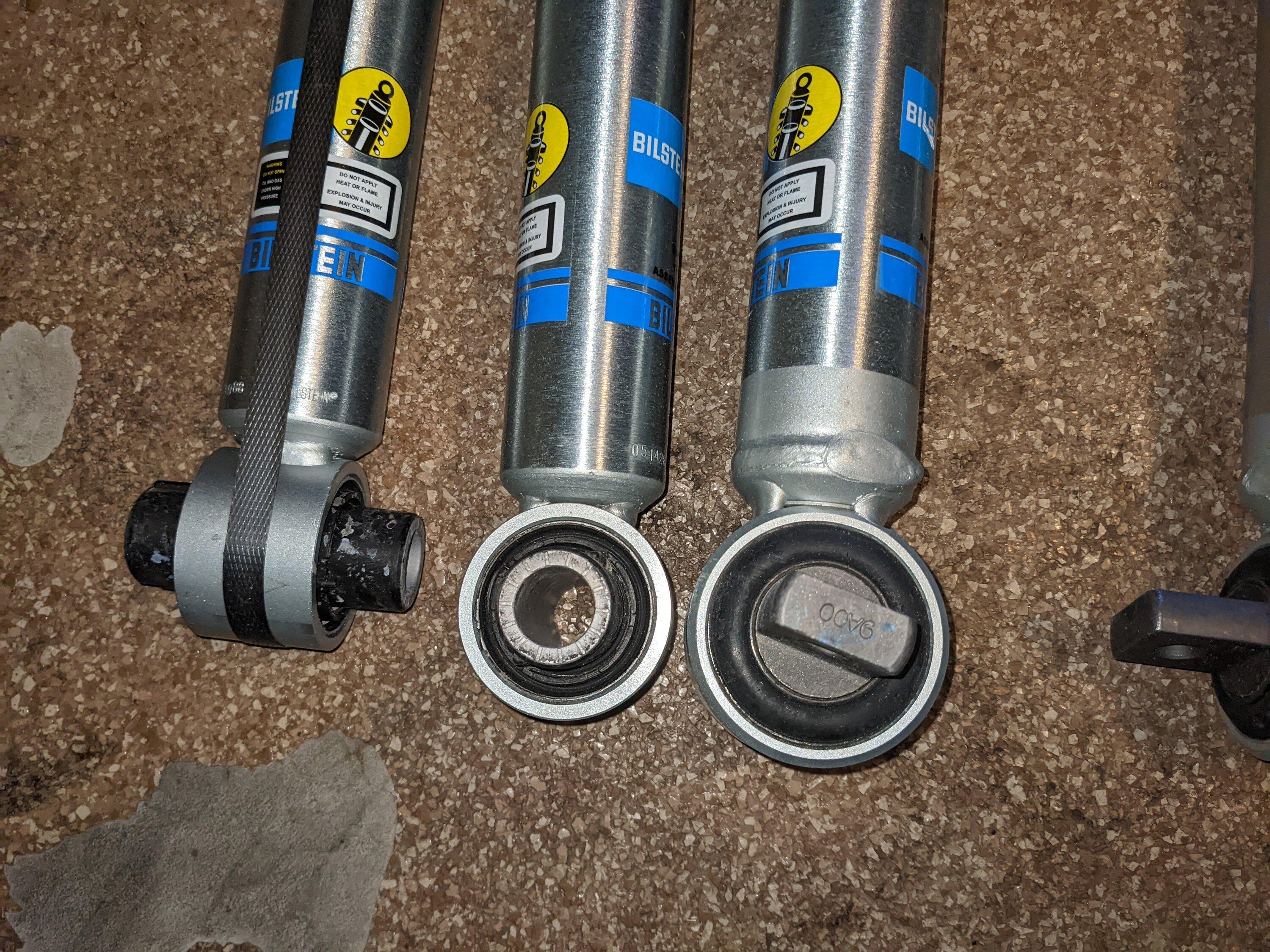

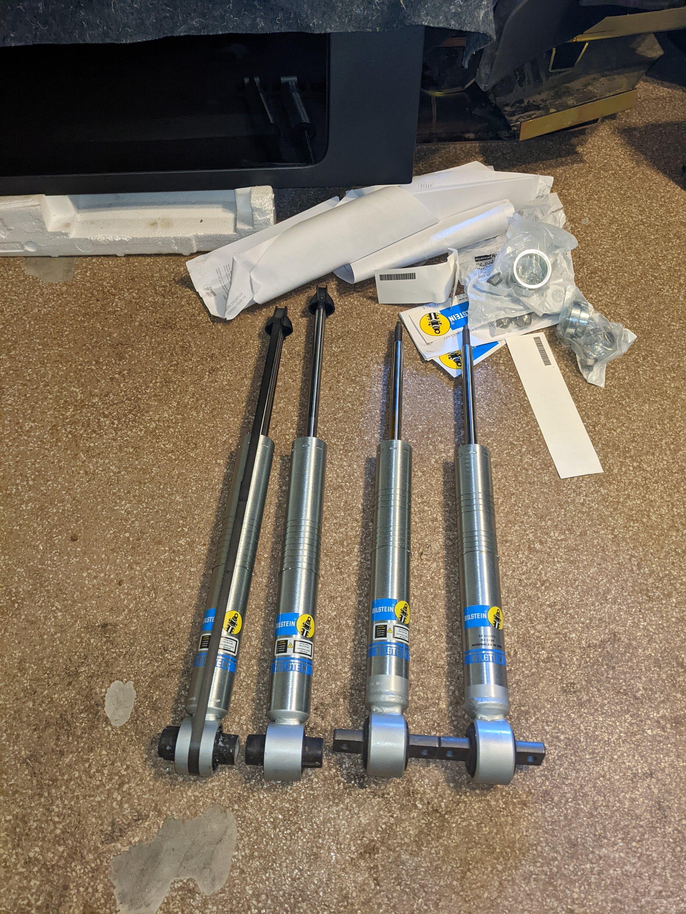

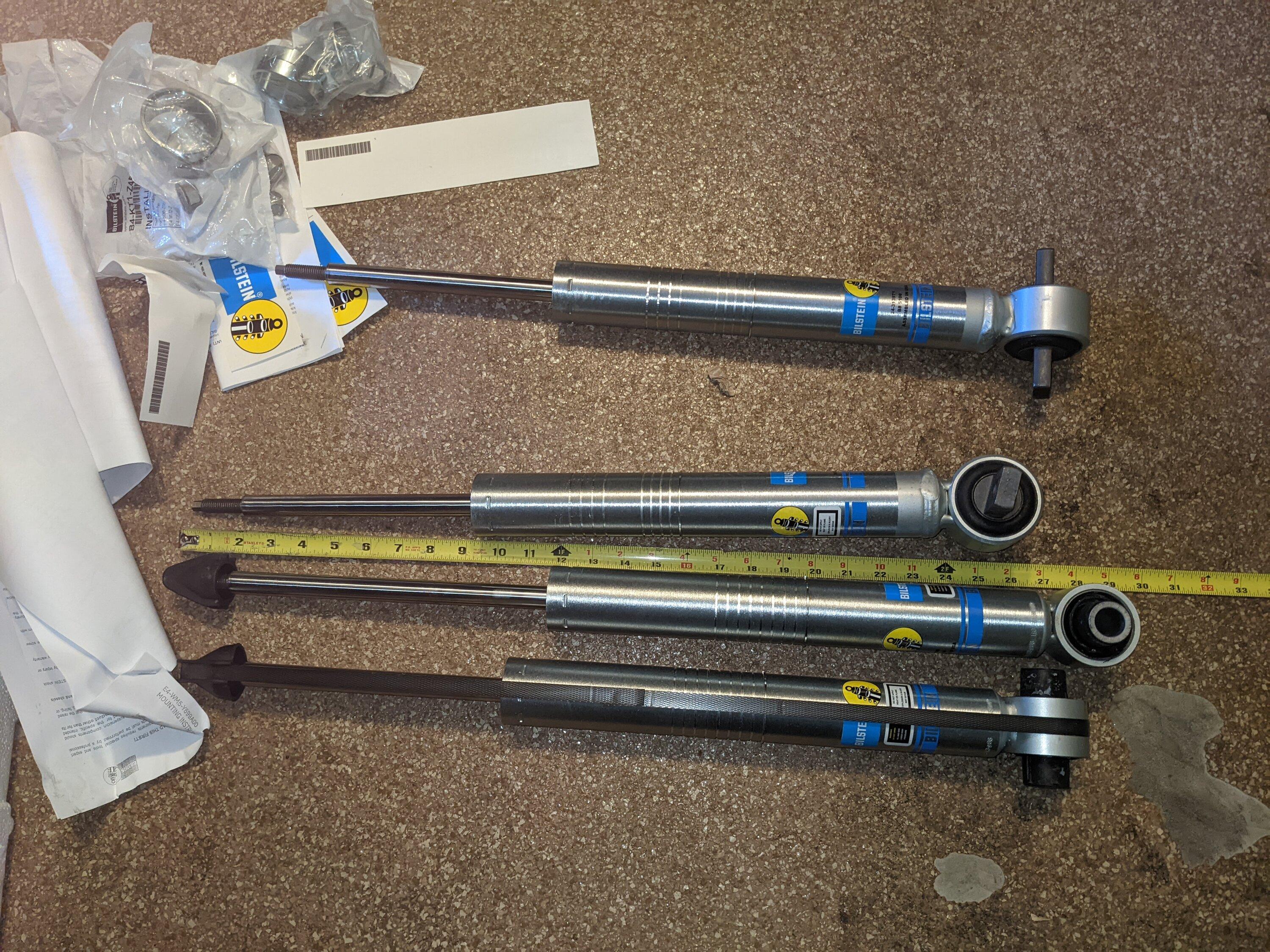

My 5100s came in, now if my next Bronco would show up!
Figured I would post a few pictures of the shock. The welds at the eyelets look bad, but hey it's made in America!

Your going to love those , I sure like mine, and the welds look good to me.

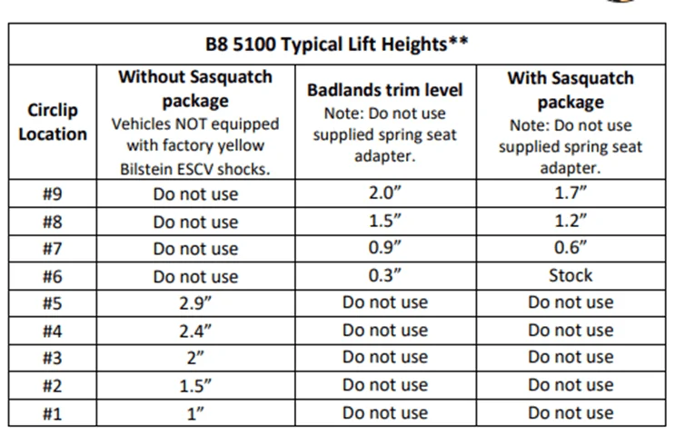

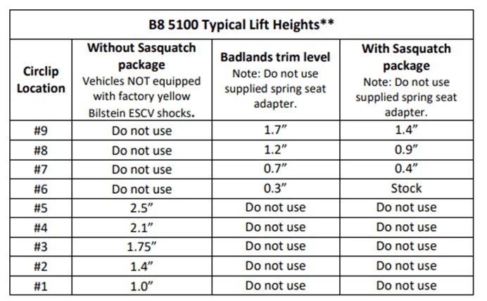

What is the max lift with these?

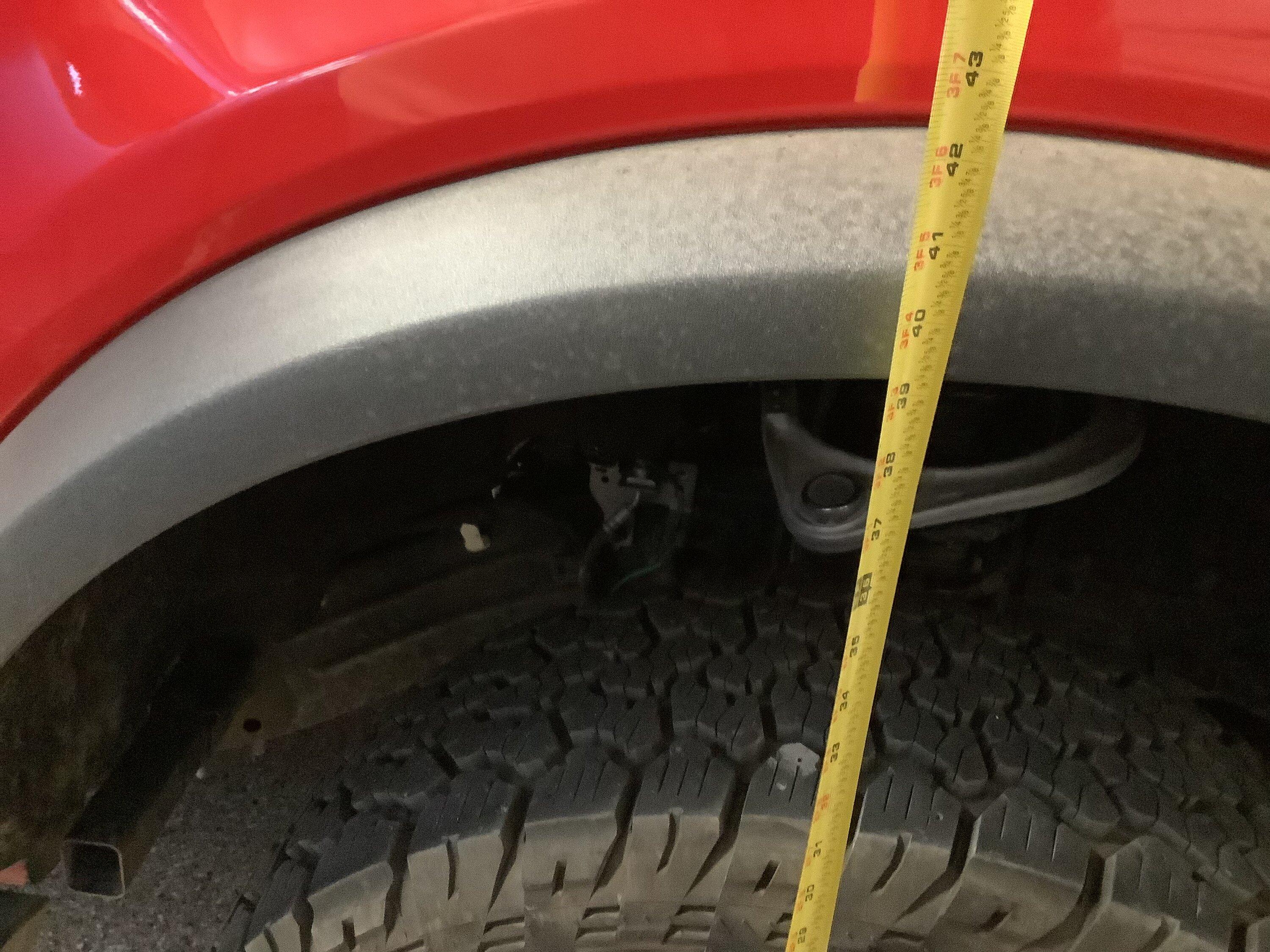

What were your before and after measurements?
kodiakisland
Jul 10, 2020
5,767
16,374
Arkansas
12 Tacoma, 18 Indian, 23 GV70
Center axle to metal fender is the preferred way to measure as it doesn't include the variation in tire size and inflation, but it does appear you gained a couple of inches.
