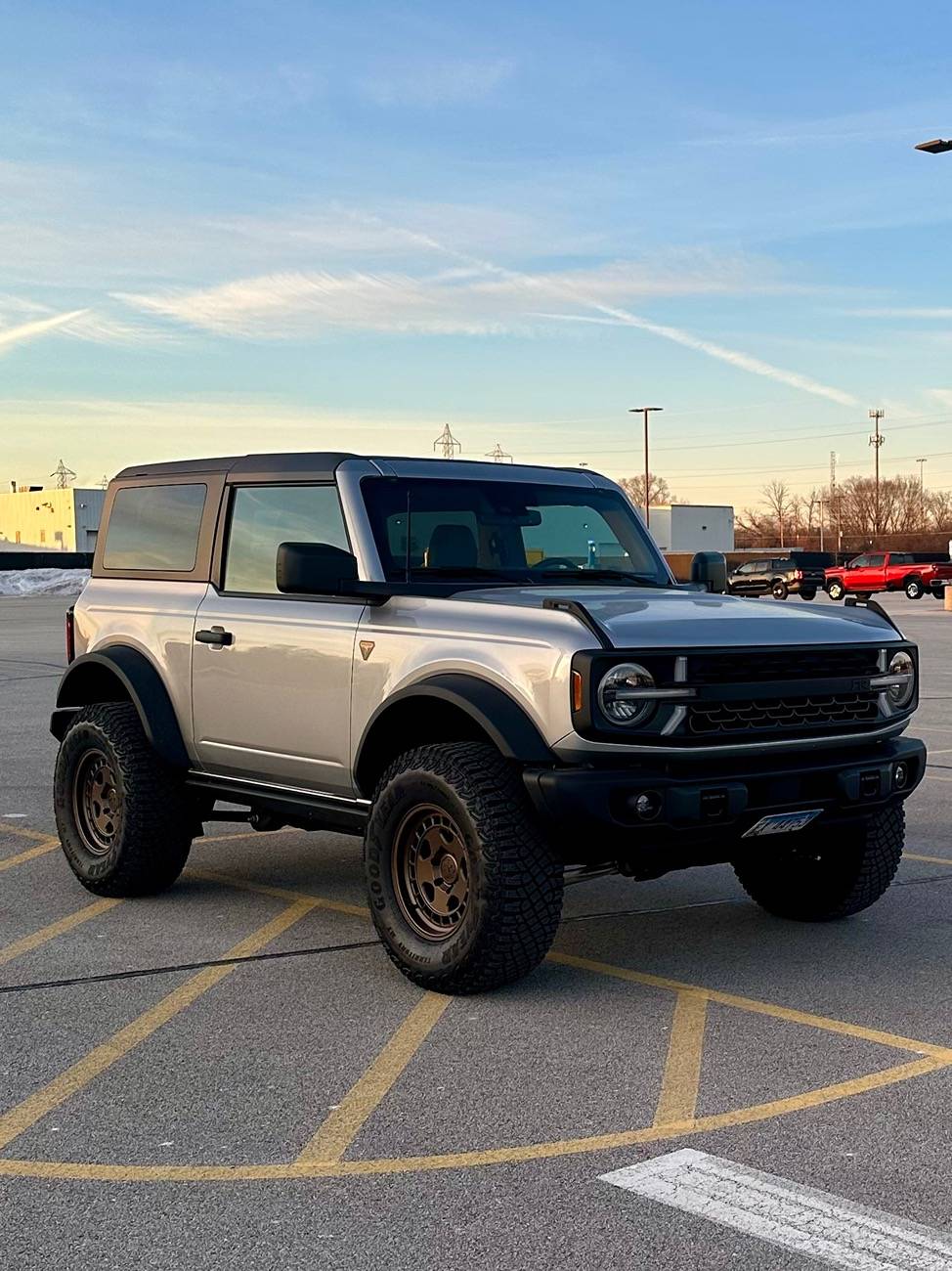

Got these installed this week—purchased from Shock Surplus. I didn’t want to do anything crazy, I’m on assignment in Chicago so I haven’t been living off-road sadly. My goal was a slight lift and reducing some of the nose dive and other less than ideal ride dynamics.
Short review; if you’re looking for something you’d describe as OEM+, this is the move. The ride is better than the stock sas suspension. Firmer, not harsh but it soaks up bumps, high speed turns have no body sway, and braking has no nose dive. Solid, solid package.
Circlip position pictured is #4 f/r which is a slight lift over stock; +1” f/+.7”r.
There’s a little rake still until the rack and other summer camping stuff goes in the back.

If I hadn't seen the pictures and you told me I have bronze wheels on a silver Bronco I would have called you crazy. In my mind that combination does not work. But looking at it, I like it.

Yeah I think because it's such a dark bronze, it basically looks like mud. :) If it was bright I think it would look trash for sure.

Really glad you did this and posted about it. I've been worried the 6100's didn't go below 2" on the 2dr (preferably would like 1.5" with similar rake to stock), so it's great to see what you achieved. And your Bronco looks great! :love:
