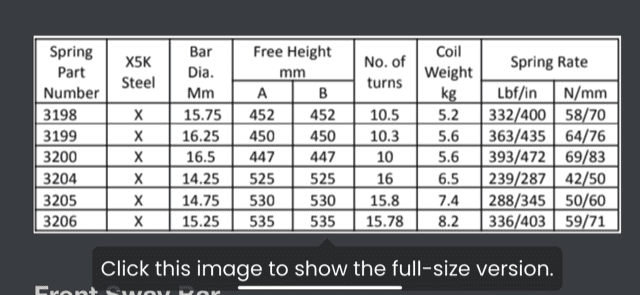

Here are on the spring specs on the OME and Bilstein springs-
Bilstein
47-313996 - Front
Front Main Spring Rate (lbs/in)- 374
47-314009 - Rear
Rear Main Spring Rate (lbs/in)- 288
OME
Ford Bronco Bilstein 6112 installation Comparison to SAS and ARB OME springs 1667096930566

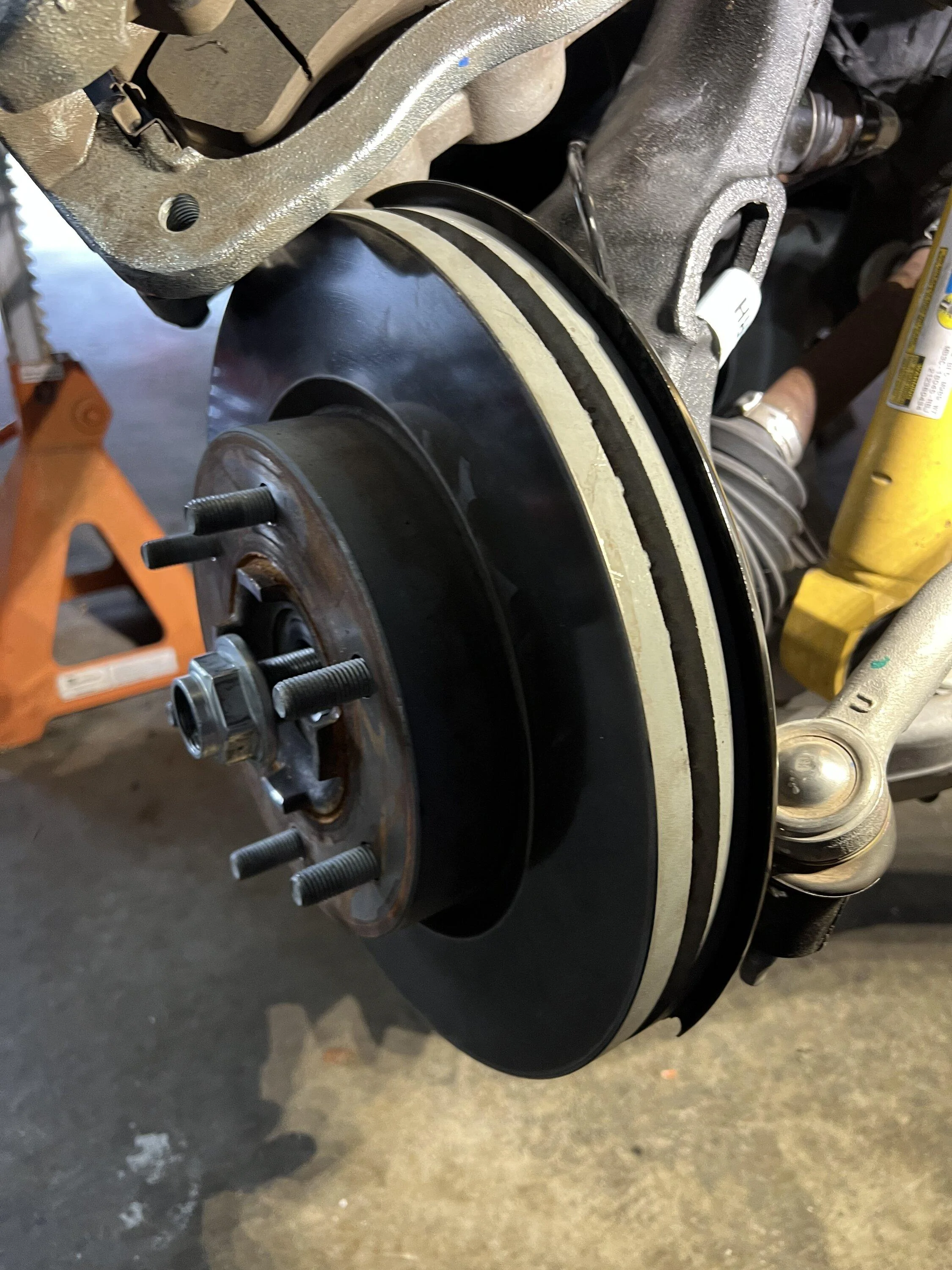

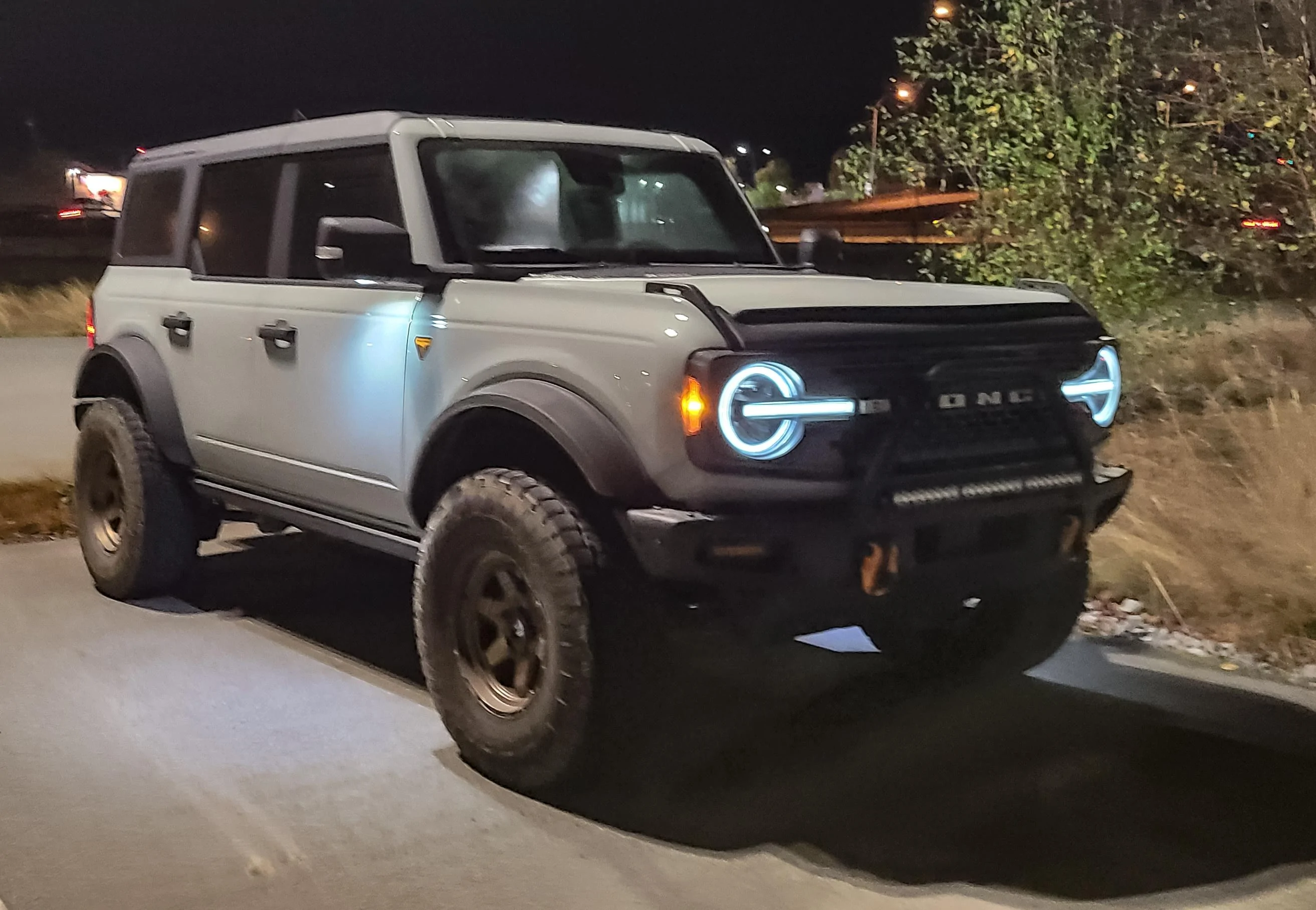

Here are some photos to start the discussion. You can see the front end sag... I hit something really hard at Trail Hero at speed. My front end sits terribly low. I am confident that it would have been fine if I didn't have such low hanging bits. I never hit my diff or rear shock skids for reference.
What do you want to know/see while I work on this???

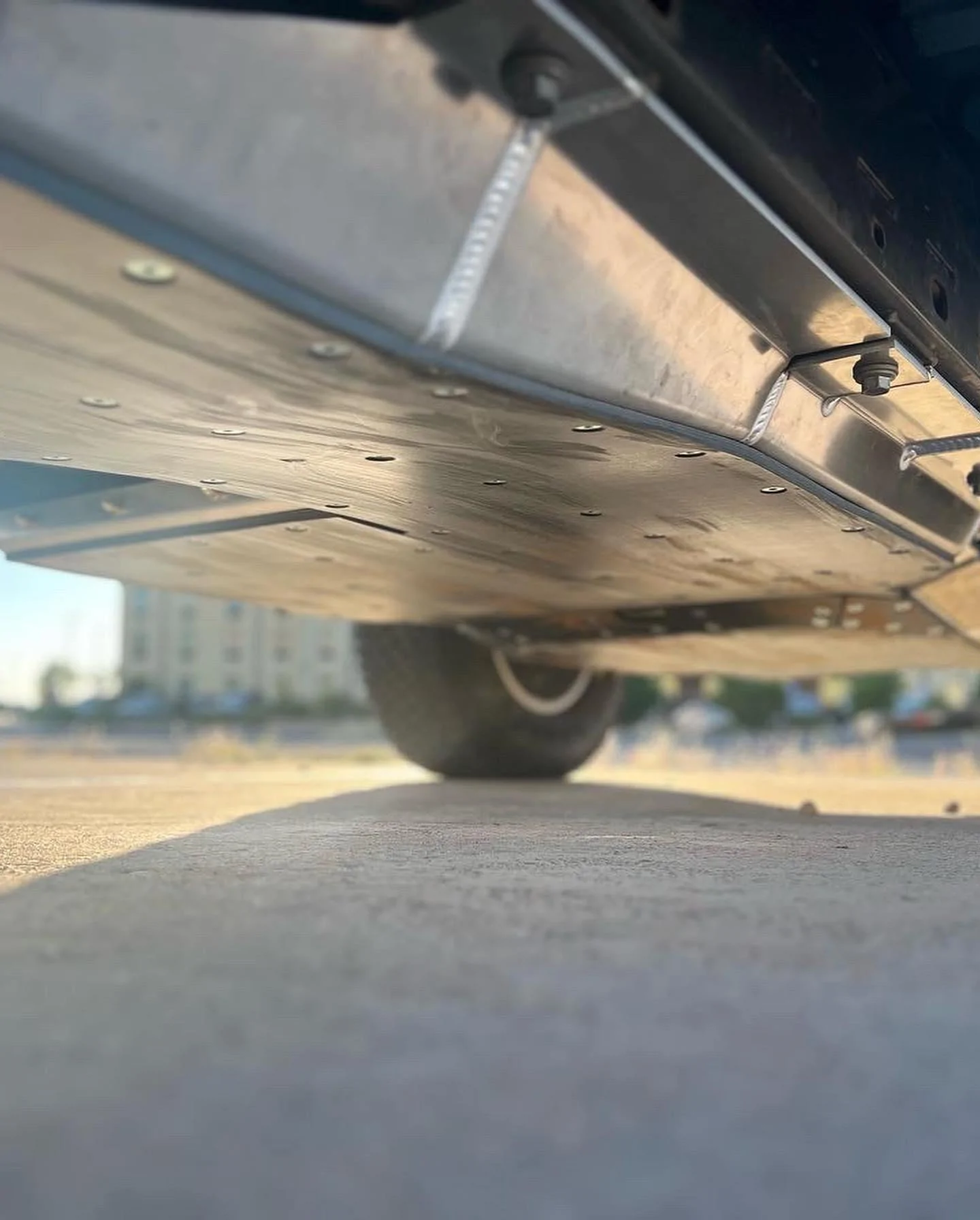

What's your clearance measurement on that skid? It looks like it hangs pretty low.
Yep that is my problem... The skids hug the cross members tightly. I will get some measurements before and after (and compared to a stock Badlands)...
The good thing is the UHMW just slides over everything..

Very Interesting. I like it but not a huge fan of how much rake there is.
Yep, when I het the 6100s, I am hoping that this is the fix. I am thinking about putting the springs at their highest setting up front and mid point in the rear

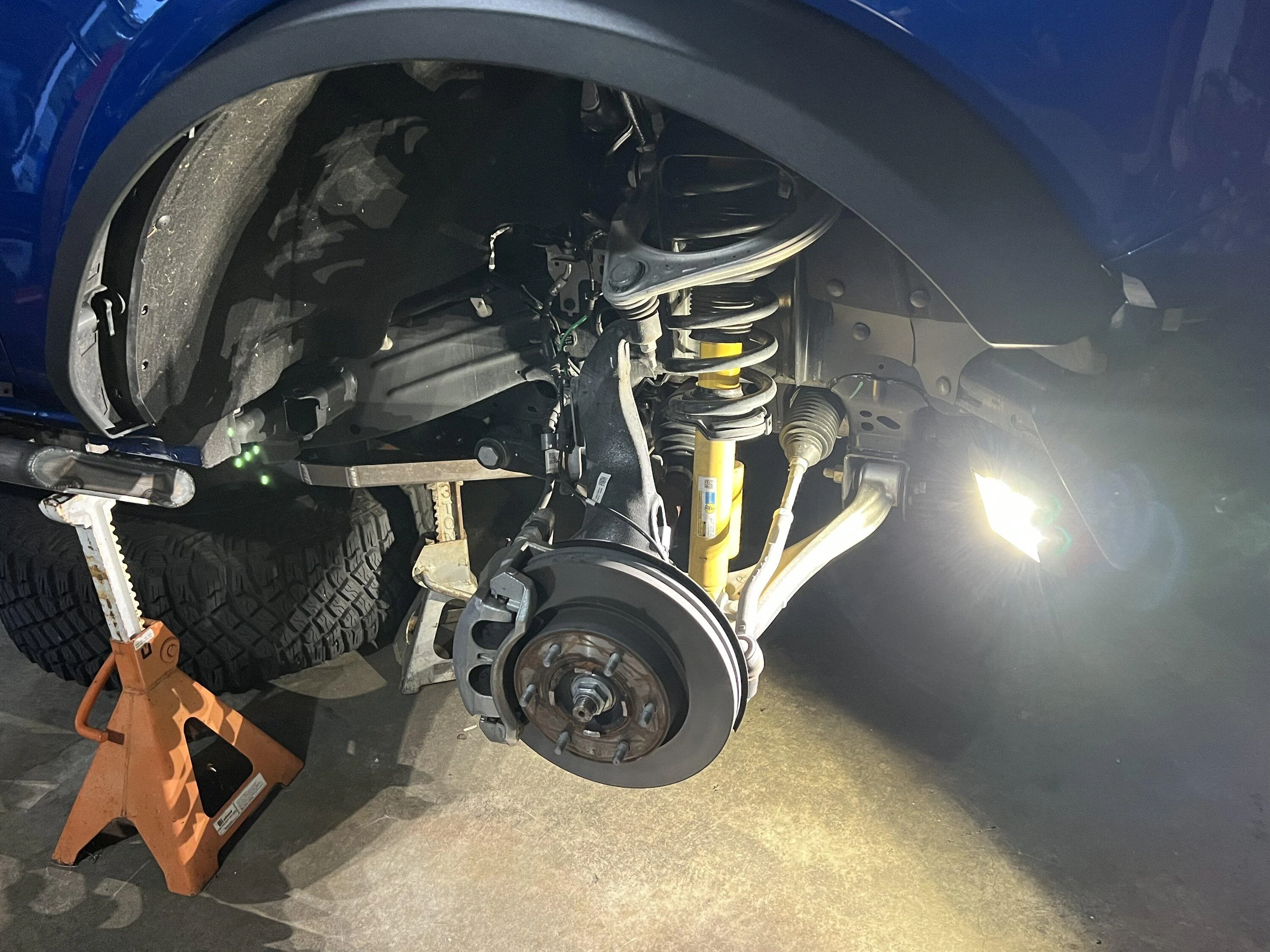

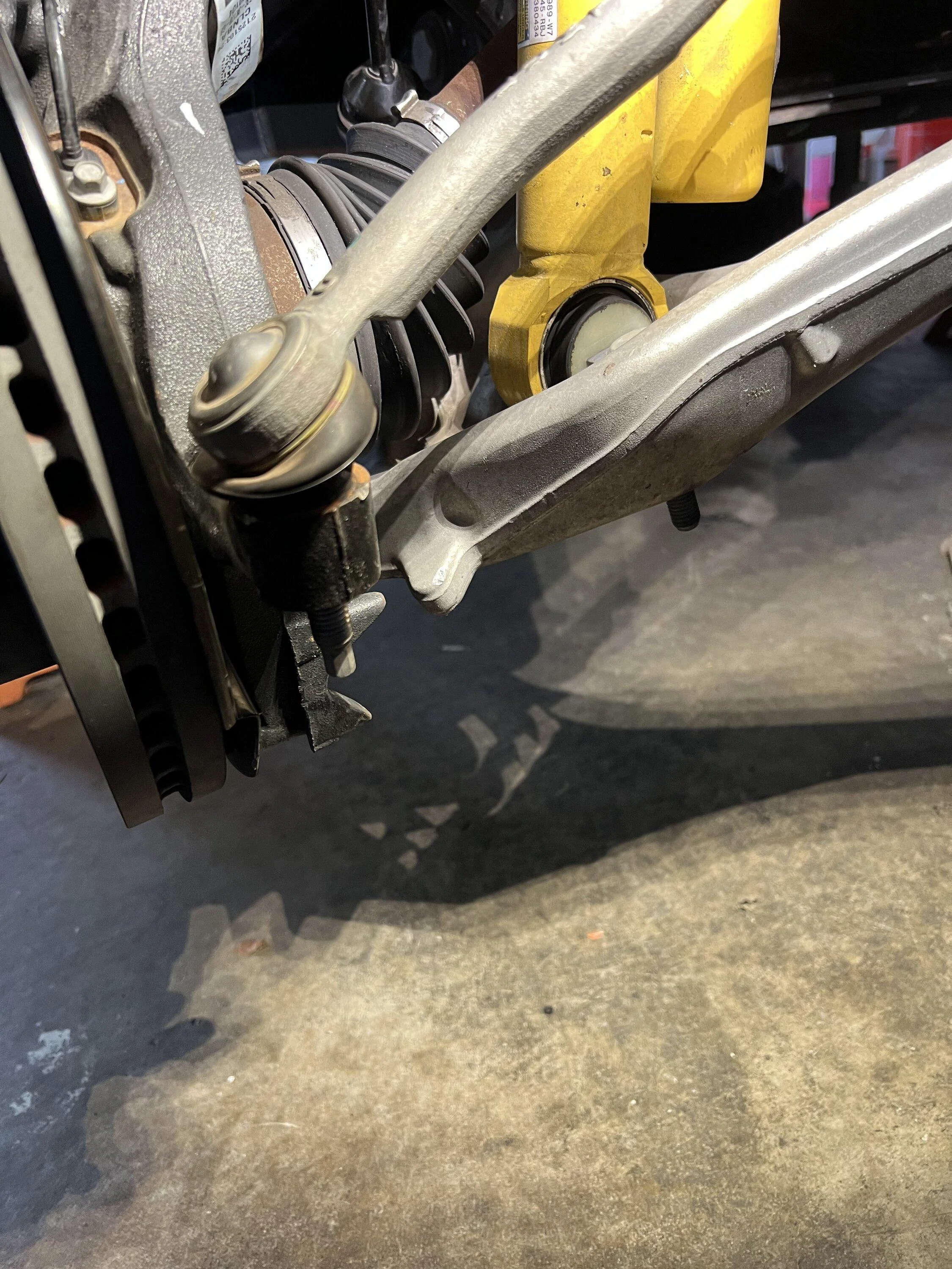

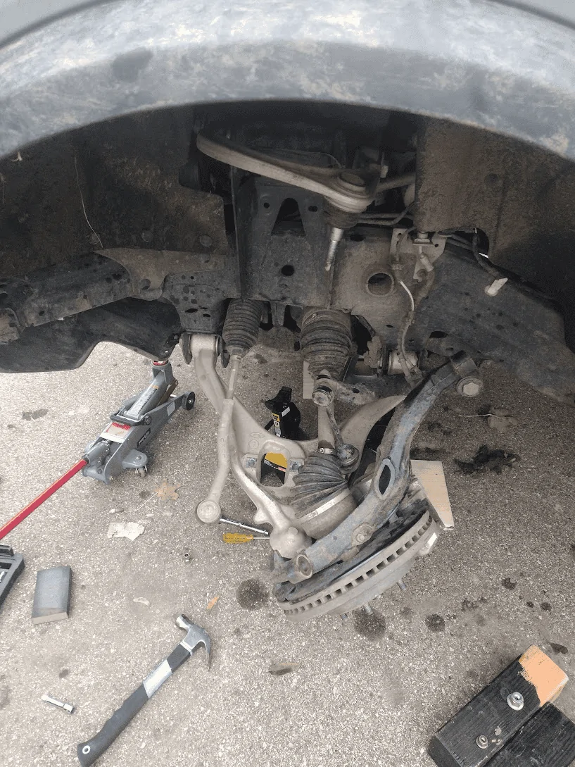

Well I am stuck already- axle won't come out, tie rod end and upper ball joint won't separate. Reluctant to give up and drop the belly skids and sway bar to top the lower a arm.
Any ideas???

I would suggest putting what you’ve taken apart back together and remove the lower control arm bolts.
A lot less likely to screw up your cv joints on the axle.
Agreed. I am working by myself and I have a set of full belly skids that pushed me towards the axle route... and it feels like I already messed up the CV joint. It appears to have separated, but I can't tell.

Your Cv is probably fine you haven't got it apart enough yet to mess it up. Make sure you put a nut back on that upper ball joint and thread it few times, then wack it 3 times with a big f-ing hammer it will pop loose do the same with the tie rod but don't need a nut on. When you go to push your axle through your hub use a puller it makes it super easy. You can use a rubber mallet but it wore me out and gave me a sore back.
You can probably rent this from auto zone or one like it.

You can use a puller to separate the Axle from hub, take rotor off and use a puller that will bolt to wheel studs, or claw arms behind with center threaded bolt to push out.
The Tie rods and A arm bolts are tough sometimes. You can Try one medium ball peen hammer held on the area you hit, then hit that hammer with a bigger hammer. May need to hit it a bunch of times.
I believe dropping the A arm is easier, hate to say.
I have the 6100's. Not really any extra weight up front other than lights and the bull bar... Still has a slight rake. This is front and back set at highest perch setting. They ride fine... And get smoother the faster you drive lol

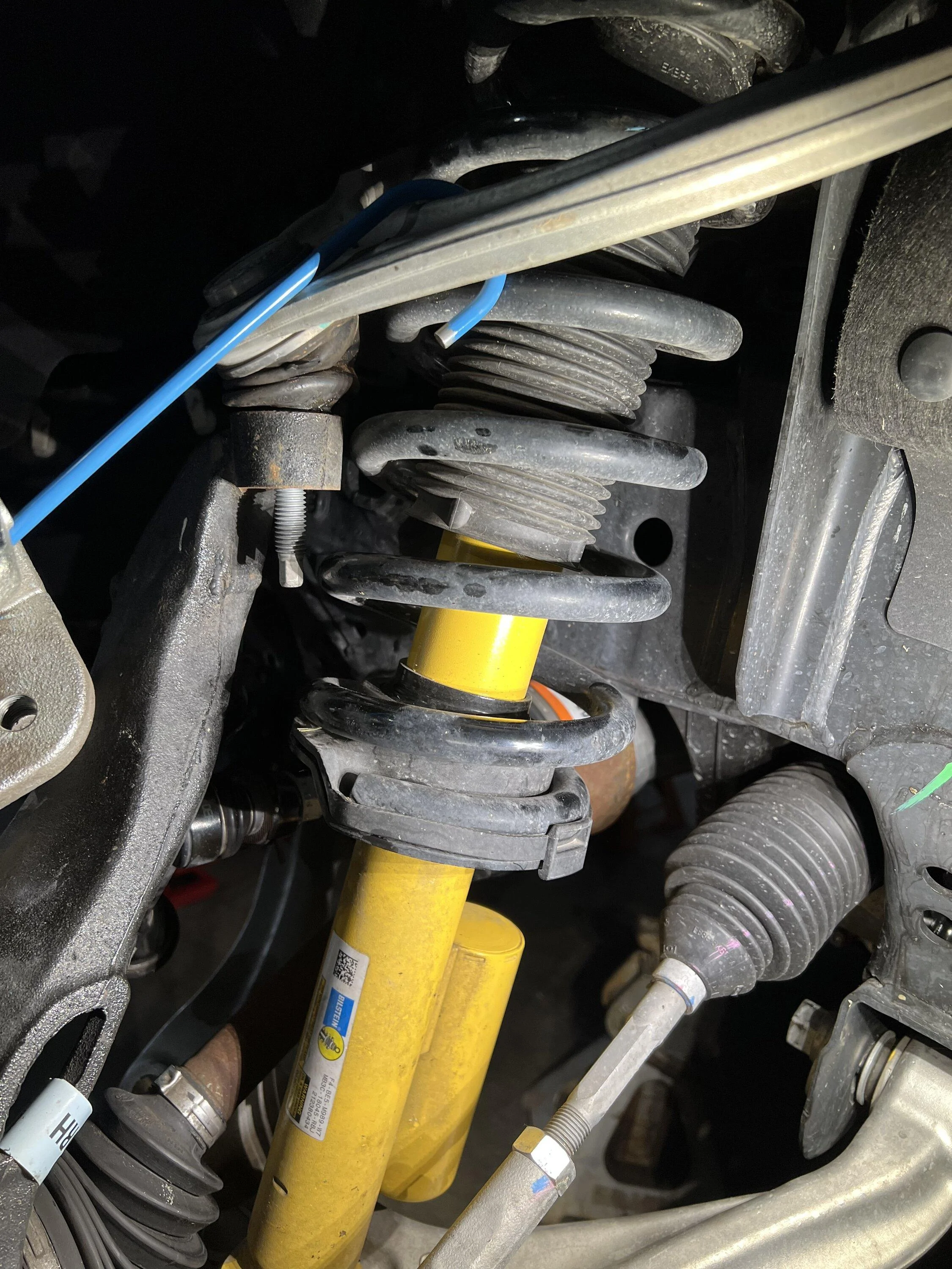

Any ideas???
Are you planning to reuse the OEM strut studs (bottom pair). I got a leveling kit that came with different hardware, mounted bolt head down for better clearance. So I cut the OEM studs off as flush to the control arm as I could get, then hammered the strut out from the bottom, with the aid of a large screwdriver to pry with at the top side. Was definitely a chore, but I was able to get the strut out and back in without touching the axle nut, which seemed like a bigger chore.
In hindsight, I think I should have bought my own hardware for the strut. The RC kit bolts seem a tad undersized, it will be fine all clamped down, but I would have preferred something just a bit tighter in the strut.
As for the tapered studs, I had problems there too. What I did is I put socket on the stud to apply torque to the stud while I hammered the knuckle, I also applied some taps to the bottom of the stud which I think was critical, but you have to be careful not to damage the hex, or leave the socket on the hex when you tap it. A little bit of all this, and it popped right out. Also be careful with the torque you apply to the stud. Apply a lot, but you don't want to strip or shear the hex off, so be cognizant of that.

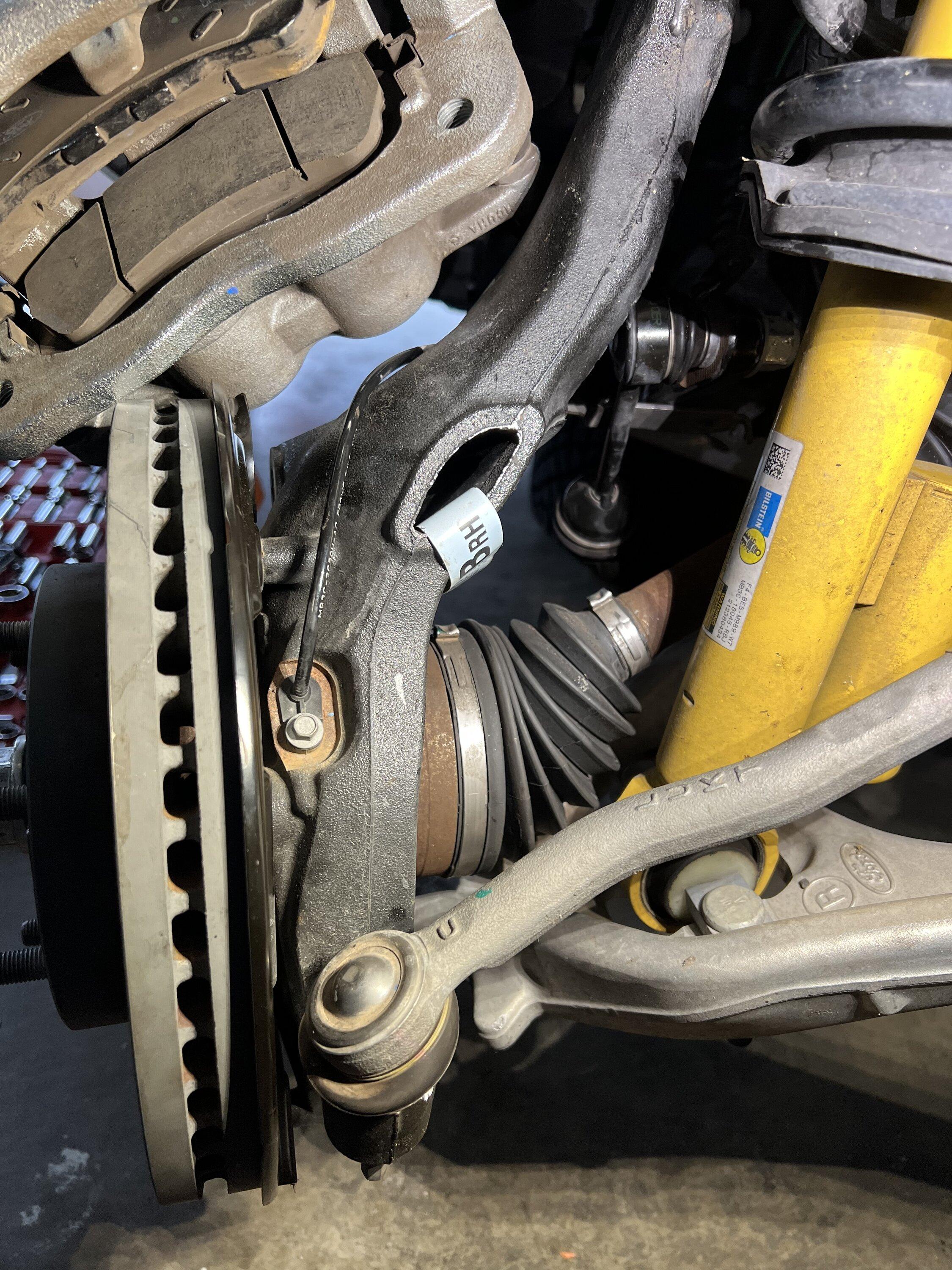

Axle is fully attached here.

The skid plates cover the whole bottom, more like a boat! Its beautiful, but Is there a ventilation/cooling issue with that system, blocking airflow? And you don't want to remove it to do suspension work. I'm rethinking what shid plates I might want.
