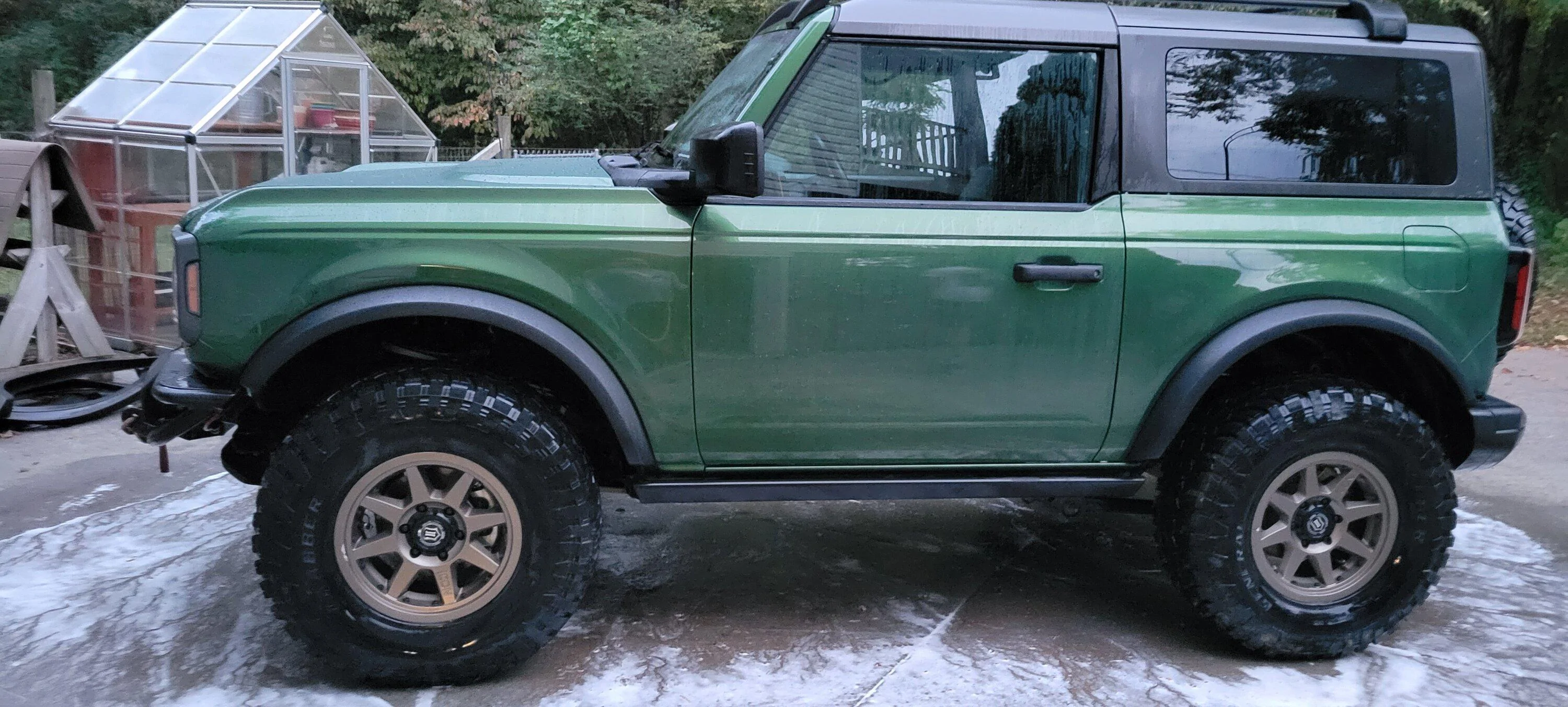

2dr Badlands Non Sas Bilstein 6112s with their springs, 3rd ring up on the front and 2nd ring up on the rear. 315 General Grabber X3s with BAMF bumper, Warn 10k winch, metal skid plates along with aftermarket trans skid. Netted about 2.25" front and 2" rear lift. I installed myself.

what made you decide on 3rd ring in front and 2 in back? Trial and error or luck? curious as I’m about to order these but have 2 dr Badlands SAS and keeping 35’s so was thinking 3 all around

The chart in the Bilstein paperwork, figured in the extra weight of the bumper and winch, decided to go up one ring higher in the front to compensate for the weight of those and pretty much hit my desired lift spot on.

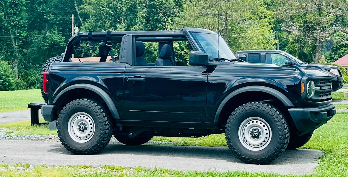

I paid $1700 through Levittown.
They come assembled with Sasquatch springs and top hats. The spring rates and valving are perfect.
No height adjustment like you said, but for an OOTB 2” lift they are my favorite choice.
Do a search, we have a lengthy thread on them.
I’m thinking of buying the fp. I have a 2 door base on 33” tires. Yours looks great. In person will I. E able to notice a big improvement in height? Wife wants to know if it will ride smoother than stock on highway. Appreciate your feedback.
Yes to both.
