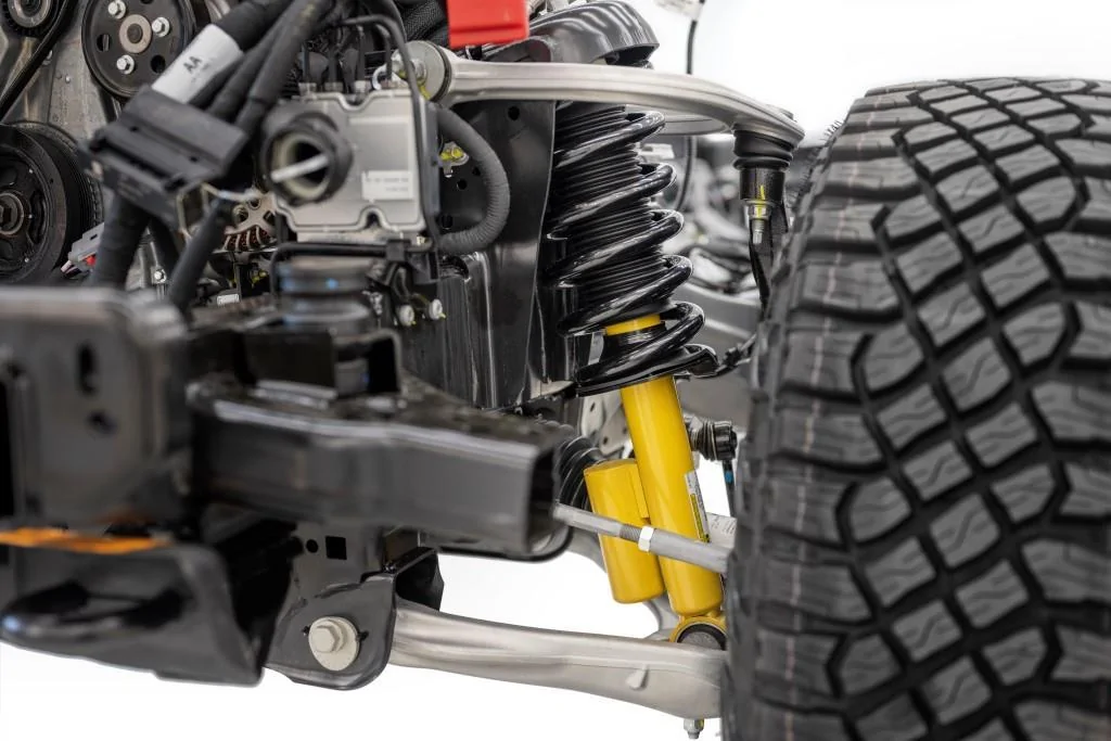

Looks like a relatively standard bypass style shock and they just added a cup and spring on either end of the shock for additional help. You have the hole that allows fluid to bleed into the reservoir as the shock compresses. Once the shock piston moves past that bleed hole, the shock will have significantly more resistance. Couple that with the cup and spring and I imagine that is what they are calling the “End Stop Control Valve”. Looks like the cup and spring are on the other end of the shock as well and will help with control on both the compression and rebound sides, but if I’m remembering correctly on how they are mounted (upside down), the compression side is where they have the most bottom our resistance.
Ford Bronco BILSTEIN ESCV Bronco suspension / shocks explained - "End Stop Control Valve" Dampers (Bronco HOSS Suspension w/ Position Sensitive Dampers) FordBronco_parts_09 - Copy

The question is, is it worth the jump up to Badlands from BD, or would an aftermarket install with suspension upgrade in the future work just as well?
King and Fox both make Internal Bypass shocks that work incredibly well. Both have the same function but just go about getting to the same result a different way. King uses a needle into the shock shaft and fox has a twin tube design. There are pros and cons to each one, but you can’t really go wrong with either. I prefer King, but plenty of people use Fox and both companies have trophy truck drivers winning races so I don’t know that one is “better” than the other.
Fox’s video is the best explanation of how an internal bypass shock works, and King’s video just shows you how they do what Fox does just without a sleeved shock.
Oh, and Fox then has the Dual Speed Compression adjusters (DSC). DSC is pretty dope, to be quite honest. Wish King had something like it.
King IBP:
Fox Internal Bypass:
Fox DSC:

That's a loaded question.
Application dependant.
T
King IBP:
Fox DSC:
The Fox DSC kit for the Ranger is like $4000 if anyone is curious what the cost will be.

Reservoir for extra fluid volume
The Sasquatch is available on all trims and with it you get all of the cool off road stuff that is part and parcel with the two highest trims; Badlands and Wildtrak. With the exception of the sway bar disconnect and wheel tire combo on the BL (but it is available with a reduced SAS cost).
If the BL is out of reach, go with a BD with Sasquatch. If the Wildtrak is more your speed, but not pocket book, then a BB or OBX with Sasquatch All you will give up is the High and Lux packages. There is also the Base, and if you put SAS on it, it’s damn near an off-road purpose built monster under $35k straight from the Factory.
Any Bronco with SAS is more than 98% of us can probably take full advantage of.
I really don’t think you can go wrong in any trim, in any configuration. You could always get the most vehicle now but wait for aftermarket. The Bronco is awesome!

Yea, the Fox and King internal bypass shocks are not cheap. They’re good, but it will be application dependent on if it makes sense to upgrade the existing Bilstein‘s to something different. I remember 3.0 shocks for the Raptor, without DSC, being somewhere around $5000 for Fox. if you wanted DSC it moved it closer to $6000 or so if I’m remembering right.

End stop control valve video. Can't find much on these dampers yet. Looks like a bottom out hydraulic cone and spring?
Anyone else have any thoughts. Someone said the ESCV was active but I'm not seeing it.
