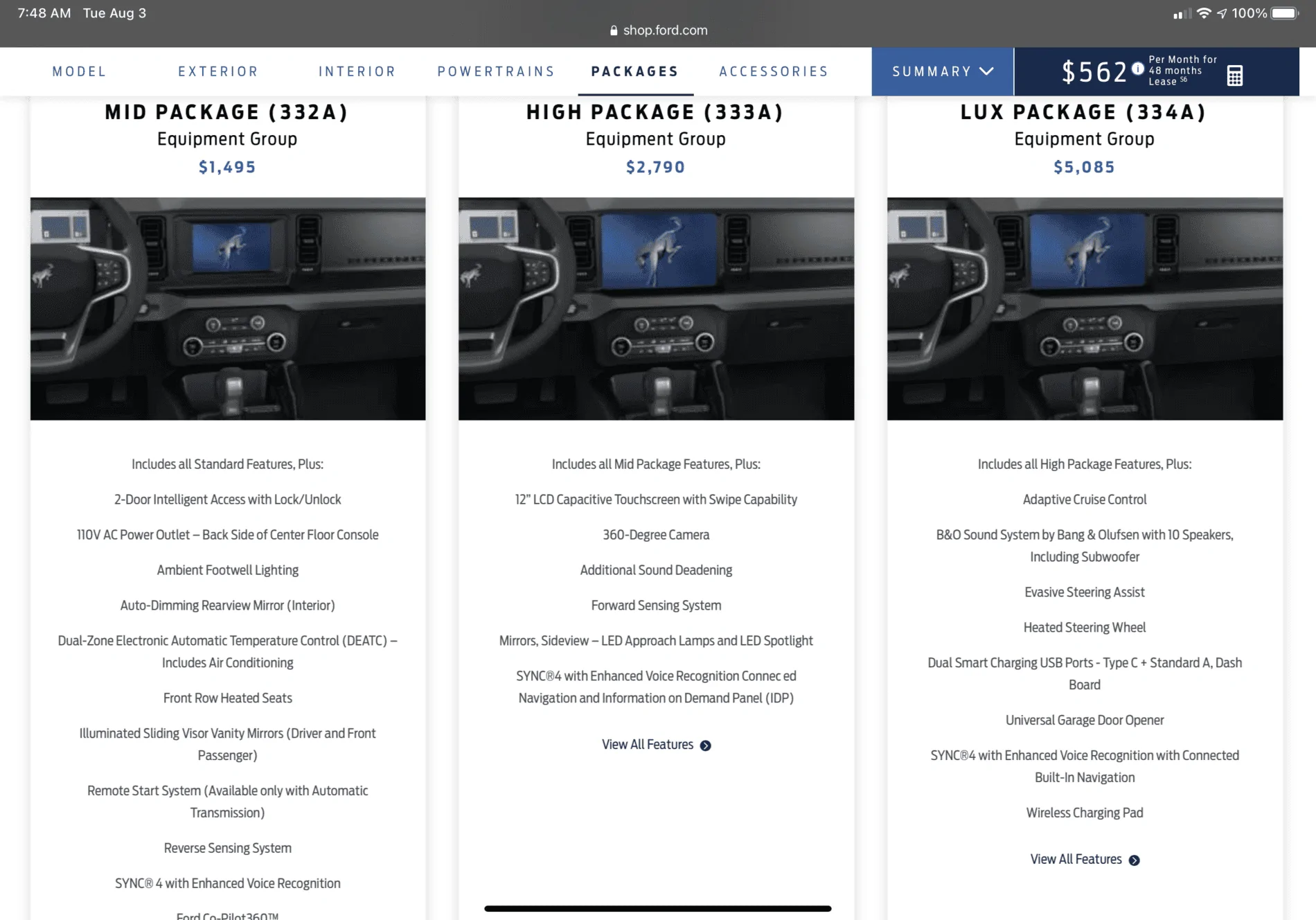

Then there are the packages you can get with a manual on BL:
mid package with manual trans, I like copilot 360 safety features, heated seats, auto dimming mirror, intelligent access, reverse sensing system. No brainer for $1495.
high package with manual trans, I like 12ā€ screen, 360 cameras, forward parking sensors. Definitely worth another $1295.
lux package for those who want adaptive cruise, B&O stereo, heated steering wheel, evasive steering assist. I donā€™t have this on my order, but for another $2295 I probably should.
I originally ordered BD with minimal options for $39K (2 door). The difference to go BL High package is $8500. There is so much stuff that canā€™t be replicated aftermarket in that $8500 that I couldnā€™t see going BD.

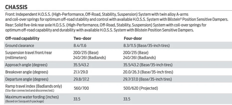

Good info from everyone, the mid package may be worth it, although Iā€™m pretty much a low technology guy in my vehicle. I want it to run and be able to get flooded in a downpour and still operate.
One thing I did find interesting - is there a bit of a lift with the upgraded shocks/suspension with the Badlands for the 33ā€™ tire? Iā€™ll research the sway bar disconnect a bit more, my JK X doesnā€™t have it, but it hasnā€™t seen rocks since it was 2 or 3 years old. Just sand/mud.

There is a bit of a lift with the Badlands suspension. The base suspension clears 33's without issue, though.

This thread said that the Badlands is .67" taller than lesser trims because of suspension only.
https://www.bronco6g.com/forum/thre...ide-lift-heights-with-wheel-tire-sizes.17719/
The Badlands has more suspension travel with those Bilstein shocks.
