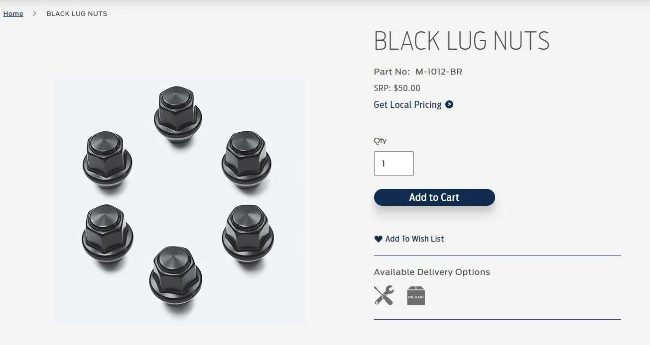

Same. Looking to powder coat my beauty rings black and get black lug nuts. Was looking at these from Ford.

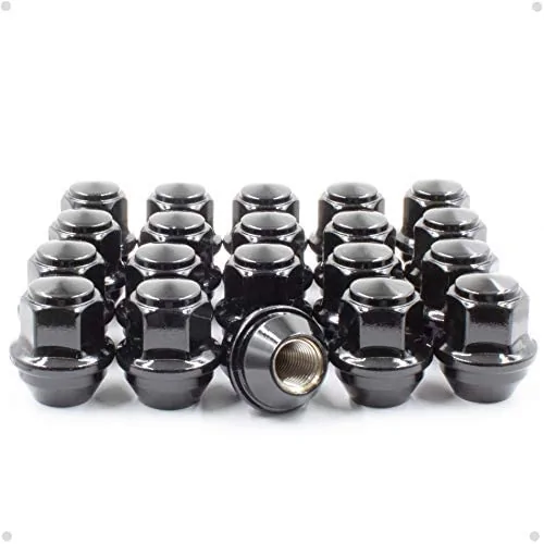

I can't speak to the bronco, I swapped the lugs for black one piece steels on my badlands sport. The OEM was the two piece bloat nuts and the spline type I originally purchased were too small at the rim seat. The OEM are bulge acorns. I found black ones on amazon
Ford Bronco Black Lugs & Wheel Locks 41Lc+tnKBjL._AC_SY1000_ Lugs 12x1.5 bulge one piece

Does the Bronco use 60 degree cone lug nuts?
79bronco
Jul 11, 2021
following a few links in links on sites, it appears the Ford Ranger 2019-21 shares the same lugs as the Bronco 21. Tracking the Ranger sites, yep, same deal. The 60 Degree bulge cone lugs pretty much the same ones I had to purchase for mine. Most of the guys wanting black lugs on the rangers ran into the same issue I found. The seating area was too small compared to the OEMs. Take it for what it's worth. Cross-referencing from levittownparts shows the match. The link I shared, looks like they may be out of stock, it's now a dead link, just checked it a few hours ago, that's my best guess.
