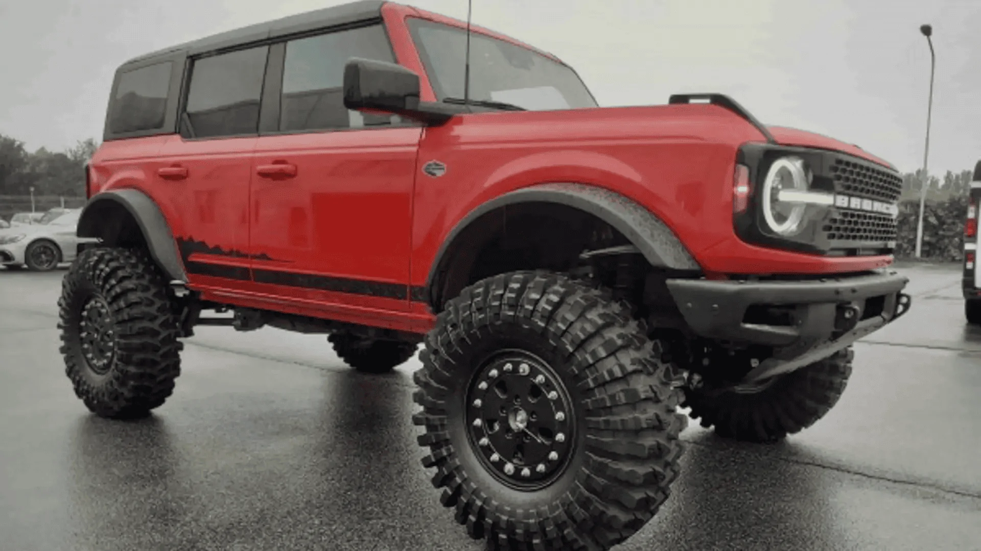

Yes, I forgot to add that this is not a Zone lift, it is a Bronco Bigfoot Lift and I had Camburg UCA's. I think what caused the axle's to blow were the fact that the spacers were compressing the springs tighter then they should have been, and thus causing a faster rebound. The spacers already caused a stiffer ride with the additional compression. I believe if you're going to do some hardcore off-roading like we were doing, constantly maneuvering over boulders, then spacer lift's are not the way to go.

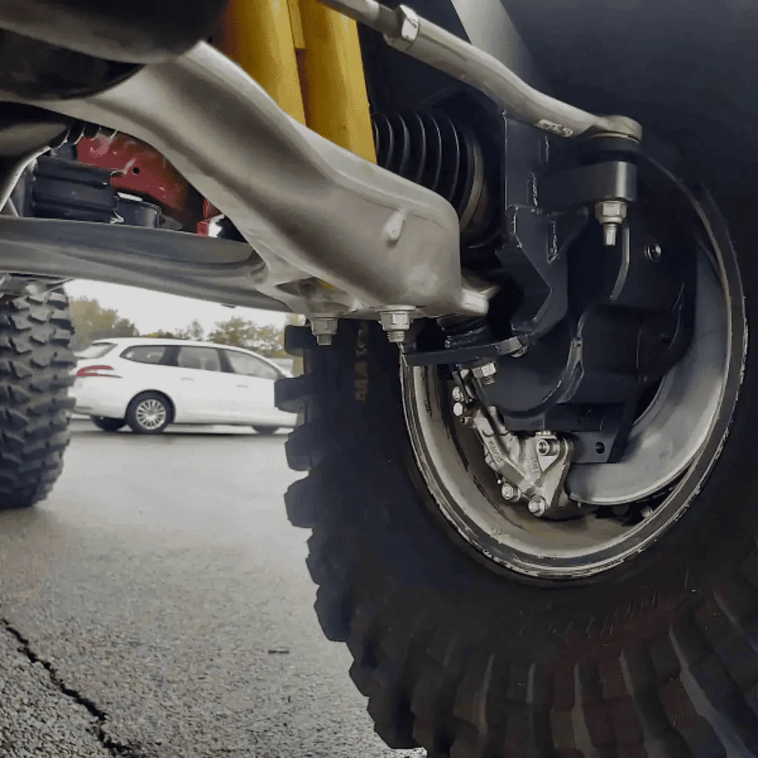

Just a little update: I got the Radflo's installed and they are A M A Z I N G! They are adjustable with a dial on the reservoir that controls how hard or soft the compression and rebound can be. I also installed a front differential drop bracket to lower the angle of the CV axle's to be more linear. The pics are before I tightened the bracket bolts. Oh, and I also took off my rear swaybar for better articulation.

I just received my radflo shock a few days ago. Could u post a few pictures of where u mounted the remote resivours for the front?
