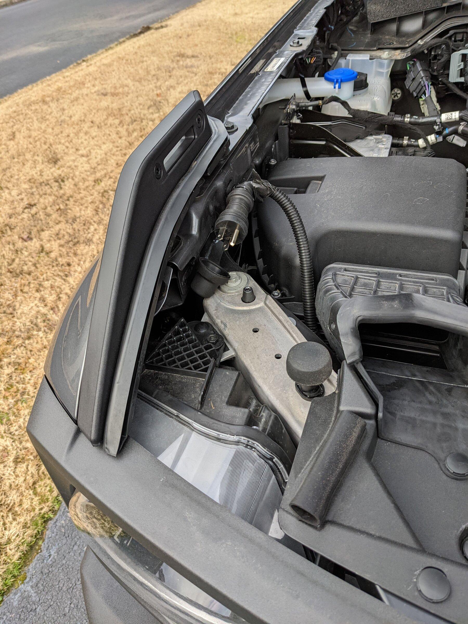

It is under the hood on the passenger's side. Sort sits between the air cleaner opening and the fender. Very inconvenient and sort Dodgeish.

It's it where you expect it... first time I have ever owned a vehicle where you have to open the hood. both broncos came with it in that spot. There is a rubber cap over it

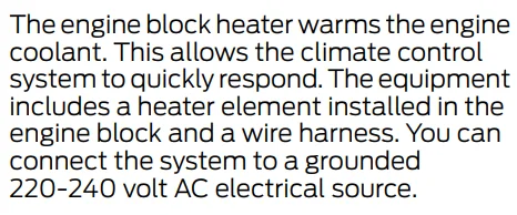

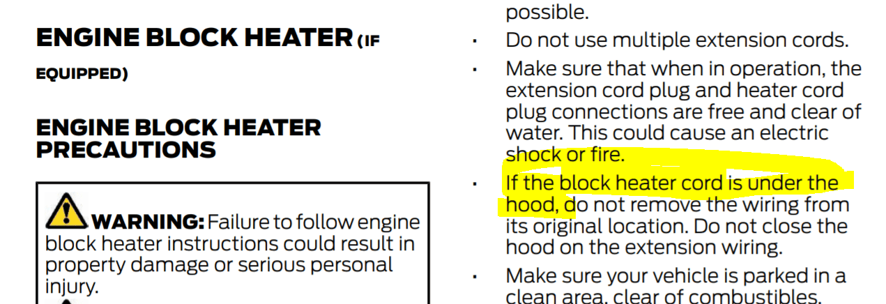

Finding it is the easy part. Figuring out how to plug this into 240V is the hard part! :LOL:
