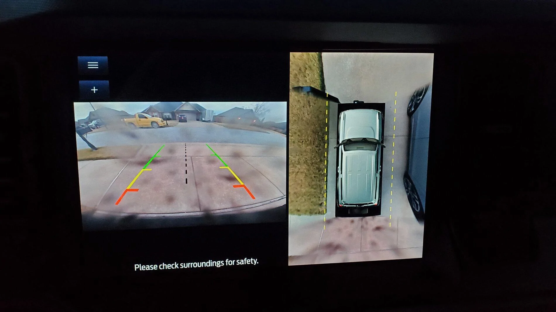

Looks pretty good. Would you be able to provide some more pics from the side and maybe top down.
Also a view of what the front camera sees with that bumper.

How bout a picture of the interior screen with the camera activated please :)

Front Camera View. You can see a part of my custom ACC bracket that will eventually go away. Sorry for the dirty rear camera.

Not bad at all. Thanks for the proof as that is obviously very acceptable!

The camera view looks way better than I would’ve thought possible.
Unrestricted front view in Baja mode on big screen as well - except for the temporary bracket of course?
Thanks for the pics!
