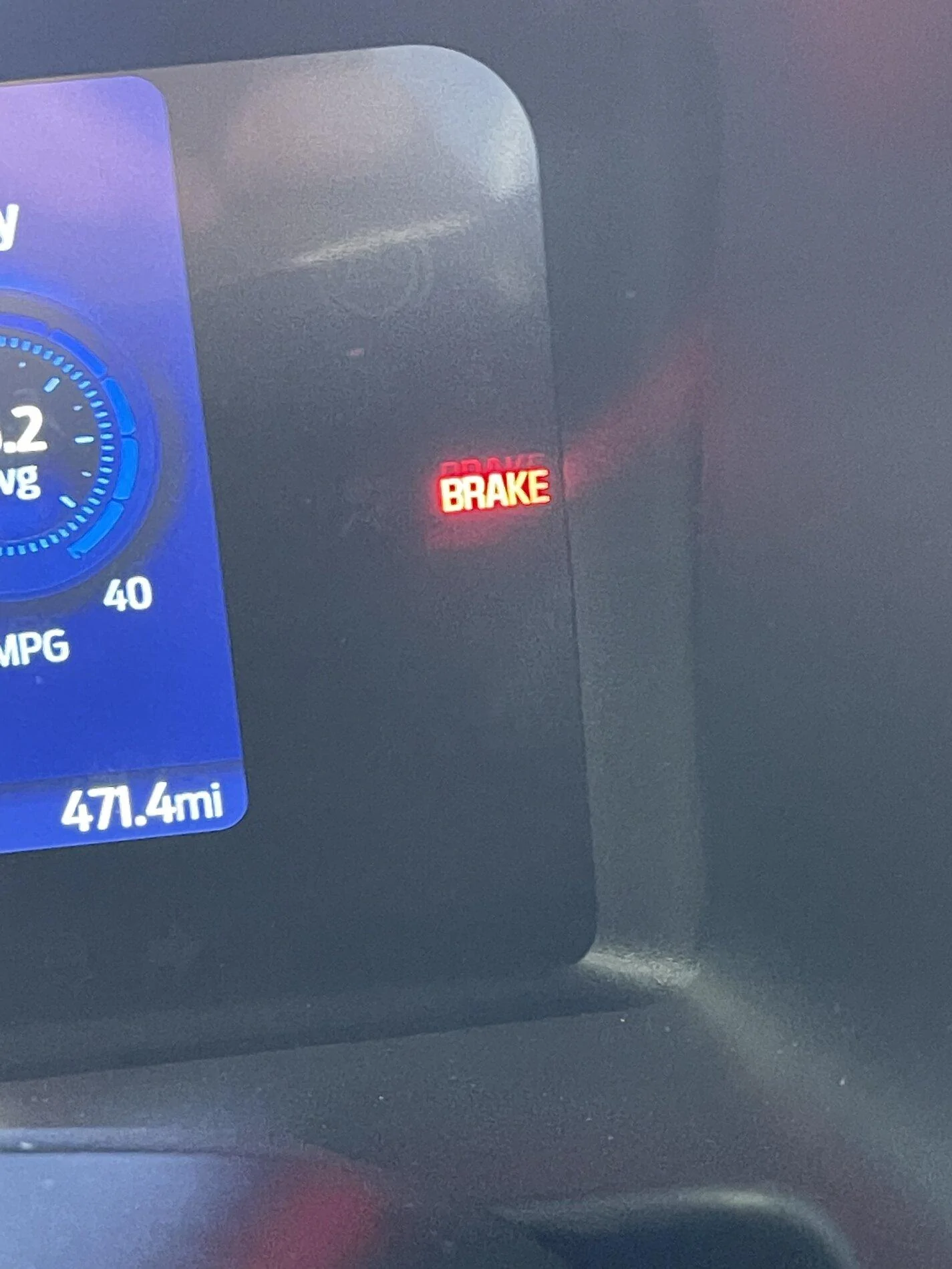

Anybody else having this issue? It comes on when I put cruise control on. Emergency break stays on and Check Brake System pops up. I took it in once already.

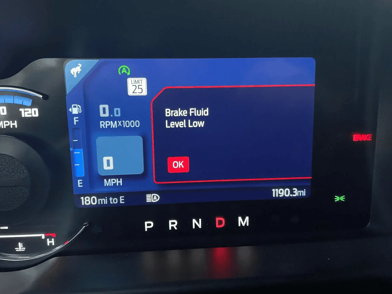

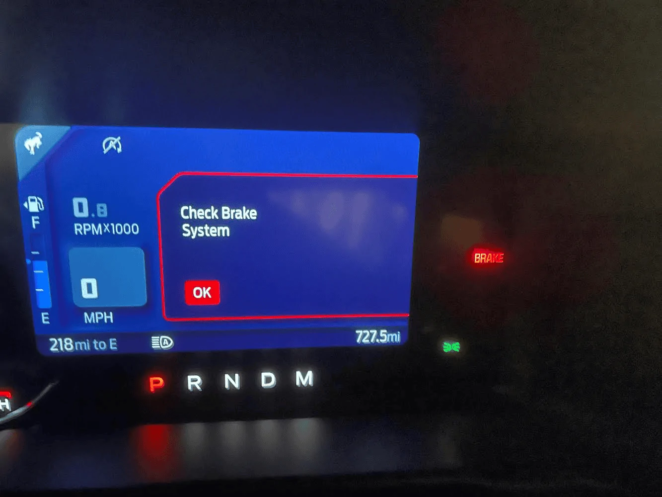

I’m also getting check brake system warning lights and also the brake fluid level low warning each time when I start my Bronco. It clears after a few minutes and then pops up multiple times during the drive. But this happens every time I drive my Bronco. I’ve taken it to the dealership and they checked everything but there were no codes to clear and I had brake fluid. Hearing others on this forum experience a loss of brake ability when this warning pops up is concerning to say the least.
