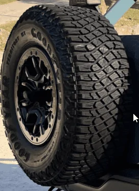

I test drove a dealer demo Wildtrak and noticed the same feeling under hard braking. That feeling is from the soft tread compound in the tires, and the fact the tread lugs aren't intertwined like some all-terrains. I noticed that you can 'feel' a lot more of the road as you are driving with the softer tires as well. One reason I was looking into moving up a load range size when I get mine, even though it will lose a little bit of ride quality.
Notice the tread gaps, there isn't much for stability in any direction for the lugs.
Ford Bronco Brake Slam lug1
