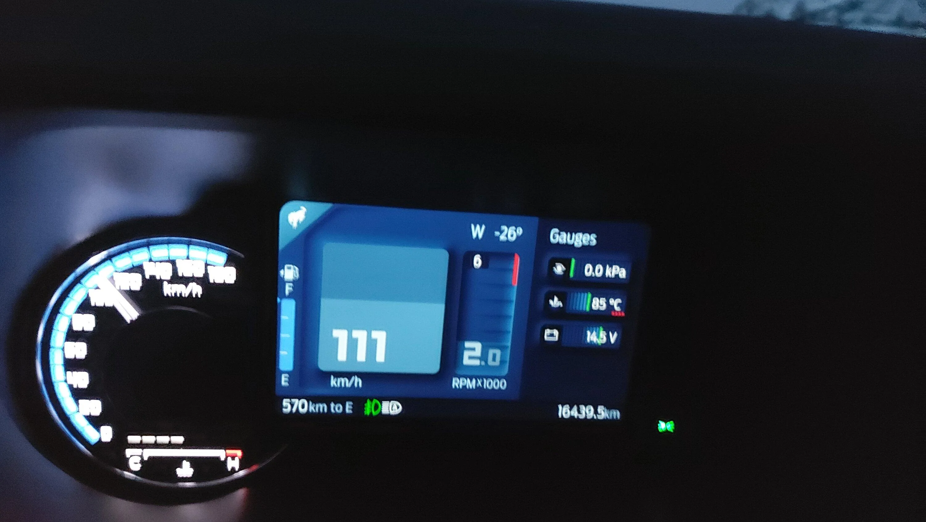

But... this when I was in Alaska, and we're talking real cold... like... -20°C. I know it gets cold in BC, but usually not that cold.
For context, still doesn't inspire a lot of confidence... I live in Victoria so cold is -5 degrees C...
This was my commute into Kamloops this morning. We get upwards of a week in the -20s once or maybe twice a winter down here. I hear it was still only -2 in Victoria though!
