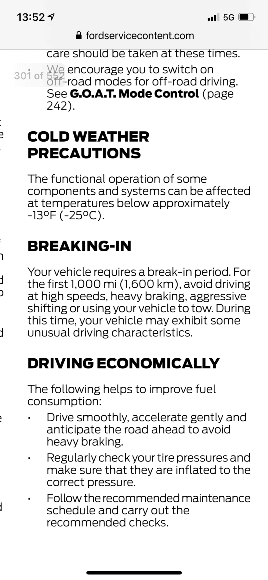

Directly from the manual.
MorgansRun
Mar 16, 2021
34
866
2,228
Virginia Beach, VA
BMW 330e
the easiest break in period you'll ever have is on a leased vehicle. You drive it gingerly until you're out of sight of the dealership you bought it from then start doing neutral bombs. At least that's how I think the guy who leased my last car drove it.
The BMW break-in period on a lease ends after you start up the engine.
Merc4x4
steve
Jul 8, 2020
2,065
3,993
NJ
Ford Bronco Break-in, recommended first steps D208ABCC-CA3B-43E5-8EF0-E7DA4B11E2EE
avoid driving at high speeds:
pretty sure there is a limiter ~100mph, so no chance of driving at high speeds.
I don't know how people turn those 2 sentences into 'babying' the engine and not exceeding some arbitrary RPM that is not manufacturers redline. 🤷‍♂️
