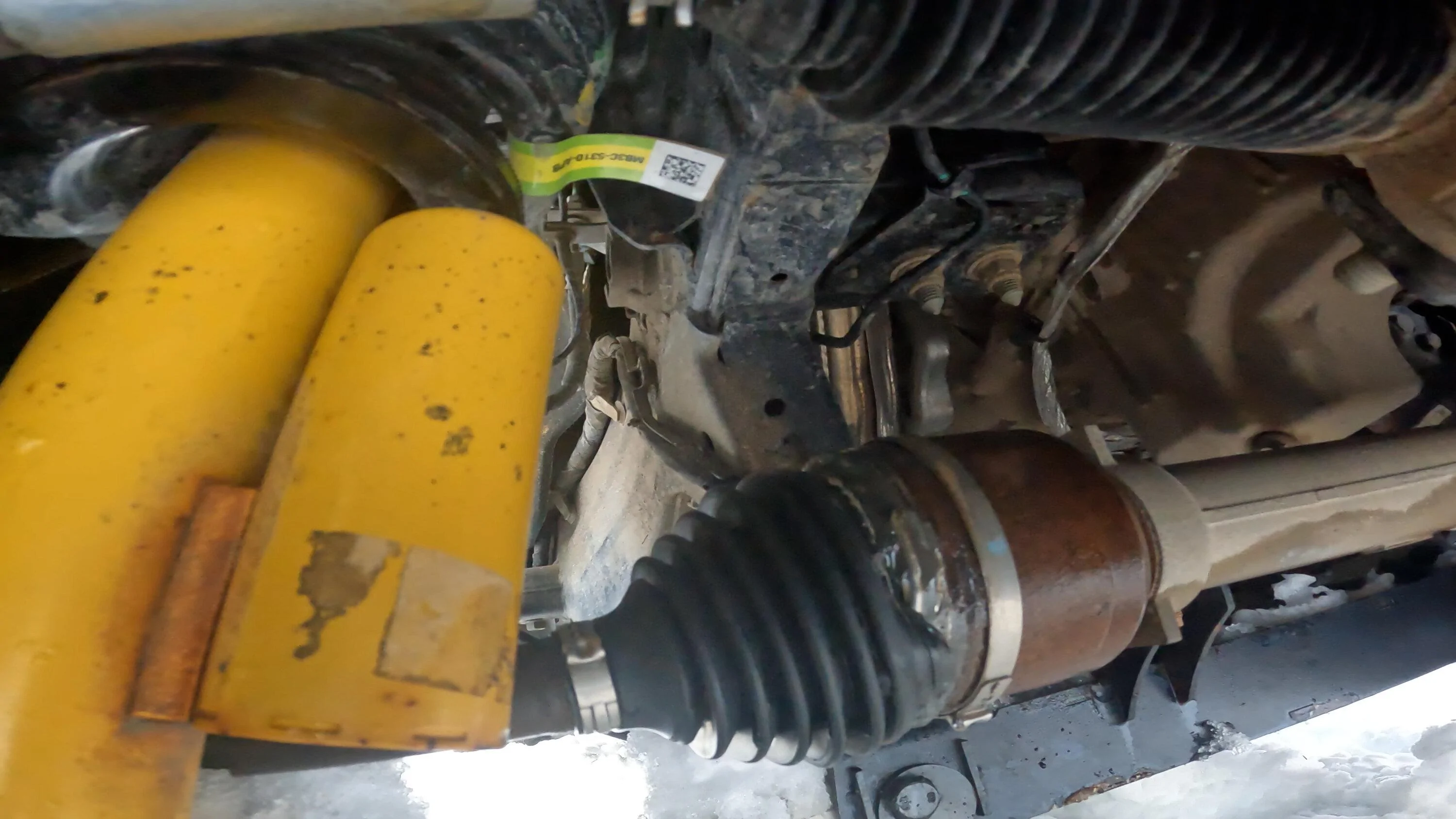

It seems normal enough. You did lift it and add 37s. As soon as that sucker goes into full droop and you turn the wheel at all and give it gas it's gonna blow. I'm surprised that more of them haven't been breaking.

Is the damage limited to the CV shaft, or is there also damage to the axle housing or diff? If just the shaft, an easy fix, although not cheap.
Didn't take it apart yet but it feels like just the shaft. I'll update when I get the chance to take it out.

Glad to see you do the ratchet strap trick to re-bead a tire. The more Broncos that get wheeled the more people will learn. Wheeling with the front locker engaged is a bad idea, it should be used as little as possible. Interesting to see why others think the front axle broke. The simple fact is the tire grabbed and all the power went through one part. If the front was unlocked the other side would have spun unloading the force.
People need to look past the tire size and lift for this failure. If you think your not at risk because of smaller tires and less lift your in the same boat just not there time wise. Big tires just speed up the process but we all will end up in the same spot eventually.
