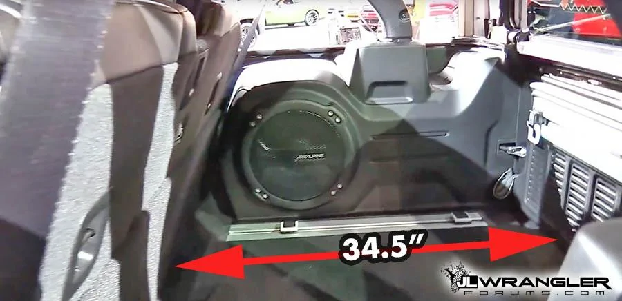

Does anyone know the dimensions of the rear cargo area on the Bronco 4-door, I checked the website and I couldn't see it.
I included the Jeep JK space for reference.

Approximations based on 20" 2-door measurement:
2-Door
50 x 40 x 20 = 40,000 cubic inches or 23.15 cubic feet. Ford says it has 23.6
48 x 42.5 x 20 = 40,800 cubic inches or 23.611 cubic feet
4-Door (by using above numbers)
50 x 40 x 31.5 = 61,000 cubic inches or 35.30 cubic feet. Ford says 35.6
48 x 42.5 x 30 = 61,200 cubic inches or 35.41 cubic feet
2 door hip room is the tell tale for width of cargo. I backed into 44/45” width x 33” for 4 dr
2 door is 20.5” to protruding seat mechanism (22” to back it seat) so that checks out at 33” deep.
Still shallow nonetheless. It’s honestly a foot shorter than a well packaged midsized unibody. But a good tall squared off box.

In my head the 4 door is longer only in the cargo area. We know the 2 door in NYC was 20” so im guessing about 33-35” is about right.
I can definitely live with 33" - 35". I currently have approximately 34 in my Rubicon. On a two week beach run I can stack the heck out of my Rubicon cargo area with luggage for two adults and two teenagers. And thats with my wife over packing, lol.
